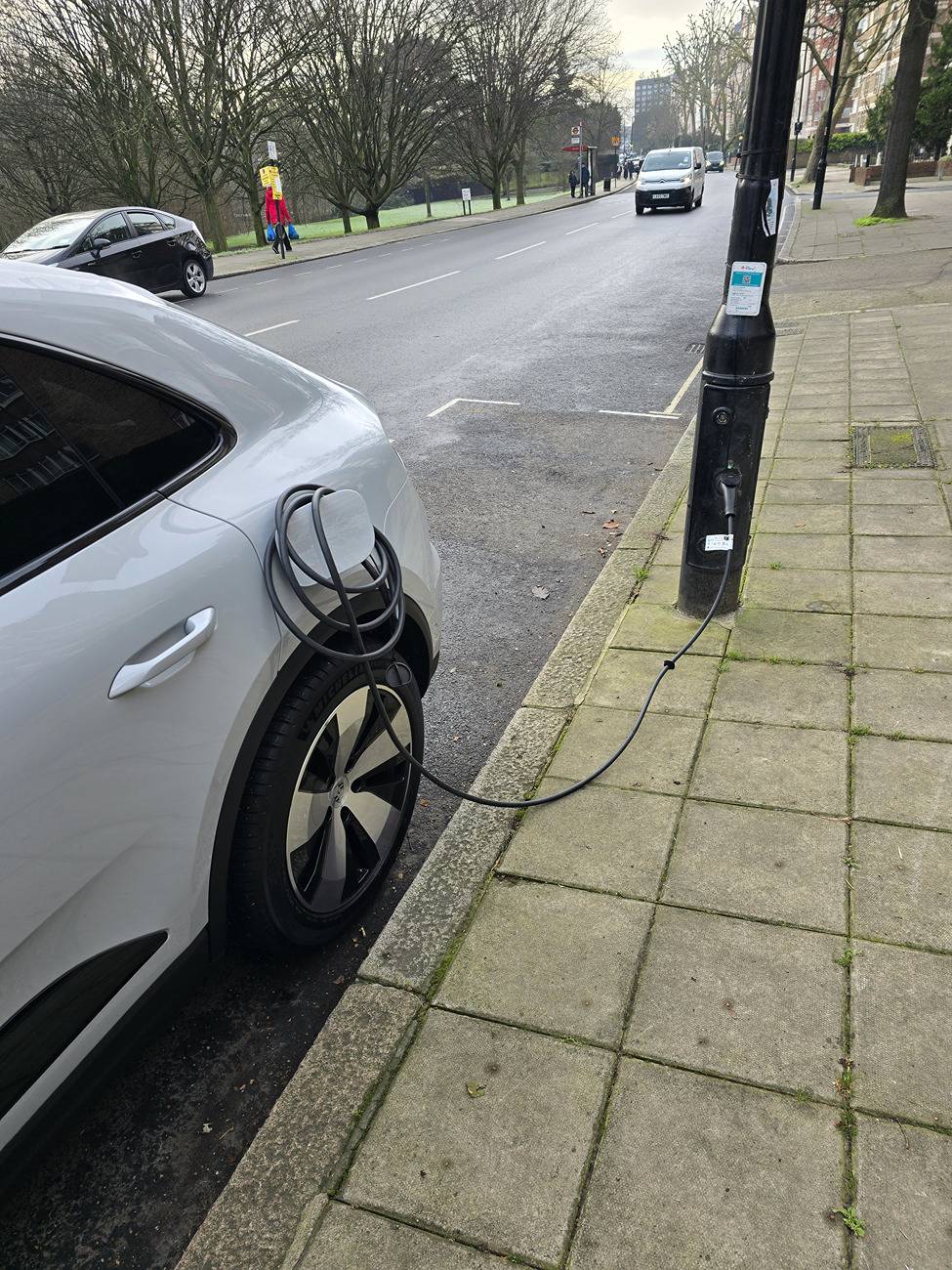

Another benefit of manual Charge Port Door… :)
While charging at public AC chargers, you can tuck your charge lead on the port door, so it doesn’t touch the muddy wet road. For those like me who cannot charge at home, living in apartments.
