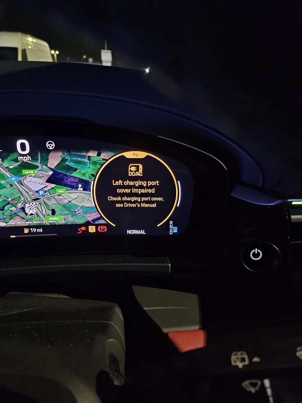

soooooo a couple days ago, my AC port would not open... I kept locking and unlocking the car...no go. I went over and opened the DC side, and then closed that....Went back to the AC side, and then it opened.
Hope that helps you guys if you have issues opening the ports again.
I had only charged like 20% on AC...and then accidentally only went to 50% on DC later that day.
The next day when i went to leave, I got the following error.
Electric Macan EV Electric Charge Ports Won’t Open 1762736564481-oa
Drove as usual...park the car and did what i needed to do. Of course, there was no error when i came back. I haven't attempted to AC charge since then, but we'll see.
