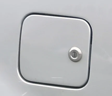

To the other members who have had this issue in the past: Was there a definitive fix, and if so, what exact fix did they apply (hardware, software, or both)?
Hardware, no problems since :CWL: :
Electric Macan EV Electric Charge Ports Won’t Open Screenshot 2025-09-10 185402
Joking aside (that was what I had on my first car; no central locking) I find it strange that Porsche has not included a manual override for the charge doors like you get on the normal doors, my Audi has a plastic cord you can pull from inside the boot in an emergency and fuel the car. On some cheaper VWs this cord was missing (in theory you could remove the wheel arch and push the button on the actuator to open it (this is where the cord goes; the part is the same.
