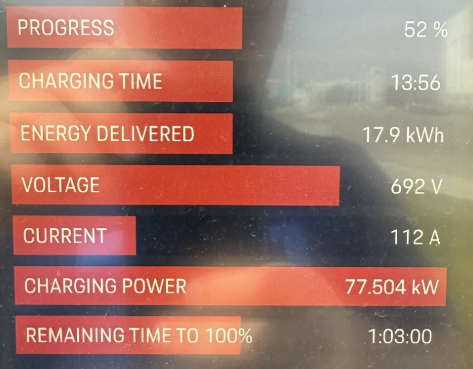

I am working through two issues now after the SQ5 update, neither of which I am 100% convinced are the update specific issues.
1) The range estimates are all wrong, and underestimate (trip says it will consume 10% of SoC, but it will use 14%, but it never updates the estimated SoC on trip completion, so you end up with something like 50% SoC left at Destination, but your still 5 or 10km away and the SoC is already lower than end projected on arrival. And it doesn't adjust like it use for me while you drive)
2) I am having a hard time at the DC fast Charger (Electrify Canada). I am plugging in and getting 80kw rate of charge, and after 5 min it drops to 40kw. However, this charger station has 4 units, one of a 350, and that one doesn't work on my car at all anymore, but I see about 80% of people trying it doesn't work for them either. The whole station seems to have super flaky chargers that started about when I got the update, so I am not sure it's a car/software issue with all the other people having issues at this station. The nest closest 350kw charger for me (electrify Canada) is 200km away - There is a few Tesla chargers, but not sure if that would help figure this out and I have never used them before.

Regarding the first problem (range estimate), see if the same problem occurs when using the Guest profile. My guess is that it's specific to your driver profile and that the car just needs to re-learn how your driving habits affect range.
The estimates have tightened up the last 24 hours. But I decided to run the battery down to 4%, wait a little over an hour, charge to 100%, wait a little over an hour and see if that helps. But it has improved.
However, the DC charger still needs exploring, I tried this morning, but the only working one was busy, and the rest all had some sort of error and would not connect to the car.
Hopefully in the next 48 hours, the situation becomes clear as that's going on with both.

Flying4Fun
Nov 22, 2025
230
163
@BCCanuck I dropped by the dealer yesterday, and used their charger, which I guess topped out at 80kw (it seems to be a 290v system) - the service tech had told me it was a 690kw charger. However, it started and continued at 80kw charging and didn't drop like the EC chargers did.
The next nearest EC chargers (only one in my city) is about a 1.5-hour drive away (I found one slightly closer than I thought vs the 2hr one). However, I am reluctant to drive to it to test, in case there is an actual issue with the car, I could get into some range trouble if not careful.
I will probably head out there anyway on the weekend and see what happens - but if it only charges at 40kw There are going to be a few upset people with me at that charger :-(
From the Porsche Dealers Charger:
