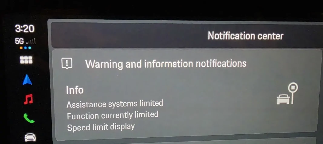

Anyone else experience this error on their Macan? This basically disables "Assisted Lane Change" and "Trained Parking" as far as I know, Drive Assist still works.
Service department said the solenoid for the charger port went bad and triggered this error. They didn't have the part in stock so I got the car back while I wait until they get it.
When I got the car back there error is now gone and been good for a week so far.
Is this just buggy software, or could it actually be a real issue?

This has been reported on elsewhere in the forum for all MY. Buggy software. Also GPS eventually shows an offset following these errors. Sometimes resets itself with a matter of days. No known cause as yet. I seriously doubt its root cause is related to a bad charger port solenoid.

This happens about once per week on my ‘24 Cayenne S E Hybrid. Goes away the next time the car is turned on. Just appears to be something not responding quickly enough for the initial check of all systems, not an error per se, just modern vehicles doing what they do (happened on my BMW often too, so not just a Porsche issue).

I get that like every morning for about 3 min. with Lange departure and others.

Had the same issue yesterday. Hard reboot of the Infotainment /Navigation (Google Maps) system fixed the issue - at least for now. They better fix this soon, since Navigation (Google Maps) is the only mapping system that shows charging stations along a route...
