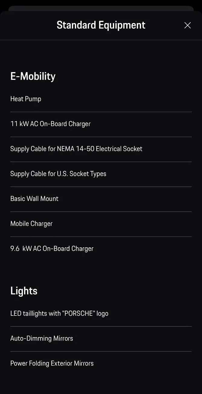

[Poll] - Porsche charging specification lie? Macan is not allowing 11 kW max charge rate - capped at 40 amps? 9.6 kW max rate.
Can you get your Macan to charge at more than 9.6 kW from an AC EVSE?

No lie! "11 KW on board charger" is true. The charger is on board. It is up to the owner to provide the energy suitable for the charger.

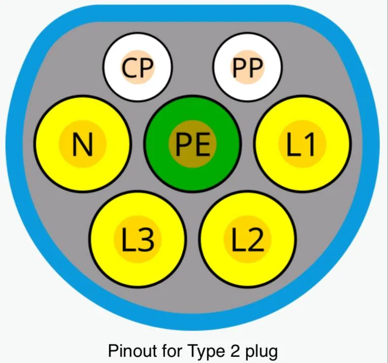

Keep in mind that you need three phase power and a compatible EVSE to get more than so called 9.6 indicated anywhere in the world as far as I know (there are areas where 3 phase is common, others like the US where not). Smart 220v single phase EVSEs seem to only provide 9 to 9.6 as indicated by the Macan depending on battery temperature and condition. Some not so smart supply 9.9 - 10.1 as indicated on the Macan dash.

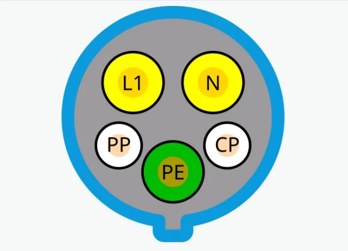

to support 3 phase AC charging in North America there would have to be a EV charging port connector that has the necessary physical connectors inside the plug - the current NACS/J-1772 physical connectors do not have (and do not support) 3 phase power - they lack the necessary physically separate connections inside the plug's physical design. The J-1772/NACS physical plug design has 5 separate electrical connectors/conductors inside inside the plug:
  1. L1 - 120V
  2. L2/N - 120V or Neutral for 120V/L1 charging
  3. Electrical Ground
  4. PP - low voltage communications - safety monitoring
  5. CP - low voltage communications - safety monitoring
https://en.wikipedia.org/wiki/SAE_J1772
Electric Macan EV [Poll] - Porsche charging specification lie?  Macan is not allowing 11 kW max charge rate - capped at 40 amps? 9.6 kW max rate. IMG_2548
NACS has the same 5 connectors/pins and uses them for the exact same purpose - just a different shaped connector, but electrically identical.
of note for the J-1772/NACS/J-3400 standard is the followring range of charging speeds as quoted from the standard - 1.44 kW to 19.2 kW is the range of power covered by the J-1772/NACS/J-3400 AC charging standard…
The J1772 5-pin standard supports a wide range of single-phase (1φ) alternating current (AC) charging rates. They range from portable devices that can connect to a household NEMA 5-15 outlet that can deliver 1.44 kW (12 A @ 120 V) to hardwired equipment that can deliver up to 19.2 kW (80 A @ 240 V)
3 phase power would require an L3 or 6th connector that is missing from the J-1772/NACS design…
there is no such thing as a 3 phase EVSE or EV in North America - there is no charging standard that supports 3 phase power in North American - so there are no 3-phase EVSE's and there are no 3 phase EV's.
european EV conenctor type 2 supports 3 phase AC power and upto 22 kW of power…but has quite a few more physical connectors inside the plug to offer this support - NOTE: the dedicated neutral and L3 connector pins which are missing from the SAE J-1772/NACS/J-3400 North American design - these additional pins would be physically required for a North American EV/EVSE to offer 3-phase AC power charging.
https://en.wikipedia.org/wiki/Type_2_connector

some at Porsche screwed up and loaded the setting for North American Macan's and set it to 9.6 KW - because they are confused. and it's our own fault for having a confusing standard.
but to be clear Prosche is also confused - they list the following:
  • Taycan Gen1 - 9.6 kW max charge rate standard - factually 11 kW was supported and always has been
  • Taycan Gen2 - 11 kW on board charger
    • mobile charger listed as 9.6 kW maximum
  • Cayenne Hybrid
    • onboard charger 11 kW - correct - and it actually supports 11 kW
    • included mobile charger 11 kW - incorrect - factually impossible, 9.6 is even stamped on the unit's specification sticker
  • Panamera Hybrid
    • onboard charger listed 9.6 kw - incorrrect - actually 11 kW same as Cayenne
    • included mobile charger 11 kW - incorrect - factually impossible - 9.6 kW is what it provides like Cayenne
  • Macan EV
    • onboard charger 11 kW - correct? - appears to be limited to 9.6 kW
    • included mobile charger 9.6 kW - correct
of the 5 EV products porsche is shipping - even they don't know what they can do, and the published specs are often wrong and have been years - i've even tried to send them corrections with data proving my assertions and they have failed to update the published specs.
