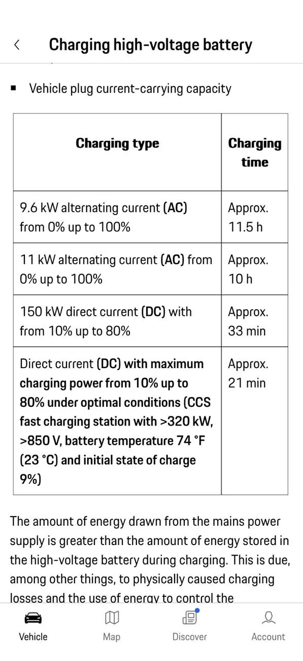

owners's manual in my app lists 11 kW charge rate times - I plan to engage my dealer service in the new year to follow up on this…between the 11 kW listed in standard equipment in the configurator and the refers in the owner's manual - I think this is a configuration mistake with North American regional settings that can be rectified with coding/software changes…but we'll have to see how this plays out…
screen shot below from the in-app digital owner's manual.
Notified dealer on Porsche survey about this issue. Not a peep.

I don't know if you folks noticed, but on this thread the posted Audi SQ6 sticker states 9.6kW onboard charger. So I'm not sure what that says about our Macans.

yes I found that very interesting…

Now that I've arrived home I've been able to accomplish some charging with my home residential charging system.
I can report the following:
  • so far the Macan EV works just fine with the Tesla Universal Wall charger(s) I having installed sharing a 100/80 amp dedicated charging circuit
    • last night my Cayenne eHybird and Macan charged no problem!
  • the 11 kW EVSE I have yields a 9.3/9.4 kW reading inside teh Macan EV - this would indicate a charging overhead of 1.6 kW - this is much much much high than my 2020 Taycan Turbo on the same charger and same circuit - this will require more investigation - but that is what I'm seeing
    • my 2020 Taycan Turbo would report 10.4 kW inside the vehicle when charging from 11 kW EVSE - a more reasonable 0.6 kW of overhead/loss
  • when charging with 40 amps (9.6 kw) the Macan EV reports 8.3 kW inside the vehicle - still a 1.3 kW "overhead" as reported - again not sure if this is accurate, more investigation is required - I'll try and get to the bottom of the issue.
the Macan's charging configuration User Interface is much much simpler and easier, and more easily understood in my opinoin - it's a big improvement vs. the Taycan charging user interface
however, you still can not achieve the very simple: start charging at this specified time - Porsche is still "all in" on departure time scheduling - which requires some mental gymnastics to work out if you want to push the charing schedule into a time-of-use off-peak rates schedule.
also I plugged in after returning from my cross-country trip - and was below 25% - and it immediately started charging - even though my depature schedule was over 12 hours away and my allowed time of use for optimizdd charging was midnight-15:00 - reading the manual confirmed there is a 'fixed' charging behavior to always charge to 25% if you plug the vehicle in. I confirmed this was happening, and the charging stopped at 25% - and then waited to finish charging to 80% based on my charging schedule.
this is an unfortunate behavior and there is no way that I can find to disable it - or adjust the 25% threshold - grrr grrr grrr…
this will go "on my list" of things I request Porsche to update/fix - there must be some way to have the vehicle plugged in and yet not charge outside the window for optimized charging.
that's all - I'm sure I'll learn more in the future.
UPDATE: my 2024 Macan Turbo EV appear to only support a maximum charge rate of 9.6 kW - this differs from the onboard charger specification from the Porsche USA website and standard equipment list for the Macan EV - I have an eMail out to my dealer/service-manage asking for clarification - we'll see what they say in response.
