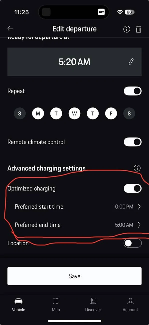

I also have the Tesla Universal. The Macan in the US market has an AC max of 9.6 kW, which surprised me. I think the European version has 11 kW. My Tesla Universal is connected to a 60A dedicated circuit, and I can get a maximum of 9.2-9.3 kW on my Macan, which is more than enough for me. I usually keep the charge at 60% throughout the week, and by the end of the day, I should still have 48%-50% of the battery.
During the week, I use the departure with the “Optimized charging” option set between 10 PM and 5 AM. I’ve never noticed the car charging outside of this window.

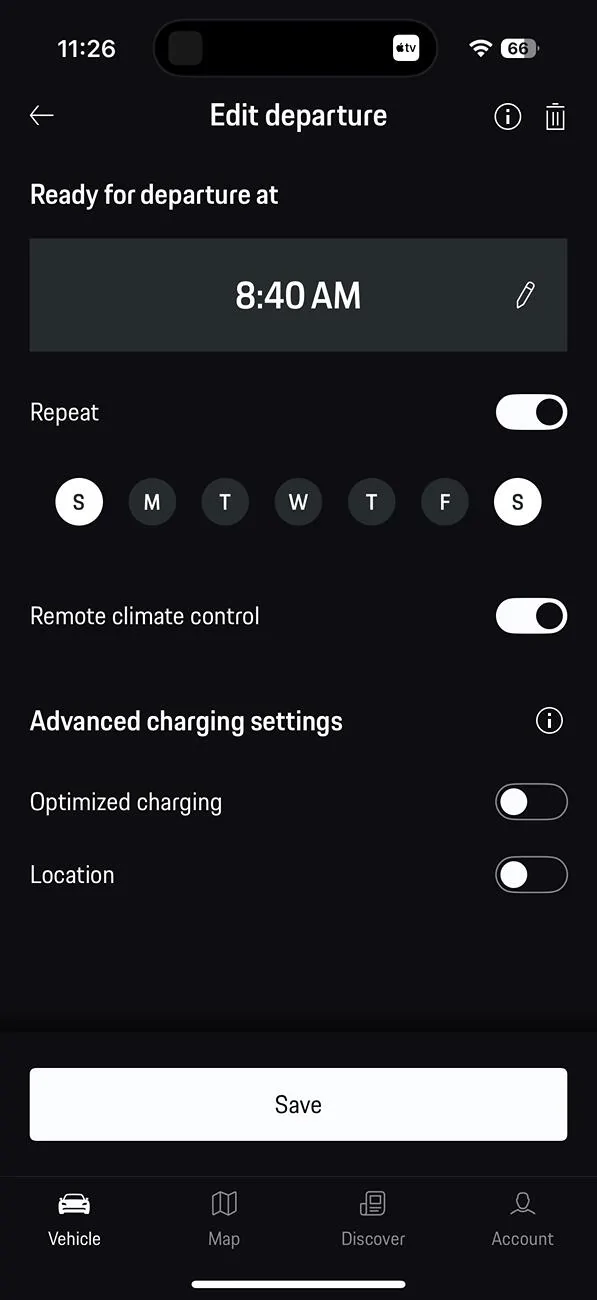

On the weekends, I have another departure without the “Optimized charging” enabled. The car charges based on the departure time or if the battery drops below 25%.
Here are my configurations.

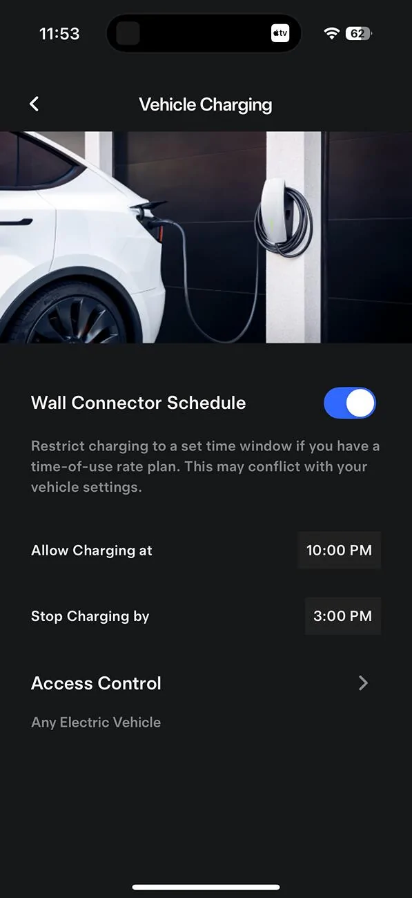

Related to this, does the Tesla UWC not support scheduled charging for non-Teslas? (I don't have one, but am considering it)
It does have the feature, but the only thing is that you can only set one schedule for all days of the week.
Oh, well that's unfortunate. I'll need to decide if I'm willing to live with that limitation.
It would be nice if they let you define arbitrary time windows per day, and in each time window set the priority order of the following:

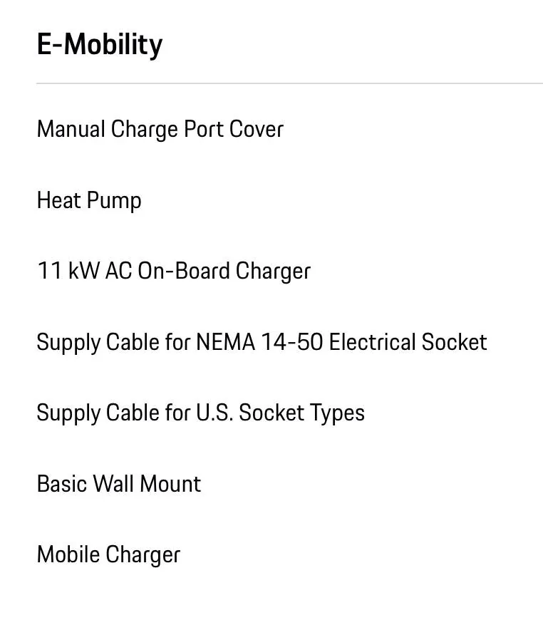

my eMail to my local Porsche dealer/service manager - I don't expect a "quick" answer - but I do expect an answer eventually:
Team,
The porscheusa.com website listed the Macan’s onboard charger as 11 kW…specific question is at the bottom - the rest is “background” and setup…
This is the same as the European Macan and the same as my 2020 Taycan Turbo had installed.

The 9.6 kW maximum charge rate is a surprise because:
  • This differs from the stated standard equipment list for the North America website

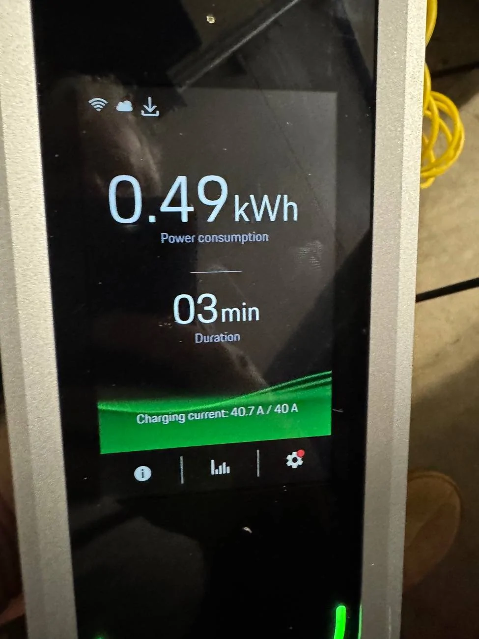

it does appear the Macan EV reports the "raw" charge rate vs. the "effective" charge rate…like my Taycan used to do…so this is a charge in software behavior vs. Taycan…
I adjust the PMCC unit amp's down - and could see the exact change on the Macan's screen with the kW rating exactly matching the AMP's from the PMCC unit
Fun fun fun - when charging the Macan my PMCC unit reports 40.7 amp of a 40 amp maximum - my 2020 Taycan used to report 39.6 amps of a 40 amp maximum during charging…ROFL
pic below is my Macan charging from my PMCC unit provided w/2021 Cayenne TurboS eHybrid - note the amps is more than capacity - hmmmm…
