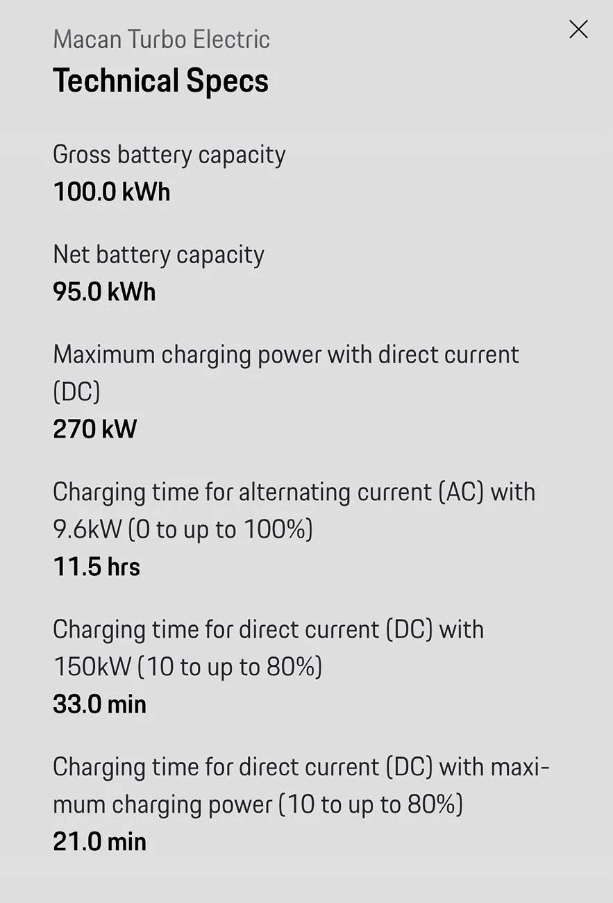

I wonder whether it’s a problem with having the right owner’s manual for the region rather than a misrepresentation. When looking at the Technical Specs for the US and the ones listed on the Macan I ordered,
Electric Macan EV [Poll] - Porsche charging specification lie?  Macan is not allowing 11 kW max charge rate - capped at 40 amps? 9.6 kW max rate. IMG_6544
it only states: “Charging time for alternating current (AC) with 9.6kW (0 to up to 100%) 11.5 hrs”. Maybe their mistake was not clarifying this issue and so people have assumed that 11kW was possible?

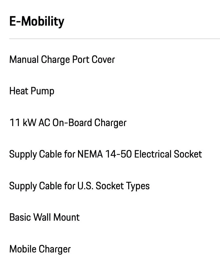

there are two specffication the one you're quoting and the "standard equipment" link in the configurator…
here is the current "specs" from the "build your porsche" - standard equipment link on https://configurator.porsche.com/en-US/model/XABAA1/standard-equipment - this link and screen shot below is as of date/time of this posting!!
And the Owner's Manual I referenced was loaded for my car, on my app, in the U.S. I re-downloaded the owner's manual on a different device today and it says the same thing--including 11 kW in the charging chart. Note it doesn't ask which manual you want--it appears to download automatically. Now the manual in places implies it covers multiple countries, but there's no such proviso in the charging chart (the typical remark in the manual is something like "depending on the country," and that qualification is absent in the charging table.) In any case, if anyone outside North America reports a higher rate than 9.6 kW, then that will tell us something at least.

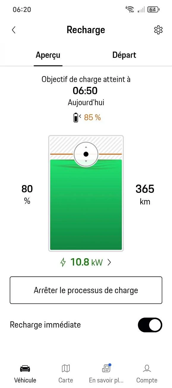

Hi, I can see here in France 11kw in my home.
thank you thank you thank you!!! this is extremely useful!!! it proves the that some Macan 's can exceeed 9.5 kW!!
also it indicates the Macan reports close to "raw" input power - not the charge rate after losses (like the Taycan).
sooo useful - thank you for taking the time.
