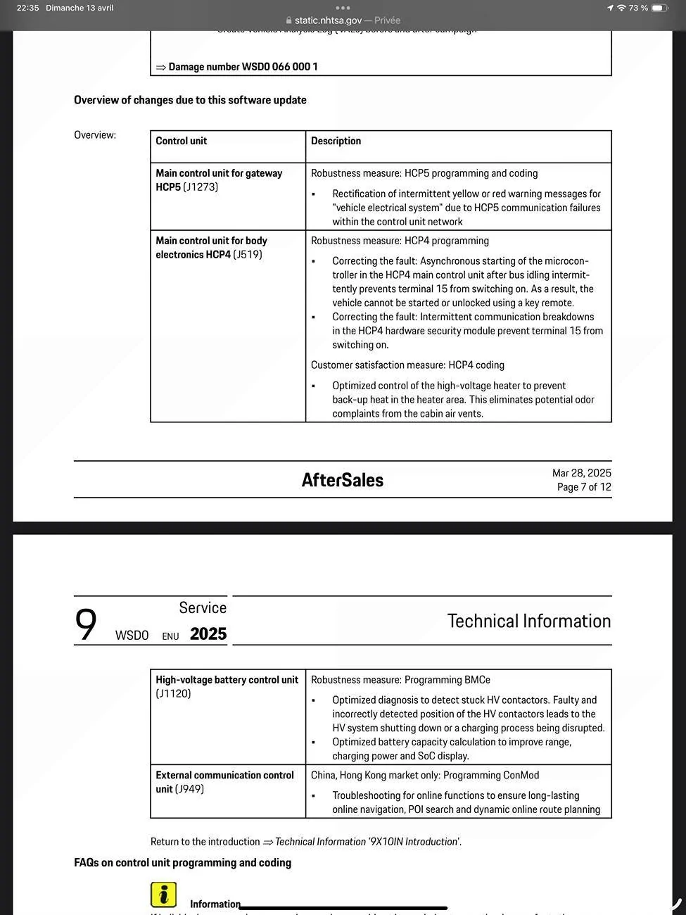

At least, there are ways to find the changelogs: hopefully the nhtsa will survive …
