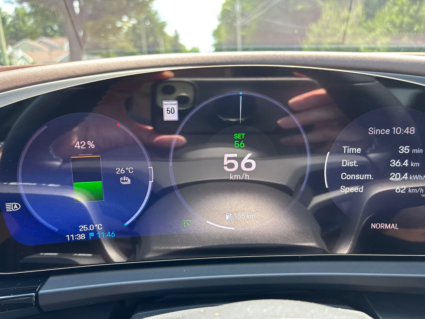

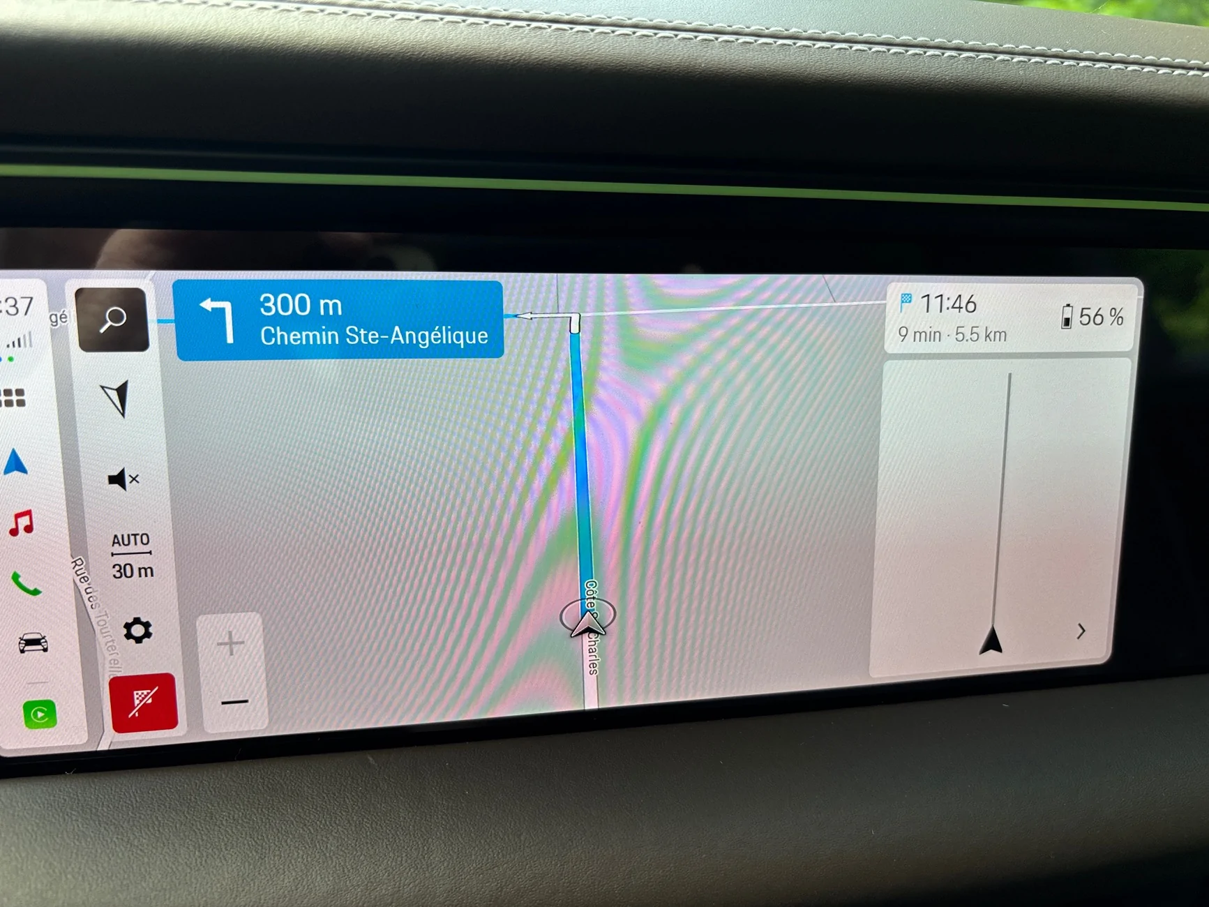

The route monitor shows a battery remaining of 56% at destination but my actual battery level is 42%.
What exactly is the route monitor battery % reflecting?
Anyone with road trip experience and knowledge appreciated.

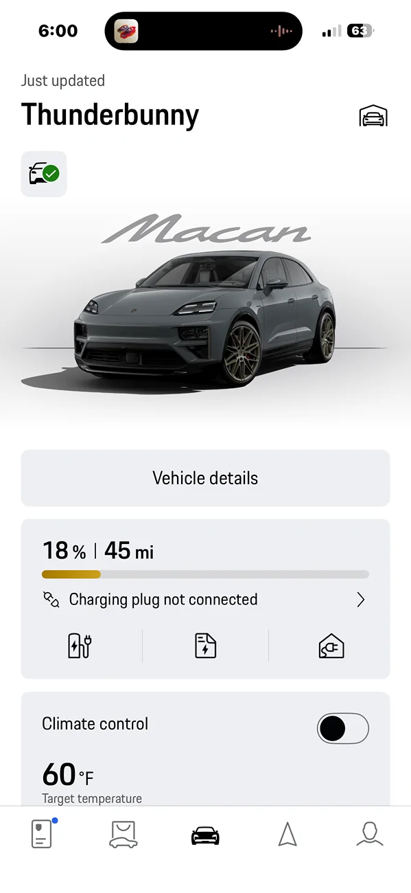

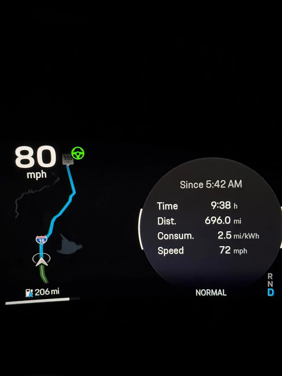

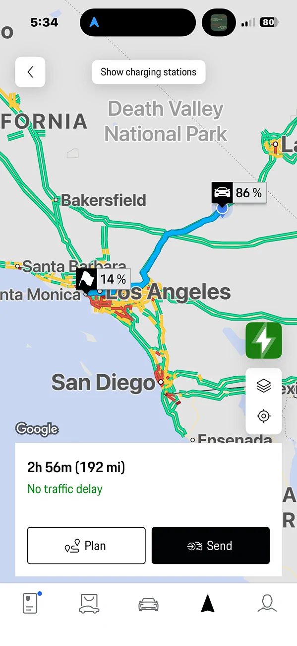

Here is an example from last year. According to the battery SoC I had a range of 206 miles available and my destination was 192 miles away.
Doable with the SoC but I would have arrived with an almost empty battery.
The navigation system told me I would arrive with 14% SoC. When I got to my destination I actually had 18% or 45 miles left. Why wasn’t the battery almost empty? Because there was a significant elevation drop from the start of the drive to the destination, something the navigation system took into account.

Also, the screenshots of my trip from Baker, California to Santa Monica, California demonstrate that elevation changes are taken into account as part of the planning. Going south from Baker you travel uphill for many miles, but overall you lose quite a bit of elevation on that trip, mostly in the Cajon Pass where you drop from almost 4200 feet down to 1400 feet. My final destination in Santa Monica is just above sea level.

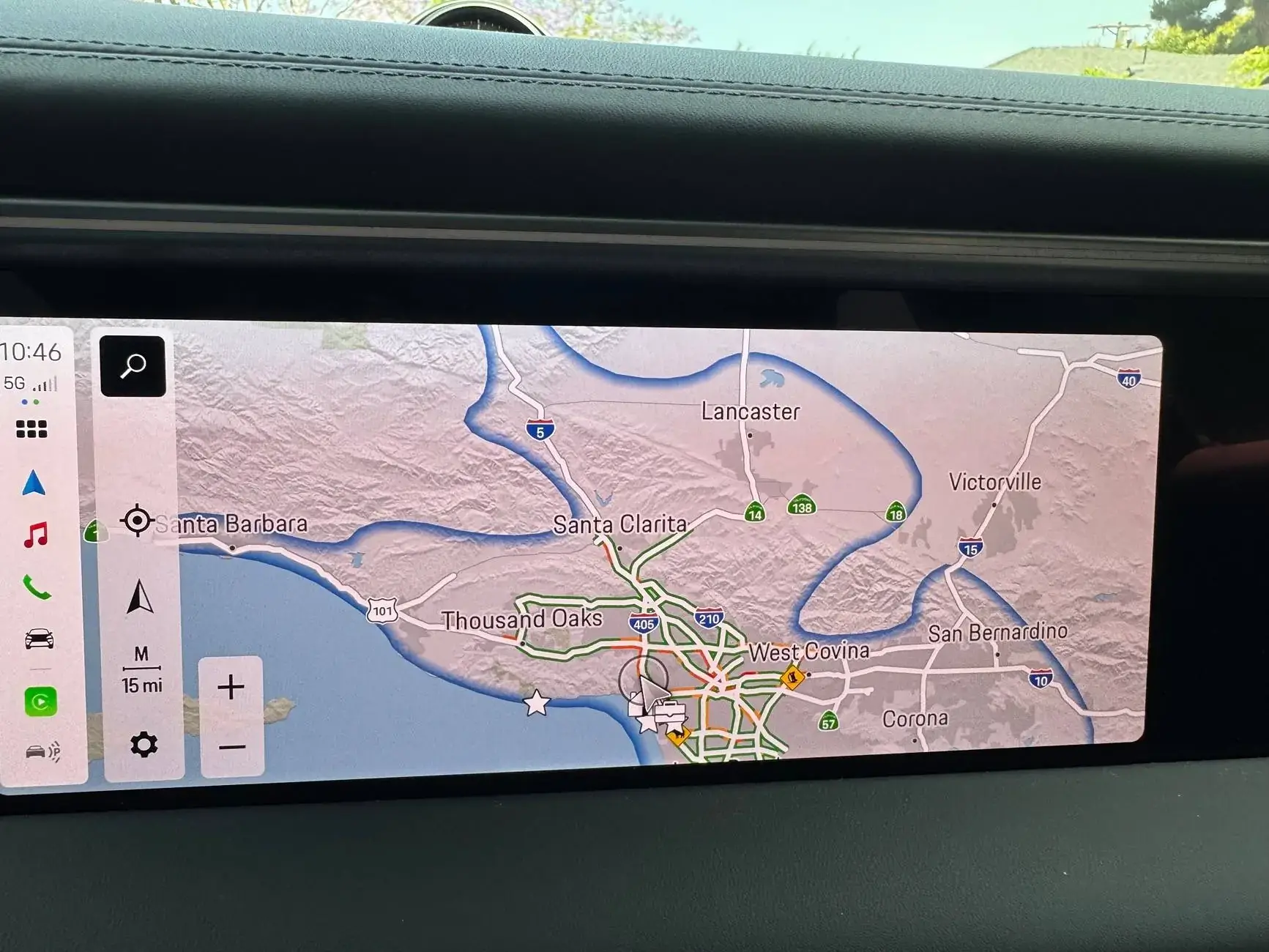

The range shown alongside the battery SoC only considers your recent consumption, whereas the route planner knows where you're going and can consider additional factors and therefore show a substantially different range.
Finally, the route planner can display a blue outline of the places that are reachable with the current SoC. As you can see below it's not a perfect circle for me -- that's because it considers traffic as well as elevation changes. I could drive along the coast with no elevation change and drive well past Santa Barbara, but if I wanted to drive I-15 to Las Vegas I would need to make the climb up the Cajon Pass where I would expend a lot more energy.

You're right about the blue outline but it takes into consideration where there are roads. You can't go where you can drive.
