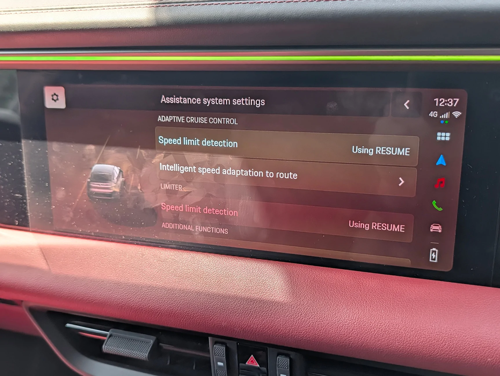

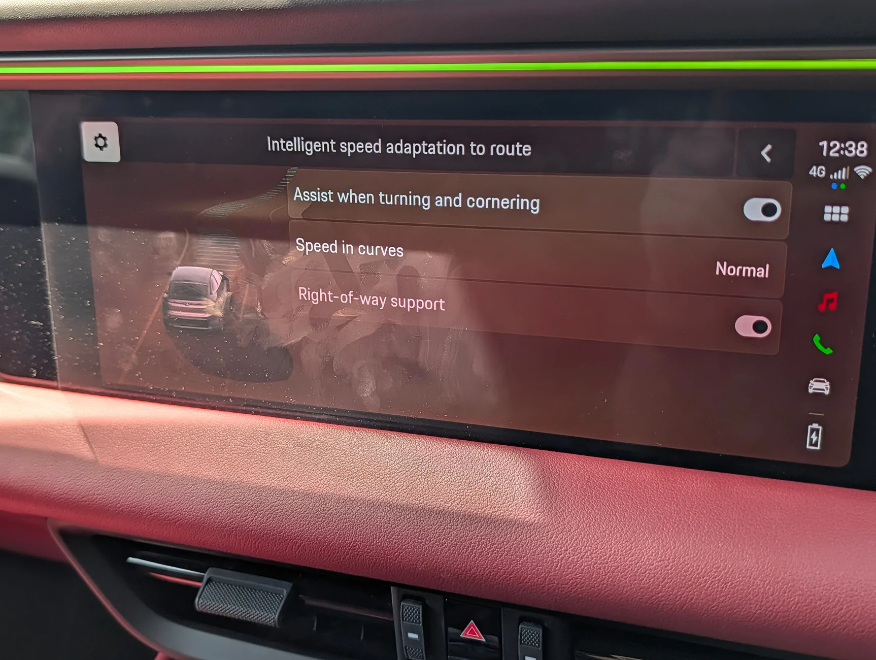

You can adjust both of those settings in the PCM: Drive screen (car logo)-> assistance -> assistance system settings (cog wheel):
How fast you want it to corner/approach to roundabouts here:
Electric Macan EV Navigation updates PXL_20260623_113827101
and whether to set the suggested new speed by pulling resume, doing it automatically or via the cruise stalk turned off altogether.
Electric Macan EV Navigation updates PXL_20260623_113733380
However both of these features I've turned off completely for now! until they can update it and make it reliable.

Thank you, sooo many options to discover 😁!
In our car, the default for limiter is 'auto' but cruise is 'pull resume' - or maybe the dealer pre-set those for 'safety!
