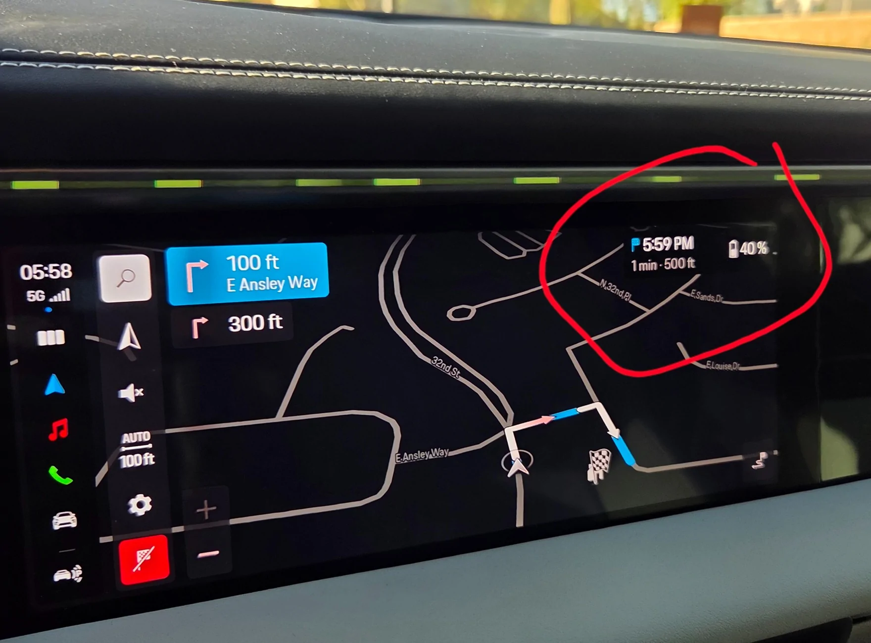

This is the nav screen and battery level I am referring to, that seems to be wildly inaccurate.

Mine is perfect (I was wondering about the other day). When it’s wrong I arrive at destination with +-1% but I only use on long trip (more than 150 km).
586
354
Mine is accurate. If you put a destination in the map of the app and send it to the car does it show the same % at the destination as your screen does when you get in the car.

It is probably a software bug. Mine is working as designed and I use it on long trips as well as on daily city routes. It is very accurate, showing traffic and AC/DC chargers. If it could show traffic/speed cameras (using waze or apple maps for this feature), it would just be perfect.

Mine did exactly this a few weeks ago.
Drove me daft and as I had some long journeys coming up where I wanted the route planning to work so I booked it into Porsche to be looked at. Note I did try PCM resets and leaving the car over night -all many times - to no avail.
Sadly on the day I took it in, the sat nav started behaving normally again so I had nothing to show the dealer. Dealer checked out the car for error messages - there were none but otherwise couldn't really do anything. They did claim they thought this was expected behavior - which is complete nonsense.
The good news I suppose is that after 10-12 days of craziness, it just started working correctly again and so maybe it will for you too.

Actually just reread your post and I think mine was even worse as it was reporting arriving with charge HIGHER than departure (and no, it wasn't planning in charging stops).
So I could set off on a 35 mile journey at 60% with the sat nav saying I would arrive at 75% but in reality I knew I would be arriving at around 48-49%.
As I said, it fixed itself after 10-12 days..

I use Porsche nav for long journey, because it’s reliable.
Porsche Nav displays the SoC that is the one you’ve configured at destination: if you want a 40% SoC at destination, Porsche nav will add a charge stop in order to reach the destination with this SoC.
it’s not a bug, it’s a feature that is quiet nice and reliable in my opinion.
