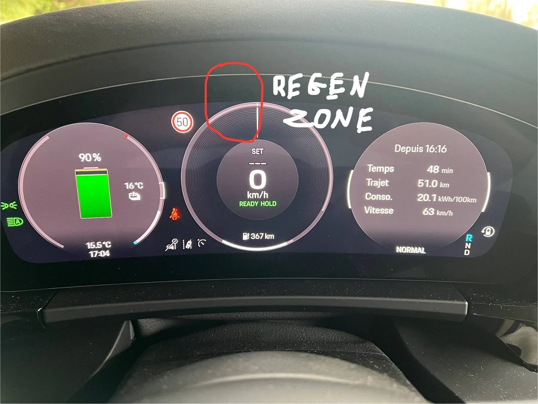

i think there is a misunderstanding about the indicators: the lite icon just shows if the regen is generally on or off. the actual regen is showed at the instrument cluster: there is a vertical line on the speedometer. if it moves to the left regen is on.

I have the indicator in the HUD, when coasting is off I always have immediate regen, if coasting is on, it’s not immediate (sometimes it is), so some of us wonder if that has an impact on efficiency / is it just a visual bug / …

Yves and I have this behavior with our Macans in ideal conditions for working regen:
mode regen on: we release the speed pedal, the regen indicator goes to the left in green and shows little to medium regen. Almost always.
mode coasting on: we release the speed pedal, we push a little the brakes pedal :
- the regen indicator goes to the left in green and shows little to hard (depending on the force applied on the pedal) regen. Sometimes.
or
- no green, no visible regen, the regen indicator stays in the center and so we assume it just uses the real brakes. Otherwise.
And you??
