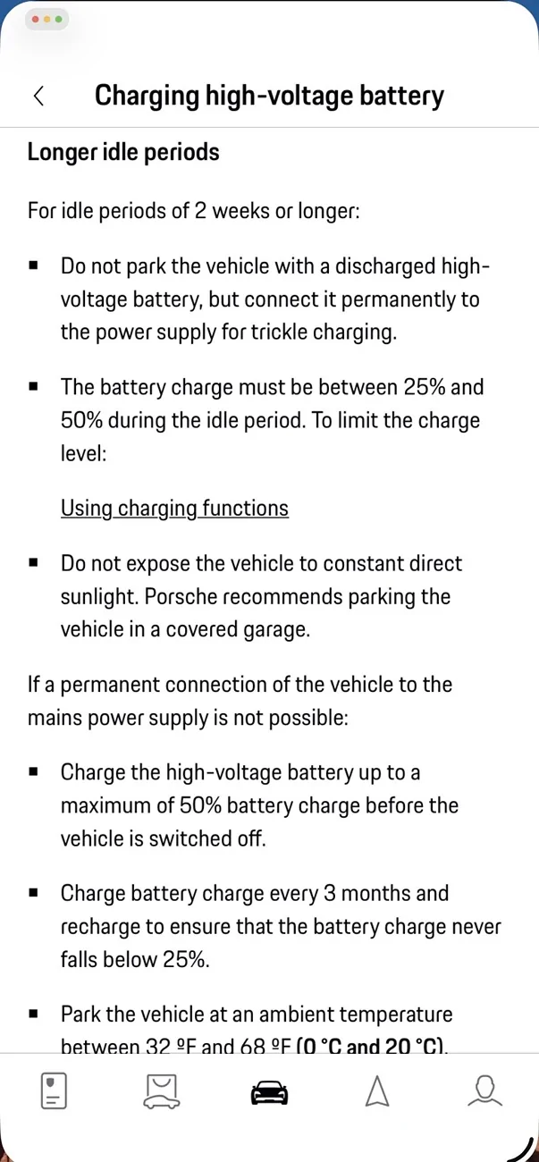

This is odd, one of Porches Spot On videos says to leave vehicle at 25-50% charge but do not plug in.
I have just had 6 years in an IPace & the instruction from JLR was to leave at about 50% so but do not leave on charge. It would be nice to know what the correct procedure is!

I posted what the manual says, but that doesn't mean it makes sense to me. For example, I am unaware that either HV or 12v battery "trickle charges" thru the AC port. Then there is the debate in the other thread about whether and under what conditions the car requests a top-off charge. A few months ago, there was a thread where the consensus was that it's best to leave the car plugged in, but I still think that was more educated guess than certainty. I believe different sources at Porsche were also inconsistent in their advice.
Edit: FWIW, I leave my Macan plugged in, but my reasoning is more along the lines of "it couldn't hurt."
