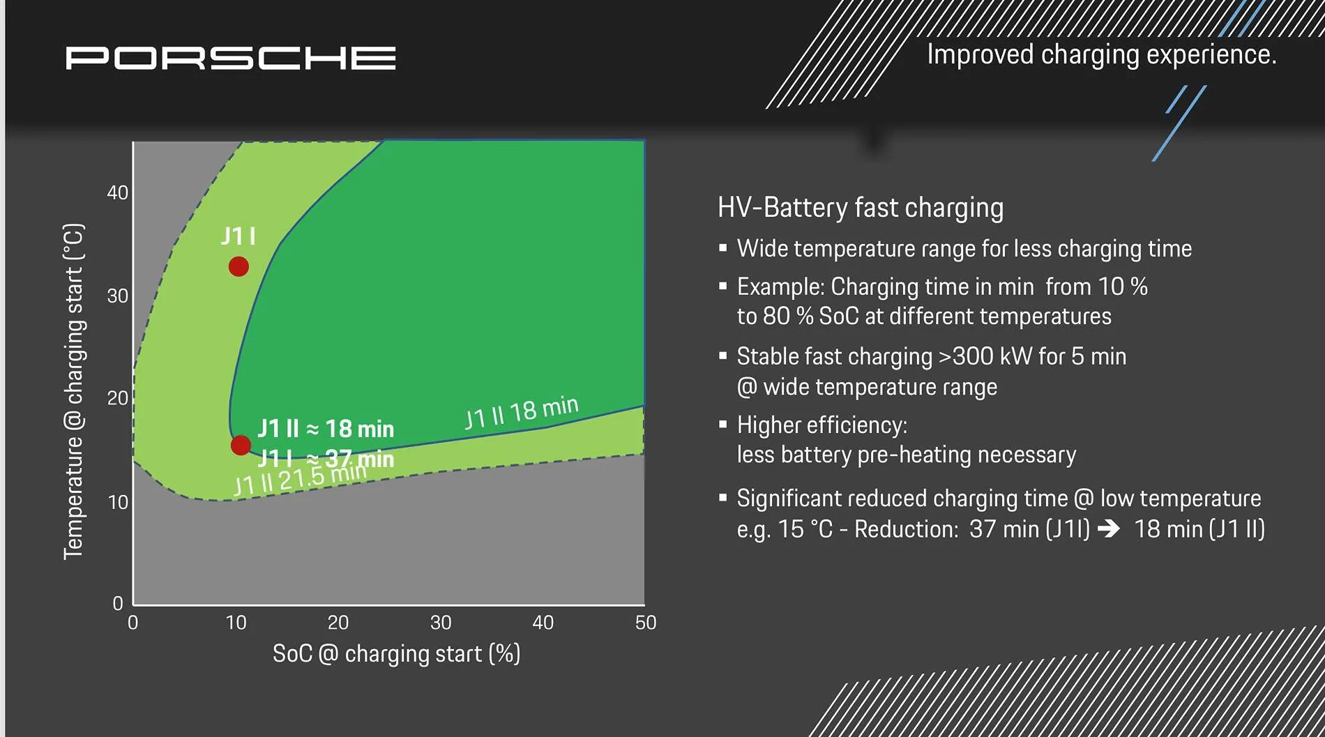

Also, on my previous post I came across this graphic for Taycan regarding the difference in rapid charging time - 18 mins so almost bang on with my real world experience of 17 minutes:
Electric Macan EV MY26 software update (week 36) for MY24-25 1764772181791-ll
