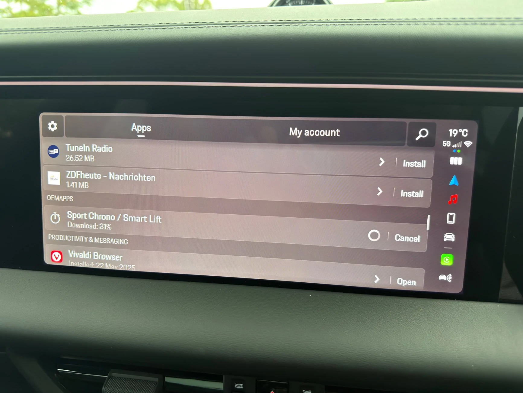

Some of us had CarPlay issues out of the blue that seems to be an OTA in regards to the cars hotspot feature, the password policy has been strengthened and so that seemed to have come as an OTA …
The only other update I've noted is the Android app update of the Sport Chrono/Smart Lift app.
