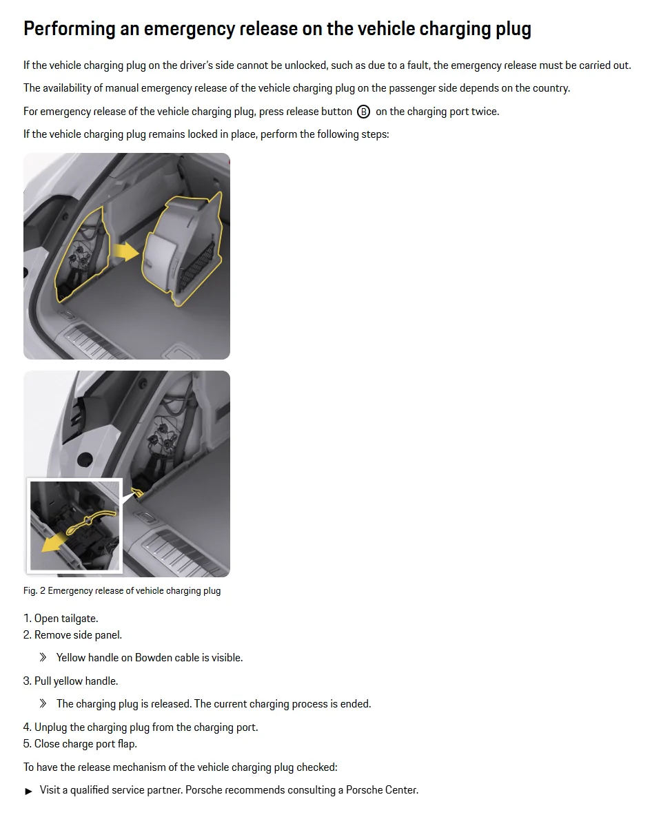

Last night when I decided to charge at home, neither flap would open with usual gesture, then when I tried touching the flap icons on the screen I got the message ‘function currently not available’. I then tried the emergency cables accessed inside the rear wings - both solid, no movement and I yanked them hard. Battery currently below 20% with no option to drive to dealer. Dealer suggested Porsche Assistance. After receiving the SMS and the request for details provided, I am still waiting ( and waiting …) for the tow truck despite message saying will contact ‘in minutes’. Anybody had this issue with the flaps, that dealer says ‘never seen it’?

1) Don't use the emergency cord to open the charge ports, that's to release the charging cable

My first thing would be to see if there is a manual emergency release mechanism to open powered charge ports. I am looking in the manual right now. However, this still does not mean the car will charge as there would be some type of sensor that needs to tell the car that the port is open and charging can proceed.
Sure enough there is no manual emergency open of the door, only release of the plug.
This is not good. I have had powered ports on my Taycan with zero issue with 3 years now, so you would think they would get this thing right by now for Macan EV. This has to be a major safety recall as you can get stranded if you cannot charge when traveling away from home.
