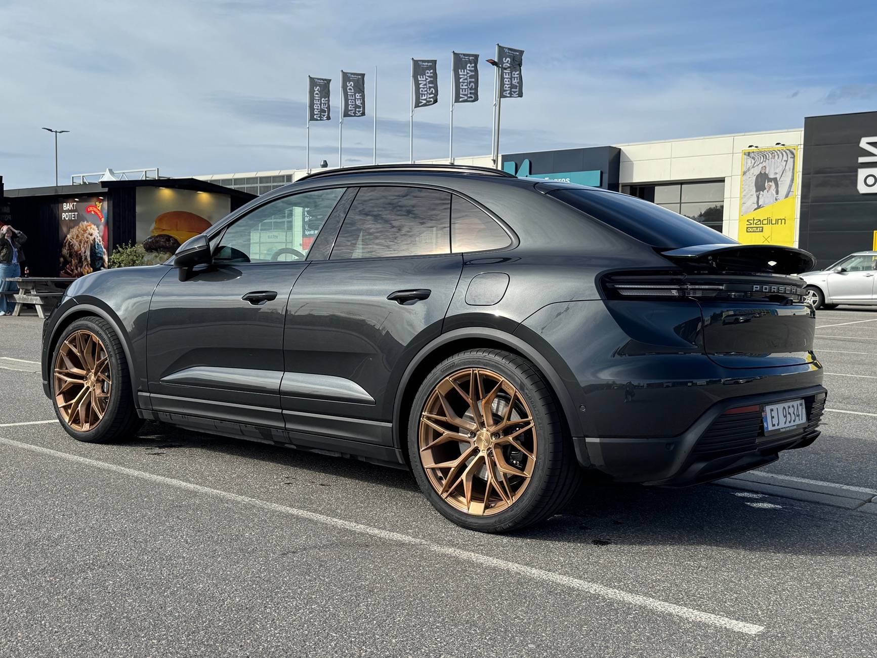

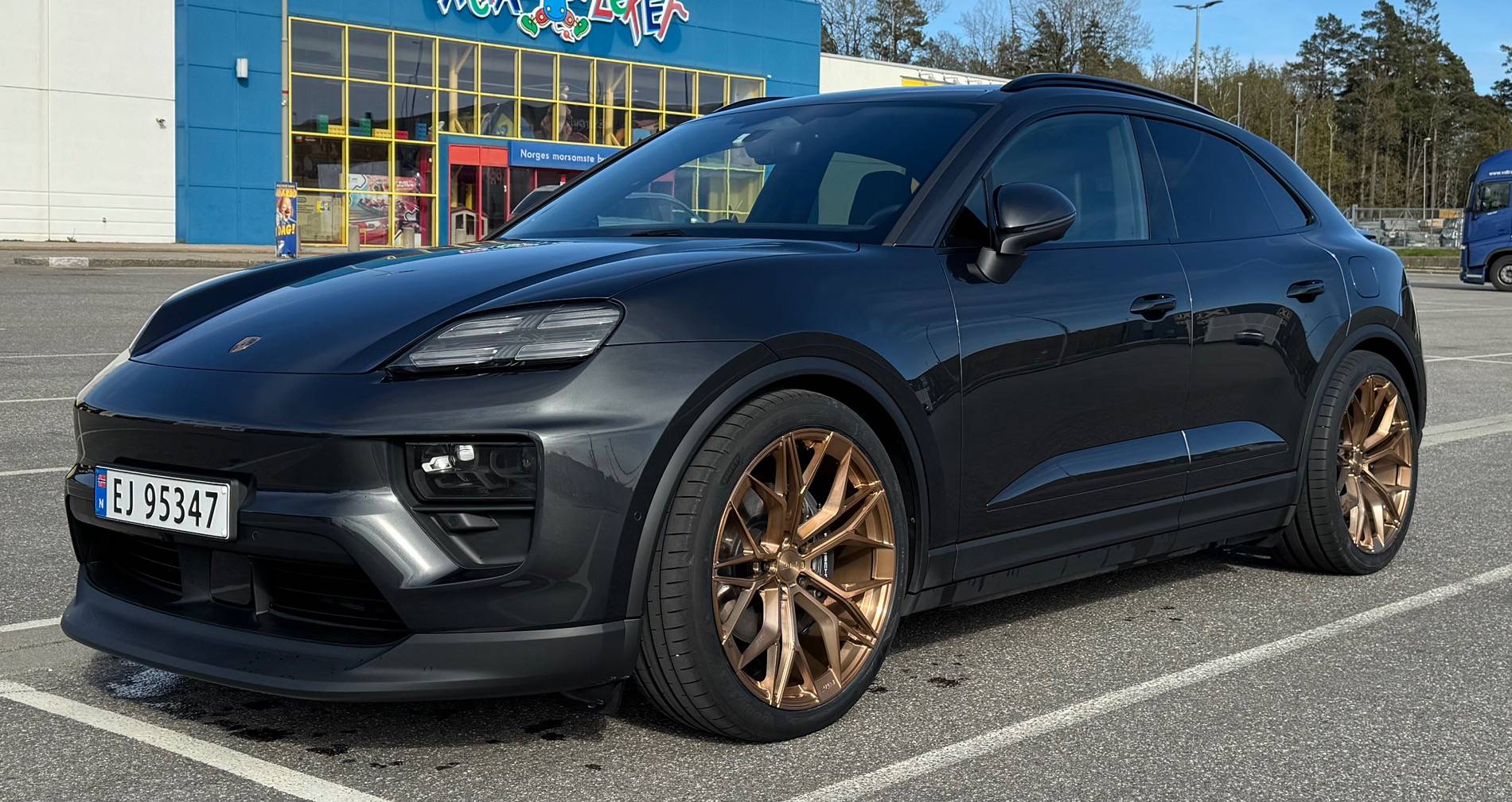

damn i like!! what size tires are those? they look a lil more square than the OE size

wow do you have of them along the side...how do they sit with the fenders cuz you went 5 mm below the factory offset...

Tires are within the fenders, it’s just 7 mm out in comparison to the OEM wheels. In EU that’s within the rules (max 15 mm per axel)

@ThomasR have you observed any impact to the car driving characteristics and also the range as well?Are the new wheels any lighter than the OEM ones?

i don't care about the rules...just things like rubbing the fender liner at full turn etc...
i'm in the process of choosing some 22's and I was going to do 27 and 45 offset. I want it to be flush, but not visibly outside of the fender.

I Get the same range as i get on 20" with nordic studdless wintertires. 500km +/-
Not sure if they are lighter than the OEM ones.

-7 mm is not much of a difference, on most cars you can go -10-20mm before you are outside the fenders. On my Taycan CT I had 18 mm spacers with 21" (OEM specs) , they were flush. On the Macan EV i think maybe ET 20 and 38 will be flush if you have the widest fendellists, I have the narrow ones.
27 and 45 offset is surely inside.

Being forged, they're definitely lighter than the OEM ones otherwise it would be impossible to get the same range with the 20"s which is supposably increased. The winter tires reduced efficiency alone isn't that much great to counterbalance the difference due to the rim size.

Hey @ThomasR
Think we can side shot from straight on to see how your config lines up with the fenders?
pretty please...
I got one of those Ramstead tools ... and i'm seeing that you were correct..you can go a lil lower than my initial thought.
for the front 25et puts them just a lil inside the fender... and for the rear, 30et will make almost flush.
no rubbing/hitting the fender for you so far?
