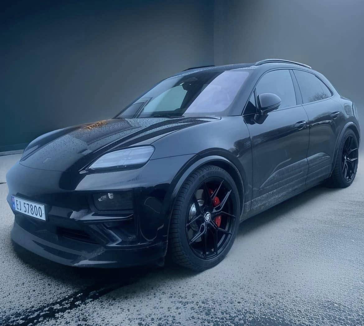

Is there some muck on the bonnet in the last picture? 🤔

not gonna lie, the brand is pretty lame and so is their marketing. hyrbid forged wheels - a blend of cast and forged wheel? what kind of muck buys this? :giggle:

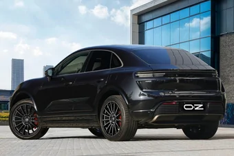

Although not specifically for EVs, a winter wheel I would do. O.Z. Super Turismo Dakar. Off the rack fit for 21s.

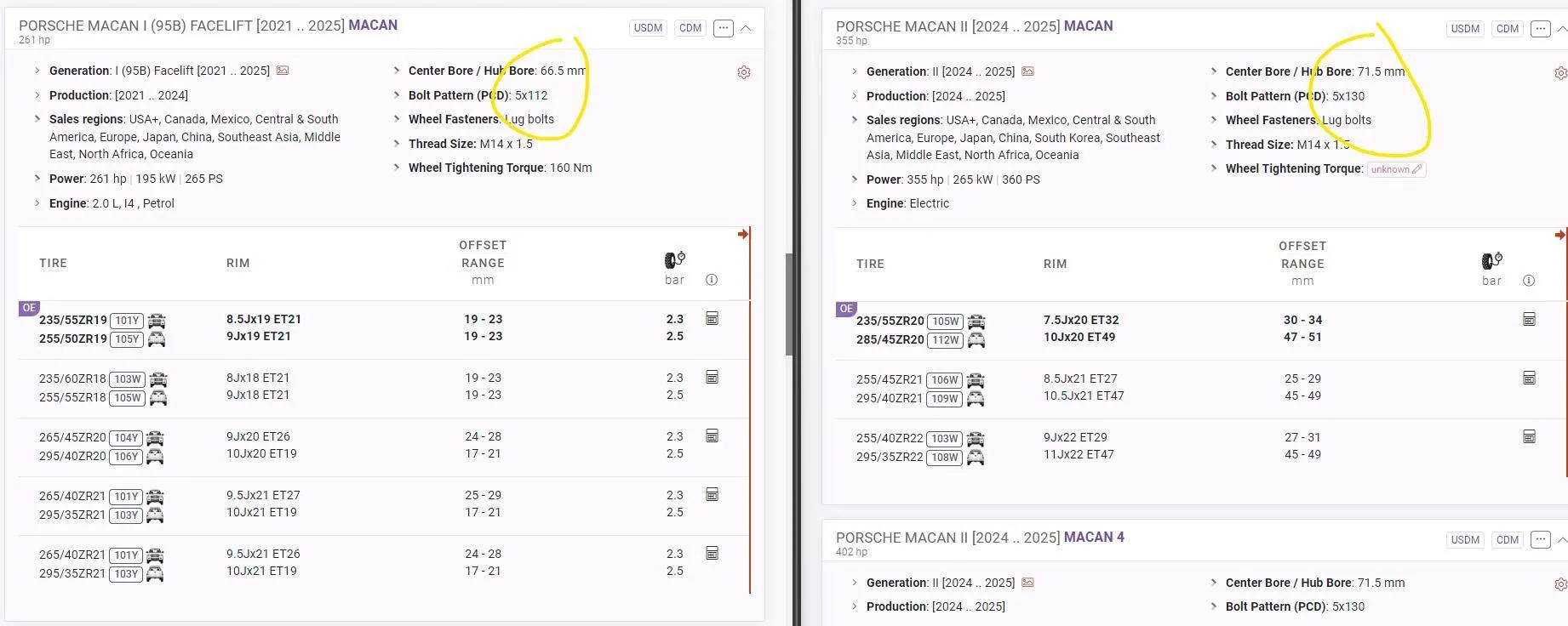

Same here on all points. I just wished I had confirmation that ICE wheels would fit.
863
488
uhg... sorry... bolt patterns are different
