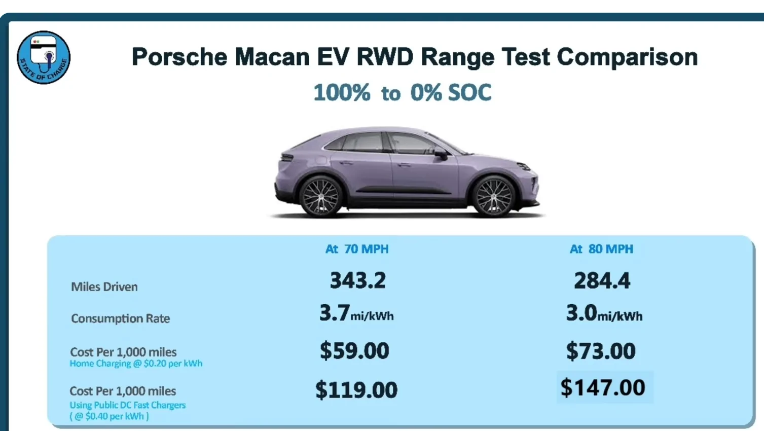

I would say yes. I know this is for a RWD but at 80mph steady test it is around 280 miles.
Electric Macan EV 4S Range 1783085298992-5h
