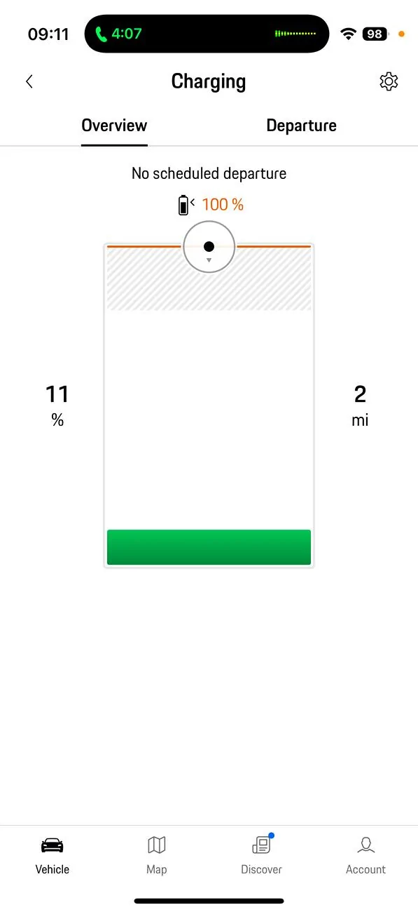

I took delivery 10 days ago and a full 100% charge only Macan 4 displays a range of 260 Miles.
Yesterday on a cold day with 11% charge it displayed a range of 2 miles.
I complained to Porsche Solihull and was told this was normal and it can take upto 4000 miles before you get optimal range.
I am not convinced ?. Appreciate any advice

That's more than just "poor range". It's clearly nonsense from the car. 2 miles range with 11% remaining would mean just 18 miles at 100%.

2 miles at 11% is just a mistake by the range meter.
The range meter is just a guess. It tried to estimate range based on temperature, battery %, and your known driving style.
In addition, there is some amount of miles before the car will get full range.
Finally, there are different types of range. One is commuting, which is extremely inefficient and will show bad range (especially in the cold). Turning on and off the car will use a lot of energy, especially when it has to heat the cabin. The other is highway, which is more efficient and will get more range.
With that said, if you're in cold weather 260 miles is probably a fairly realistic estimate for commuting range.

you only took deliver 10 days ago...the battery hasn't cycled/conditioned enough yet. I'm assuming you haven't even consumed a whole battery worth of range yet to worrant an 100% charge up... and you said it was cold...

I have read many times on here that the regen is suspended by the ecu for the first 400? miles to ensure the brakes bed in properly. So that would dent early use range.
I have done 350 miles - initial charge to 100%, 2nd charge to 80% and recharged yesterday to 100% which displayed a range of 260

There's nothing wrong with a range estimate of 260 on a new car in the cold. The range is probably a maximum of 330 miles in ideal conditions (72 degrees, flat highway, 60 mpg). You take losses for cold and any time you start/stop/warm the car.
260 mixed use in the cold seems right. I'm sure you can get a bit more on a highway at reasonable speeds.
What range are you hoping for in the cold?
