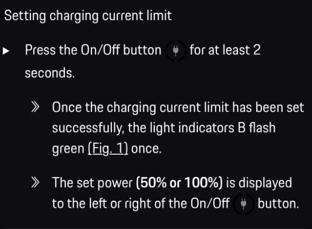

My car charges at the dealership, my charger works at the dealership too but when I connect the charger at home, the charger lights 50% instead of 100% (picture attached). The dashboard says that it's not able to charge my car.
If you push and hold the 🔌 button for 2 seconds, it will switch from 50% to 100%. It comes set at the factory at 50% for whatever reason. Took me several hours of scratching my head and searching in the manual until I finally found it.

All I can tell you with my Macan 4S is that at the 50% setting it was charging at 5.3 kW, and at the 100% setting it was charging at 9.6 kW. I was kind of bummed that it can't charge at 11 kW like my Rivian using my Rivian wall charger (even though the manual says that it can charge at that rate), but I'm guessing it is a North America thing.
