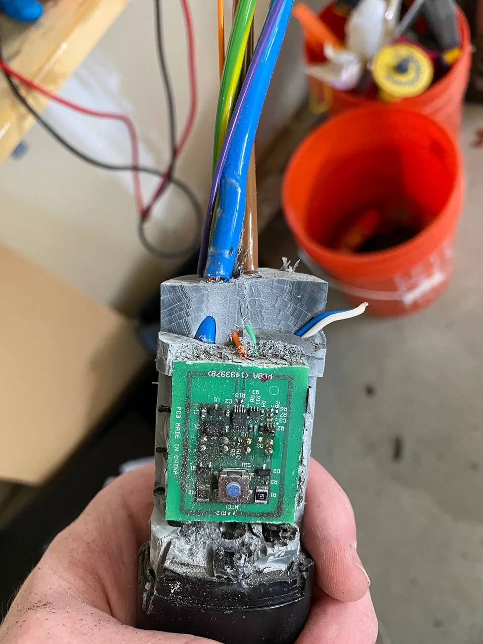

Maybe, but these things don’t have to be dumb. Maybe one was torn down and was, I would tear mine down but it isn’t worth it to me. Tesla could easily be reading an ID off the adapter if it is able to provide one.
Maybe if I get a Porsche adapter I will try it on the Volvo.
And trust me I’ve dissected my fair share and reverse engineered :). I got my v3 charger (EVSE) working on my j1772 cars before they supported it by adding some electronics on the comms pins.
This is what the inside of a Tesla charging handle looks like. I was able to extract this board and created a clicker that opens Tesla charging ports just to punk my friend :) He was confused and then very amused.

given the voltage going through these things and the lack of space they kinda do have to be dumb - check out some of the youTube videos - the main design issue is keeping the 400/800/1000V DC pins electrically isolated from one another - other than that they are simple pass-through devices…there is no ID being read off these things…all that is done over the comm pins and it's the ID (if any) of the the vehicle via the CCS protocol's support…

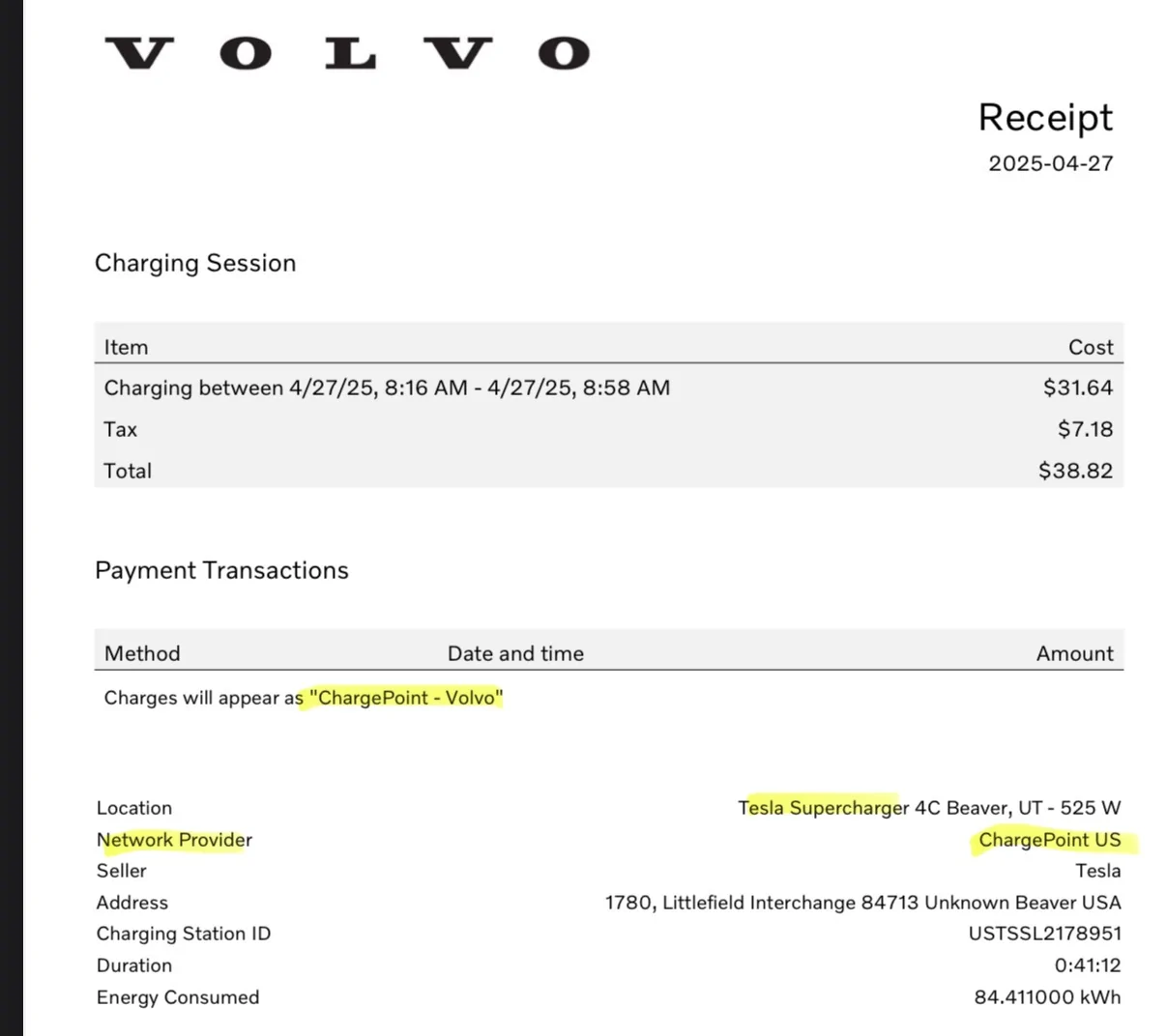

Add to that the Volvo implementation for supercharging not only requires you to use the Volvo app, but also to link a ChargePoint account, and ChargePoint is the actual one billing the supercharger session, you can see why I am just throwing up my hands and saying Tesla could be doing anything they want to authorize any vehicle in any way they choose :)
