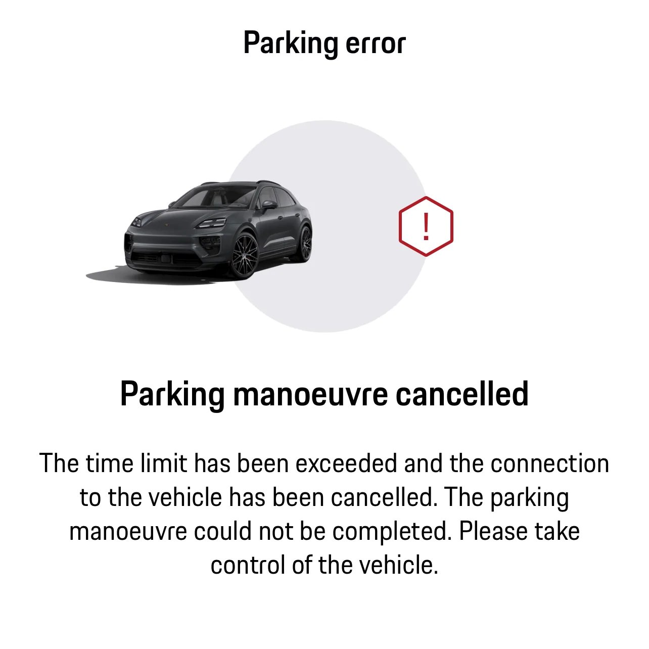

I have MY26 (June 2026), and optioned Remote Park Assist including 3D Surround View, Comfort Access and Porsche Digital Key, so far, I have found it to be somewhat unreliable, especially the 'remote' part. Let me explain:
  • Parallel parking, pretty good
  • Parking exit mostly fails with "driver take over" or something like that
  • Bay parking between cars, pretty good
  • Marked bay parking (new for MY26?), bays are identified, but the car fails to complete the moves to actually park - more attempts needed, as I only tried it once
  • Reverse from a parked spot close to a fence, fail; well I parked it there without hitting the fence, surely the car can reverse, but no "system limits" at play I think
  • Trained parking, remote exit fail
  • Straight remote reverse, fail
Anything remote is just useless, the system gets confused and aborts after starting, i.e. the car turns on, it might even move slightly, then abruptly aborts.

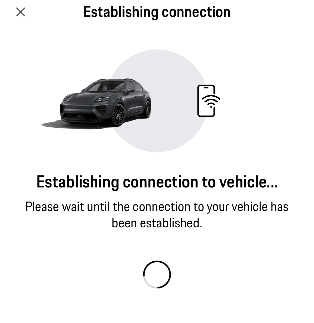

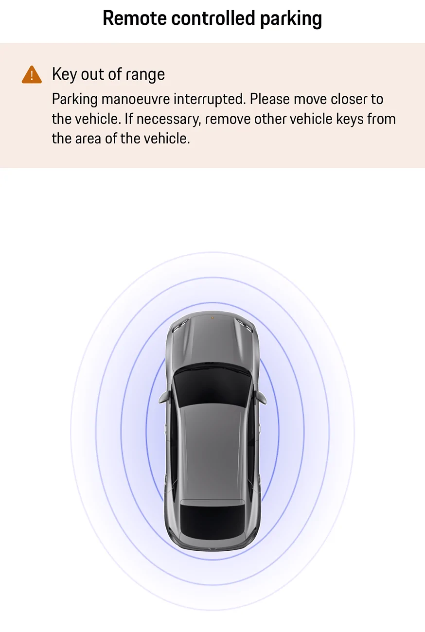

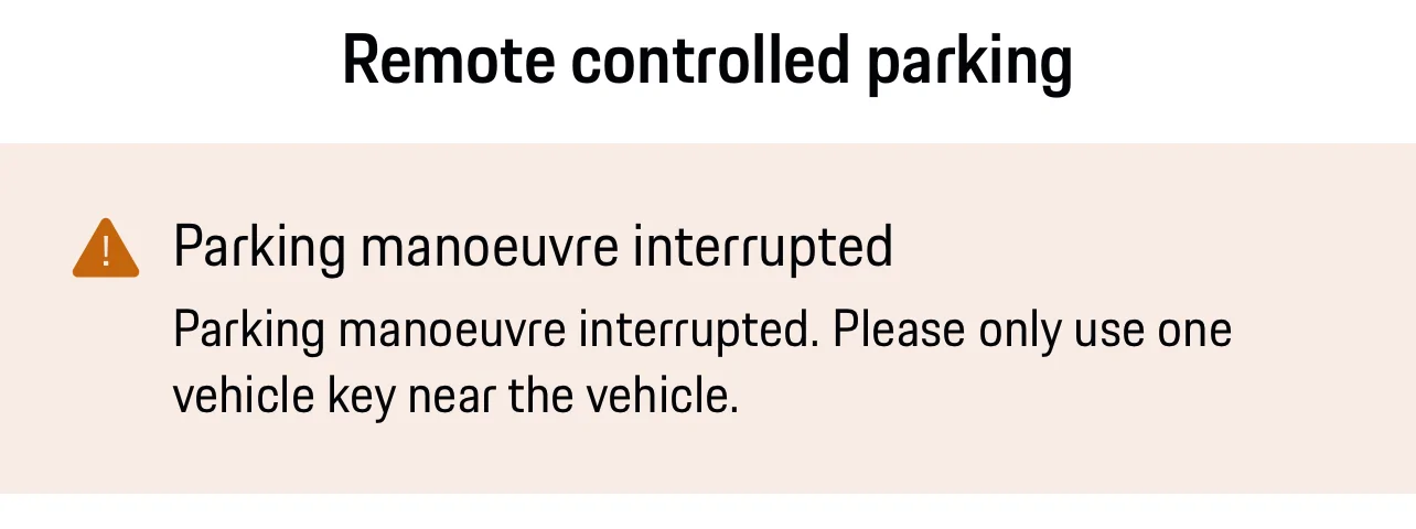

Reading the prompts and manual, a physical key is required nearby for remote parking actions to work; this in itself is a severe limitation given I wanted to 'rely' on only carrying the digital key (on my iPhone), but the car seems to get get confused by the physical key and digital - I'm standing right at the drivers door, car locked/off, with both physical key and phone::
Electric Macan EV Remote parking 1784399042613-ds
... connection is generally successful, however, starting a manoeuvre is not...
Electric Macan EV Remote parking 1784398680719-9k
Electric Macan EV Remote parking 1784398612485-6f
and eventually:
Electric Macan EV Remote parking 1784399176461-h
Any suggestions on how to get this to work, most likely this is user error 🤨? Any one have success?

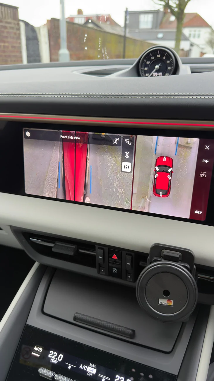

Reversing assistant I’ve used with some success.
However I’d buy the option alone for the wheel/kerb cameras. Worth it’s weight in gold.
MMR
Aug 19, 2025
290
259
Is that different to what you get with 2D ?(which is standard now)

I think you've exhausted the options and not likely to be user error.
The system has limitations which are outlined in the manual but to be honest I wouldn't use it as it just wouldn't work in my use cases nor would I trust it if it did.
