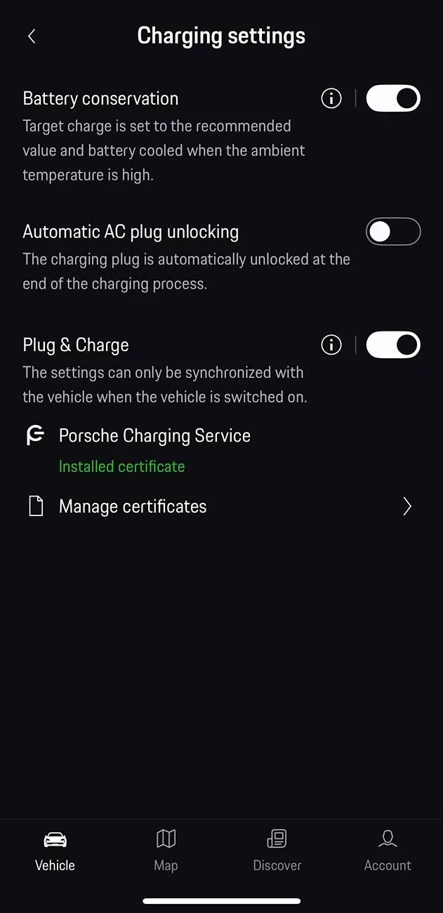

Plug & Charge error message finally gone this morning! When you click on the settings icon (right upper corner) while on the Charging function you can see that the Plug & Charge button is now on and Porsche Charging Service is now available underneath and it’s showing an “Installed certificate” in green! Yeah! ?
Electric Macan EV Plug & Charge error in app after update but worked at EA IMG_7866

Yes Plug & Charge error message is gone on mine today too!
