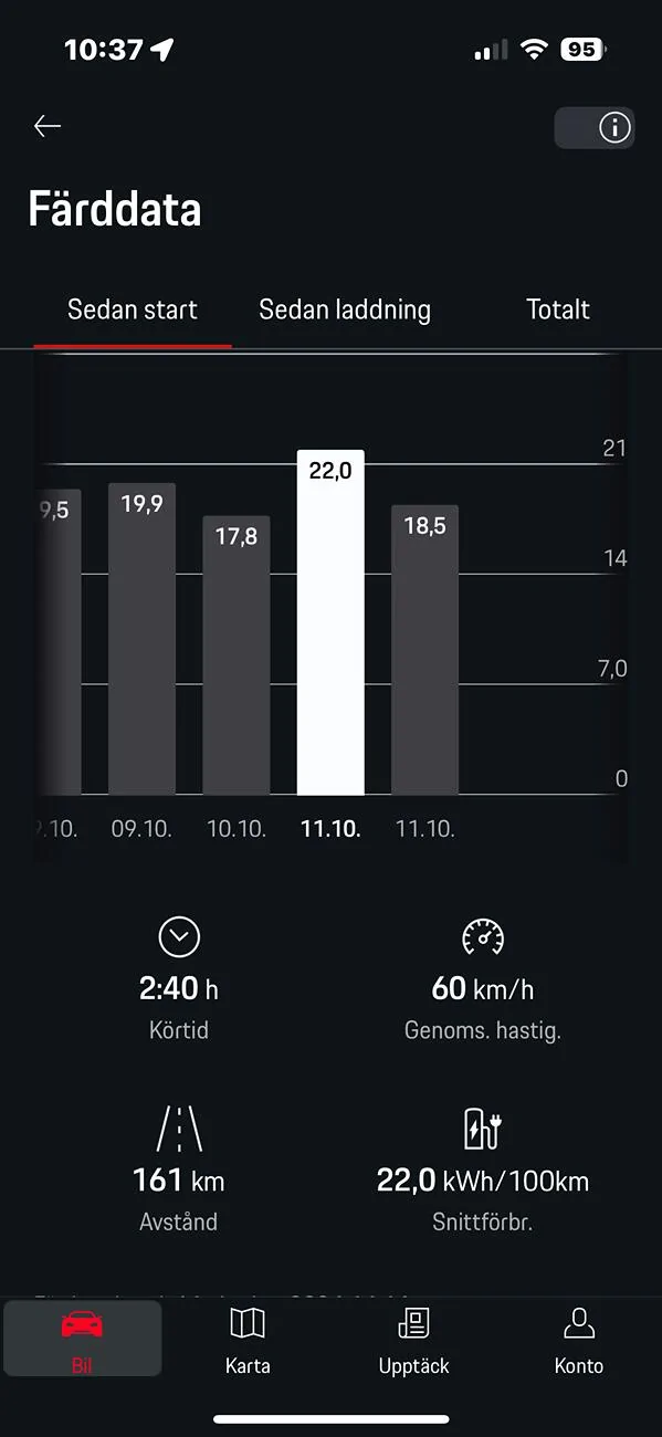

Hi,
I was worried in the first day when i got my car and it was 100% charged and told me 430km.
i have been driving now a couple of days and im up of total of 568km of total driving. Still dont know if reginaration period ”brake” is active yet. But is quite easy to drive under 2kw/10km meaning we can do 500+ km on the turbo if we dont push too hard-:)
I attach a picture of the tripdata, this trip was long and avergage speed was like 120-140kmh but there was accident on the road in the end and because of that my average speed went down to 60km. Other days is normal city driving..

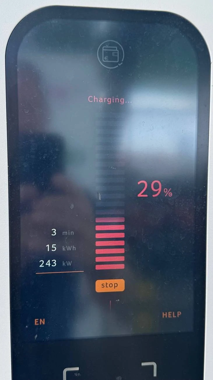

If it can get 400 km’s at 130 km/h that would be cool, it means 300 with stops going between 85 and 5% This is what I can get with my iX, slightly larger battery but also bigger heavier so it should be similar, it would charge faster when the chargers can deliver the power.
The max I get at Ionity is this
Electric Macan EV Macan Turbo EV real range? IMG_5732
721
1,160
Not bad at all, for the moment (just one charge) I reach 161 kW but I was at 46%.
