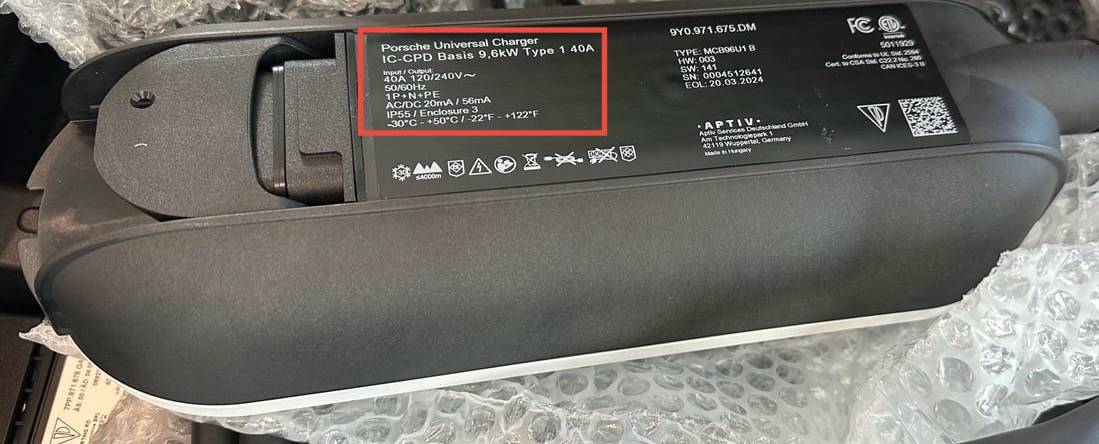

Have you taken delivery and are you happy with your charging arrangement? I have a professionally installed Tesla Wall level 2 charger which I have been using since I purchased my Model S in 2016. I have also used it with a Tesla to J1772 adapter to charge my Rivian RS1 and my wife's Volvo XC 60 PHEV. Do you know if Porsche endorses the use of the Tesla charger?
Do you know if the Porsche supplied charger is level 2? I have been trying to find information wrt how fast it charges but have not been successful. Thank you.
porsche charger (EVSE) is L2 @ 9.6 kW - NEMA 14-50 or 6-50 plug - 40 amps - 50 amp breaker - Porsche only endorses their charger, but that's because they are clueless - these items are called EVSE's - Electric Vehicle Supply Equipment - they are simply external raw power supplies with an on/off switch under control of the car - there is honestly no difference between chargers because they just allow raw AC power to flow into the vehicle where an onboard charger is responsible for charging the battery - not the external EVSE - if Porsche's EV's were really not compatible with non-Prosche EV chargers (EVSE's) how would you use public chargers? none of which are Porsche chargers? Your Macan/Taycan will work fine with most any J-1772/NACS EVSE - it has to be that way because other wise you couldn't charge at work, hotels, malls, airports, or any other place that has installed EVSE's.
_ALL_ North American mobile EVSE are limited to 40 amps (9.6 kW) - since that is the maximum amount of power a _MOBILE_ EVSE is allowed to draw from a plug - if the EVSE is more powerful than 40 amps it has to be hardwired (not plug based) so it ca not be mobile.
your existing Tesla EVSE will work fine…
the charge rate and max power of the porsche charger is clearly visible in the image posted in post #1 - it's listed on the unit itself as 40 amp @ 9.6 kW…

Here is what came with my 2024 Macan Turbo EV
  • Porsche Universal Charger (PUC) IC-CPD Basis 9.6 kW Type 1 40 amp
    • Part #: 9Y0-971.675.DM
  • this appears identical to the PMC/PMC+ unit - so I'm not sure what the actual difference is
    • but it does appear to come withe a "beefier" EVSE to Vehicle j-1772 charging cable - this cable is "fixed" to the unit and can not be swapped
    • it does have "new" sticker on the front with some warning stickers/iconography that was added to the PMCC/PMC/PMC+ units during a recall
  • A Wall mount bracket of some type - this appears to be a "guide" for the J-1777 charging cable
    • Part #:7PP.971.605
  • Another wall mounting - appears to be a "holster" for the J-1772 charing plug
    • Part #:7PP.915.343
  • A wall mount for the PUC/EVSE
    • Part #: 7PP.943.109.A
  • Porsche Mobile Charger Manual
  • NEMA 5-15 power supply cable - 1.44 kW charge rate - 120V/15 amp circuit breaker
    • Part #: 7PP.971.678.FQ
  • NEMA 14-50 power supply cable - 9.6 kW charge rate - 240V/50 amp circuit breaker
    • Part #: 7PP.971.678.GA - this is new part number fo the same type of cable vs. the NEMA 14-50 cable that came with my 2020 Taycan and 2021 Cayenne eHybrid
    • I'm going to venture this the new "recall" cable - it has thicker 8 gauge wire for better thermal performance and it also most likely has the thermal sensor to allow the PUC/EVSE to detecxt and slow/stop charging if the cable is getting 'too warm'
    • it also has the NEMA plug facing the "wrong" way - which requires you to twist the plug-head to plug it in - this is a thing on the Taycan forums as people are receiving the "recall" cable and with the plug-head facing 180 degrees the wrong way it's now hard to get the plug to reach their NEMA socket…
    • inspection of the NEMA 14-50 power supply cable confirms there is still no "4th" wire for the electrical neutral - the PUC remains a 3 wire EVSE (as expected and required for North America).
  • Two power suplpy cable plug-end covers
  • one baggy with a "set screw" and a custom wrench for the set-screw to attach the power supply cables to the PUC/EVSE
    • part #: 9YO.927.129
  • Canvas storage bag to hold everything and two carbiner loops to anchor it inside the car.
the unit appears to be the same size/weight as the previous PMC+/PMC unit - and over all just seems to be a slightly warmed over EVSE that will have the same pros/cons as the PMC+/PMCC that Porsche provided(s) with other Hybrids/EV's - the NEMA 14-50 plug head facing the wrong way is subject to yet another recall - in that Porsche will replace the power supply cable with another unit with the plug-head rotated 180 degress so it faces the wall when plugged into the PUC/EVSE…{sigh} they remain somewhat clueless on their EVSE game…
Post #1 of this thread documents Porsche's "knowledge" of the wrong way facing plug head on the NEMA 14-50 cable…Porsche's EVSE game remains "weak sauce" - I have no plans to use the PUC unit and will charge my Macan with non-Porsche EVSE's that have demonstrably fewer problems…
but this post is to factually document what is included with the Macan EV and confirms it's basically a warmed over PMC+ unit…there are better EVSE options for North America.
