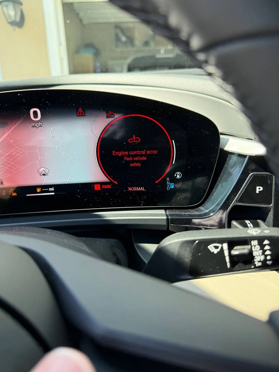

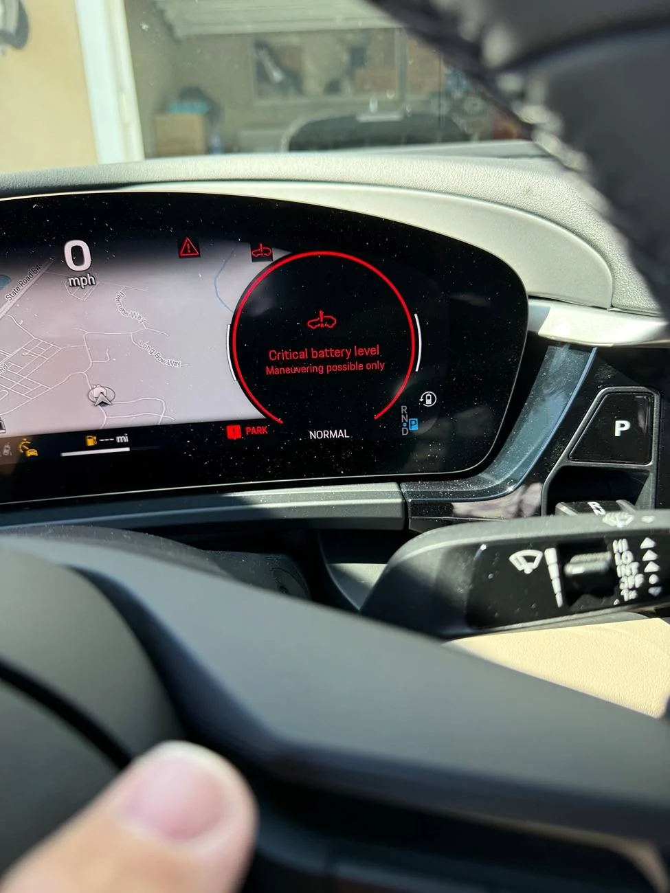

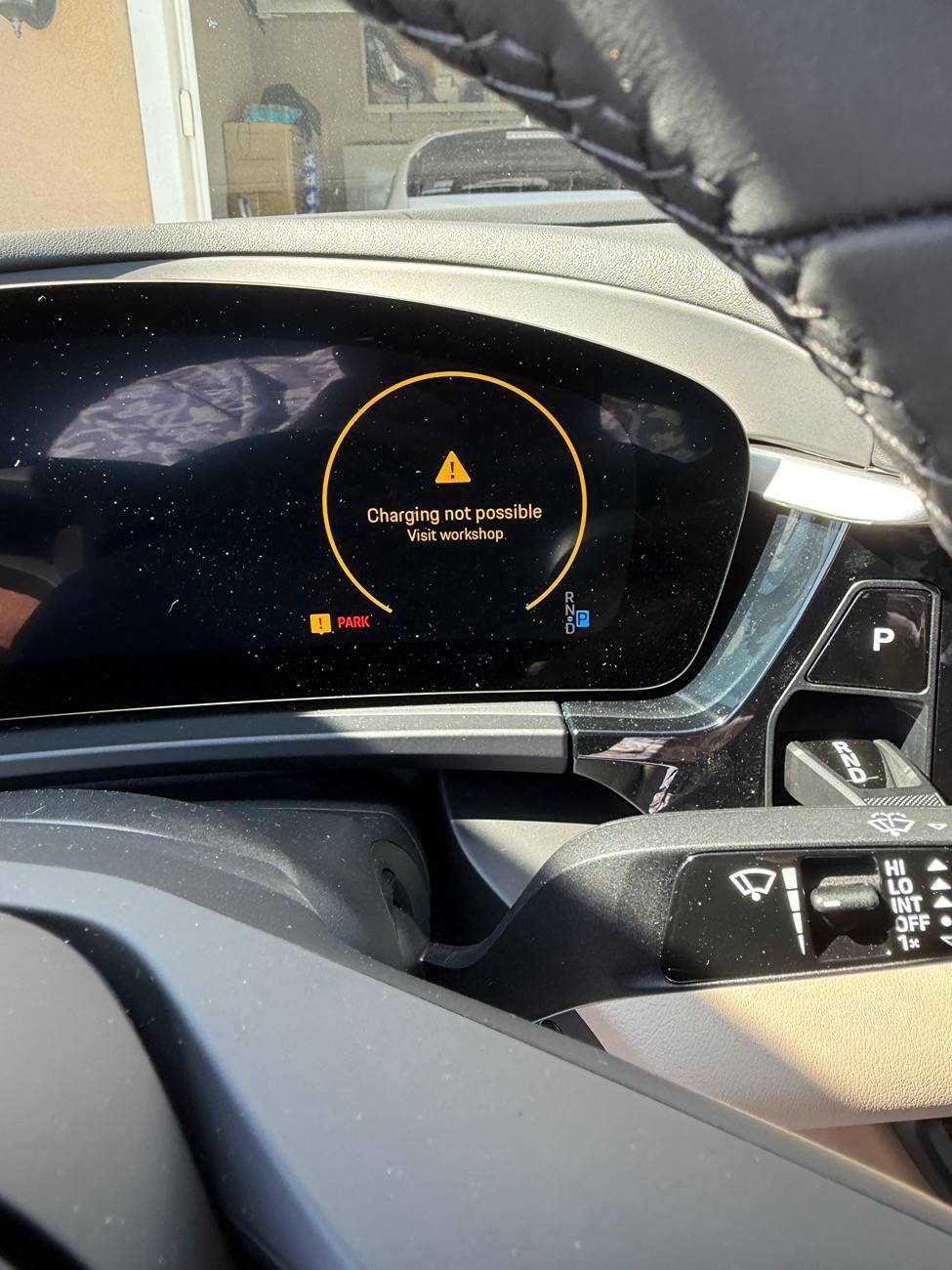

Electric Macan EV Car won’t start. Multiple messages IMG_3136
Electric Macan EV Car won’t start. Multiple messages IMG_3135
Electric Macan EV Car won’t start. Multiple messages IMG_3134

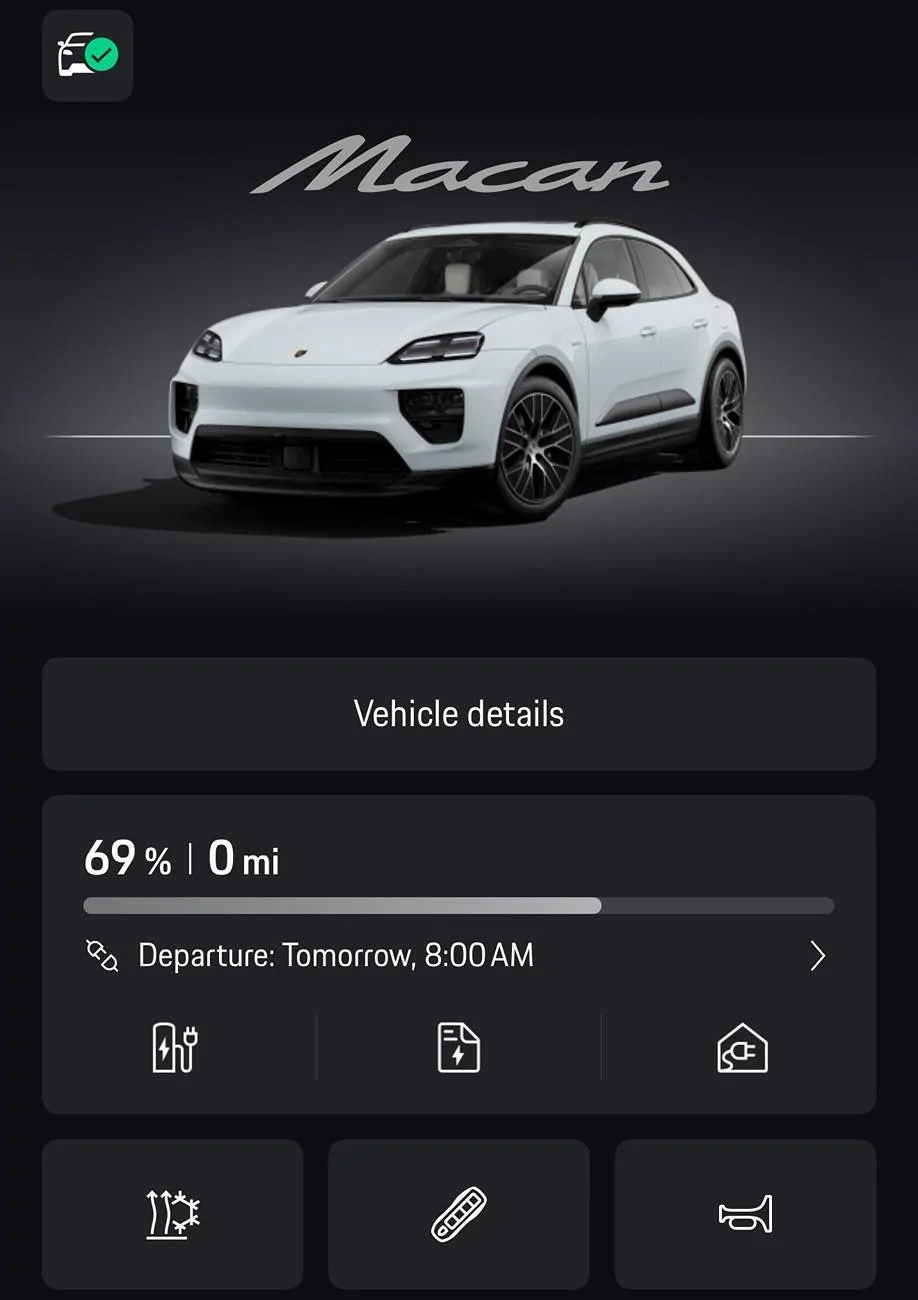

Battery is at 69% but says no range on app.

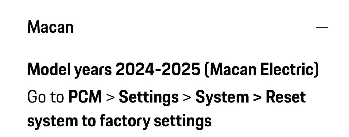

Have you tried a factory reset?
I had SoC 80% and the bar did not come on any more. I locked the car walked away for 5min and it came back on.
4 days later all crazy messages and this time it went dead. Same SoC
The 12v battery was bad according to porsche. Waiting to get the car back.

12V batteries are the Achilles heel of EVs. My 5 year old Jag I-Pace is on its third 12V (there are actually 2 on these cars, so 3rd set) as well as third power distribution module.

You are able to monitor the 12v battery voltage on the dashboard display.
