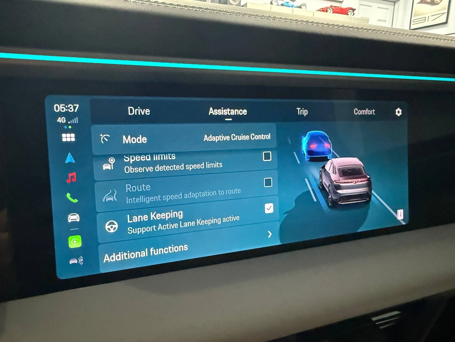

4) The lane assist feels really, really aggressive. Kind of ruins the driving experience.
In settings, you have sensitive settings you can adjust. Play around with it and see if it feels better. I adjusted mine to low interference and the driving experience is improved.
Thanks so much. Super helpful. Will try and keep fingers crossed.

Thank you. And that impacted the lane assist too? By changing the rest to low?
