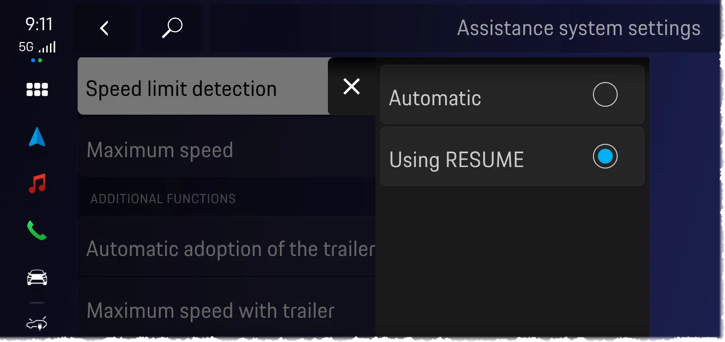

I experience the drop in speed from 40 to 30 about 300 yards from where I live and it is because the main road runs parallel to a lower speed road by a matter of a few short yards. The camera initially reads the 40 sign but then switches to 30 (unsigned) as I suspect the GPS co-ordinates of the adjacent road overlaps with the main road. 40 is then set again at the next posted sign. My hunch is that this is what you are experiencing.
The implication therefore is that 'intelligent' ACC / speed limiters which rely on both camera and gps data can be fooled and difficult to programmatically workaround. The underlying blame / fault may well be due to inaccurate 3rd party information rather than Porsche specifically.
On the basis most of us are aware of these foibles the preference is to not use any auto mode if only to take away the element of surprise when you least expect it. For this reason I would not waste any money on Porsche InnoDrive or Drive Assist as they all will experience this type of issue at one time or another. Basic cruise control and a manual speed limiter is enough for most and work reliably all of the time. That said there is an option to choose "Using Resume" rather than "Automatic" on the Speed Limit Detection option for both ACC and Limiter which requires human input to make the speed change when one is detected.

I have a MY26 car with Drive Assist. I have to manually adjust the speedlimits when it changes, by pulling the cruise stalk towards me.
Not sure if thats a setting I have amnedmed or how its configured from the factory, but its my preference to avoid those phantom braking sceanrio's mentioned.
Could combine it with the audible speed warning if you want to be reminded to stay under the limits (obviously subjective to the same inherent issues as the auto adjusted limt).

That's the 'Resume' function i.e. accept the change in speed limit (see the image I posted above).
