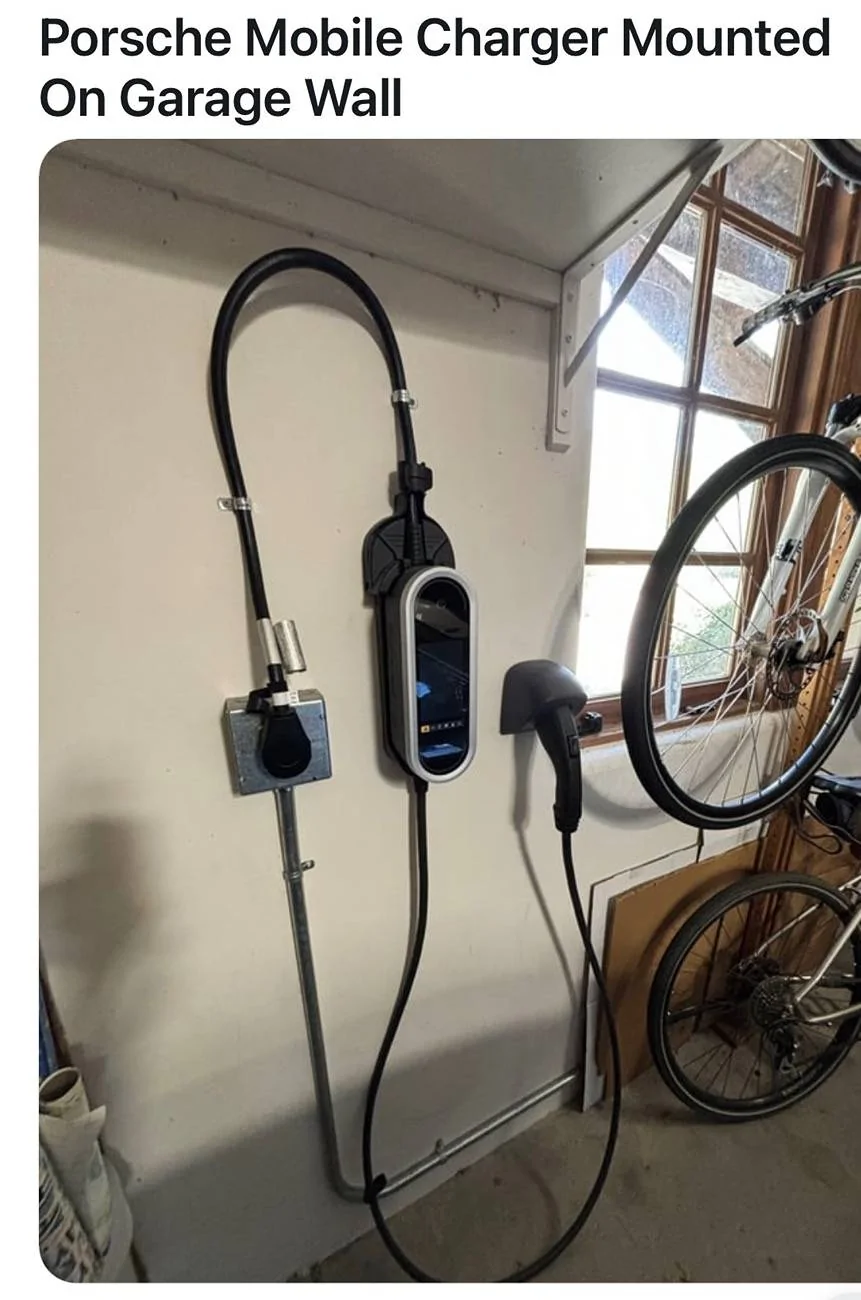

That length of cord from the outlet to the control box looks very short compared to other photos I’ve seen.
that length of power supply cable does not match any past experience with the included porsche EVSE’s - very odd!
also the vehicle to charger cable is quite short - not the 15’ or 25’ cable options
Exactly what i was thinking.... guess i'll have to park backwards in my garage

This does not look usable at all as a permanent garage charging setup given short length.
I understand the benefits of a plug-in setup, however clean direct wire with 25 ft cord is best with a 3rd party EVSE of your choice and then keep the Porsche one for travel.
