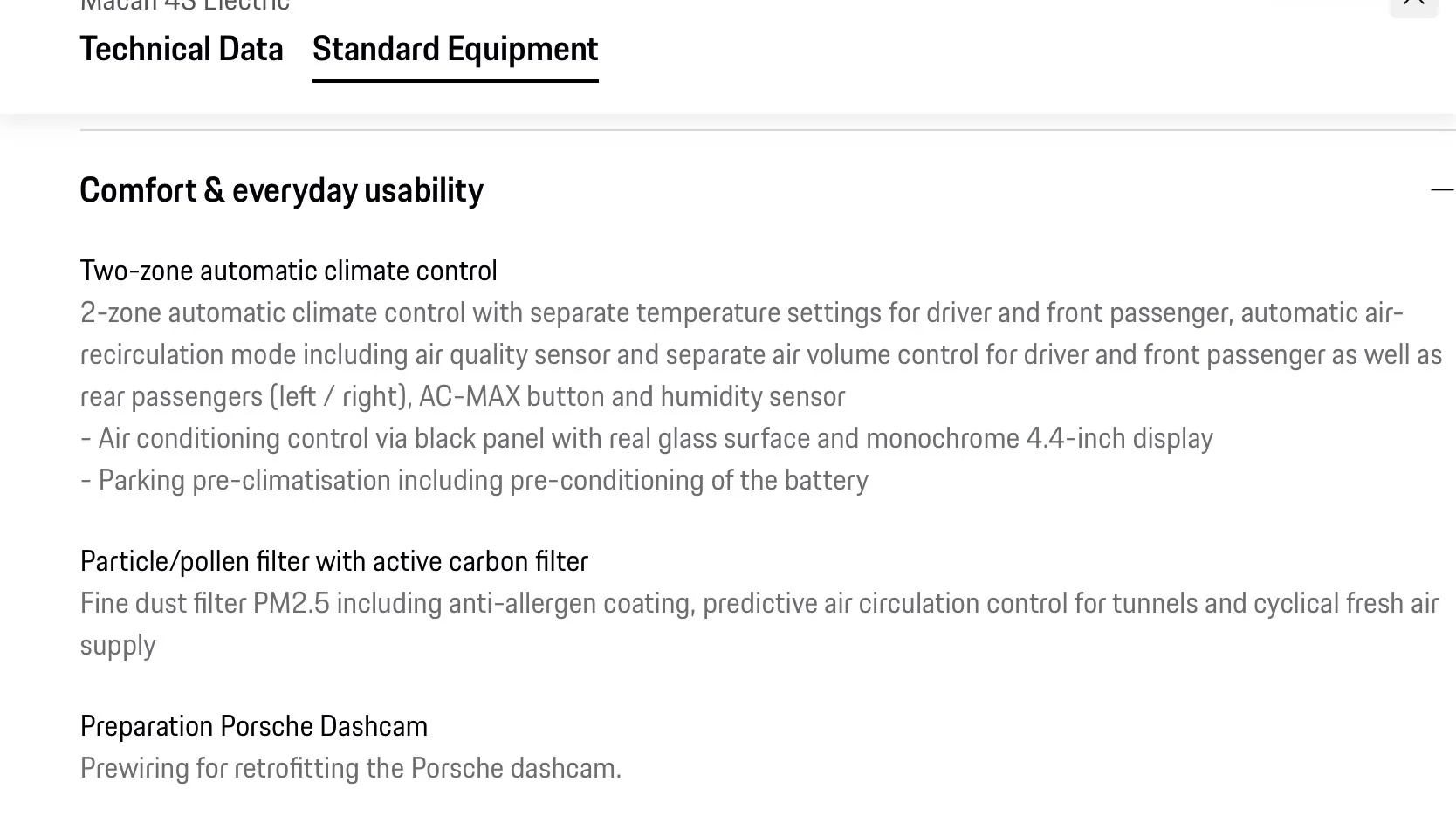

The configuration includes 'Preparation Porsche Dashcam' (QK3) which is described as "Prewiring for retrofitting the Porsche dashcam". Yet when I told the dealer I wanted to have a dashcam, he said that labour would be well over £1,000 (USD $1,370) because "we have to take out the head lining, so it's a big job".
I don't understand - surely that's what the QK3 is for? Is my dealer trying to pull the wool over my eyes, do they not understand or are they correct (in which case I'm not sure what QK3 actually does)...?
The dealer is either shafting you or didn’t explain what the £ 1k is for. As you say, all UK cars come prepared for the Porsche dashcam. The £ 1k should be for the purchase of the front and rear cameras and fitting. The cameras were about £ 400 from Porsche when I bought mine last Feb. They are not the best but with the prewiring they are not obtrusive.

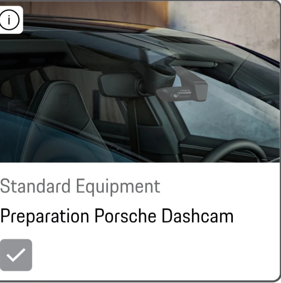

Rewiring option is free on all Porsches.

Winge - I think only on specific countries for some reason
1,053
680
No, actually it was an add on in the configuration for me if I understand your statement , before or after receipt of car?
You have to tick the box even though it is free.
Bizarre but true.
German logic I guess.
