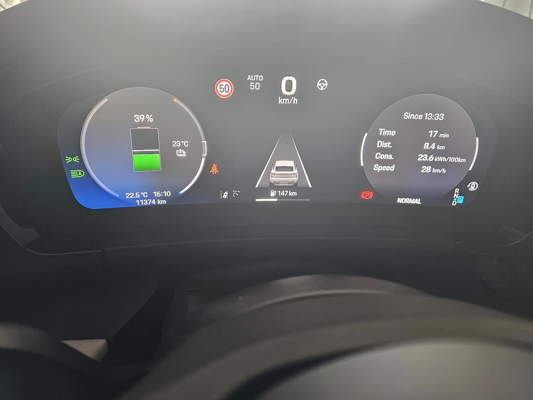

It does not really matter whether you open the door everyday or not. If you don't touch the car then upon getting to the car you will see your percentage plummet in real time. As you can see here car was parked in garage with 39% SoC
Electric Macan EV Does your Macan EV keep SoC stable when left idle for a week or longer? 20260613_151054
In video I am getting to the car 9.5 day later. In video you can also see comfort access not working until I pull the handle and long bootup of PCM. I have seen someone stating that car does this if it is not used for few days to save battery. Mine is doing this randomly even in day to day usage for some reason nor it seems to save battery...
Also if you would open app or even pull down to update data in it it will still show same SoC in the app meaning at least some part of the car has no idea about SoC drain until you open the door.
And to answer your question I absolutely hate going to my car every day when not used just, so I can take picture as evidence that this is happening every single day in hopes that somebody in service center will realize that this is really not normal behaviour and there is either something wrong with the battery or BMS and they will finally fix it.
My car is getting latest SW as I am writing this so maybe that will finally fix this problem as others mentioned. But at this stage I am really sceptical.
