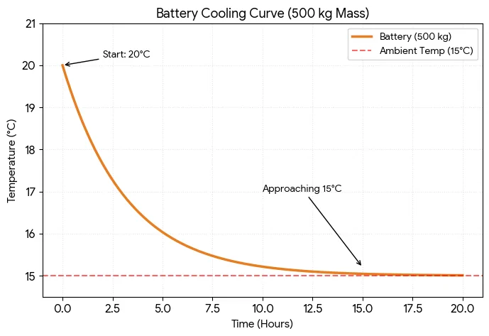

Yes, that's right, lowering the temperature by 5 degrees to match the ambient temperature can take approximately 15 hours.
This graph, which assumes a mass of 500 kg, can serve as a reference.
Electric Macan EV Does your Macan EV keep SoC stable when left idle for a week or longer? 1773562248346-ni
For example, assuming a garage with a constant temperature of 15 degrees,
if after 10 hours the temperature is still 3 or 4 degrees above the ambient temperature, it means that energy has been used to heat the battery.

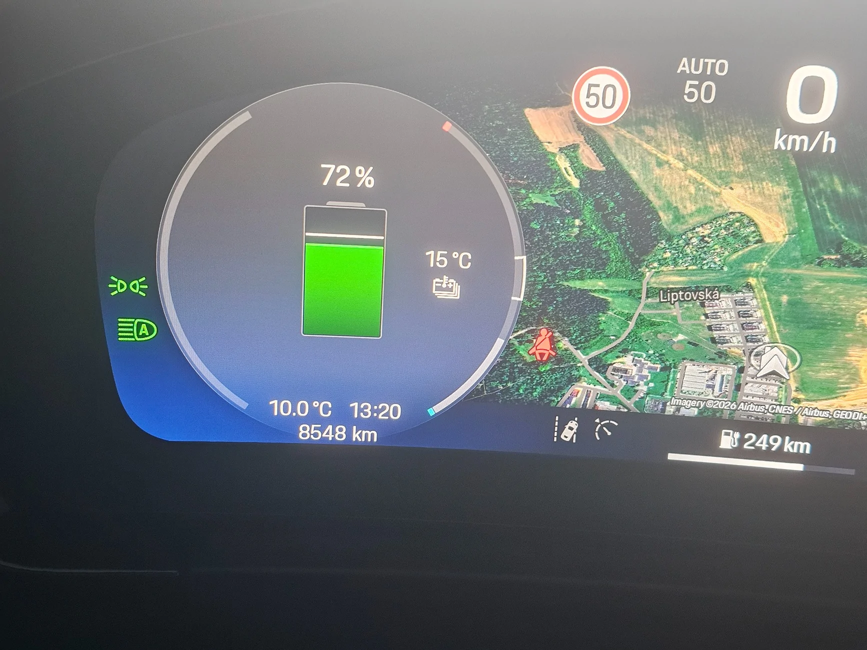

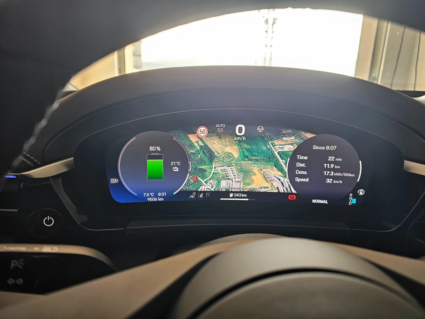

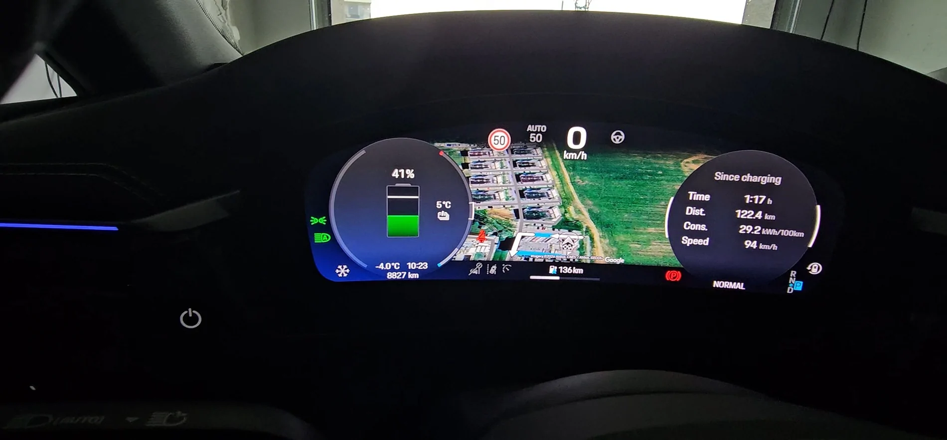

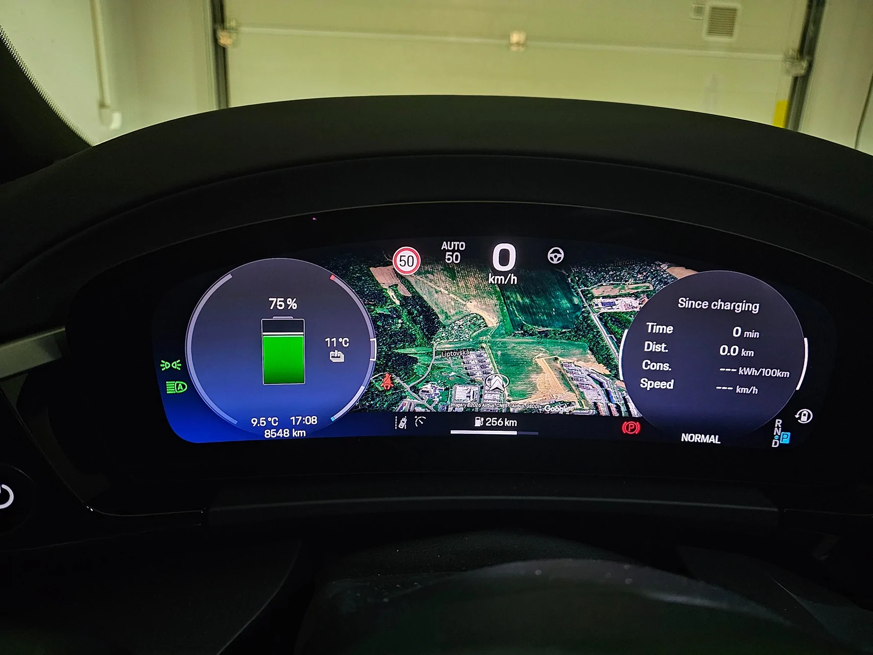

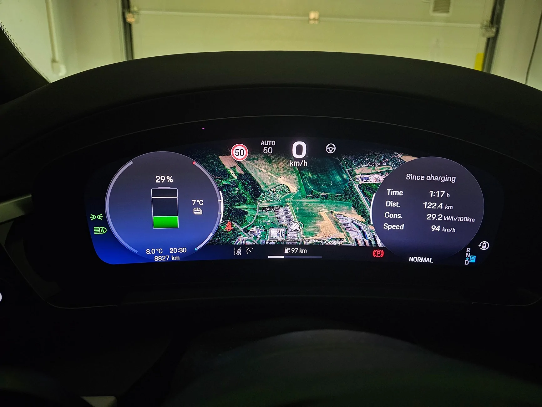

Jesus you Porsche fanboys... Could you please explain to me what I am gaining by writing this up other than letting other owners, which if you have not noticed are reporting same things, that there is really something wrong with their cars and they should not let service centers to push them around like idiots?

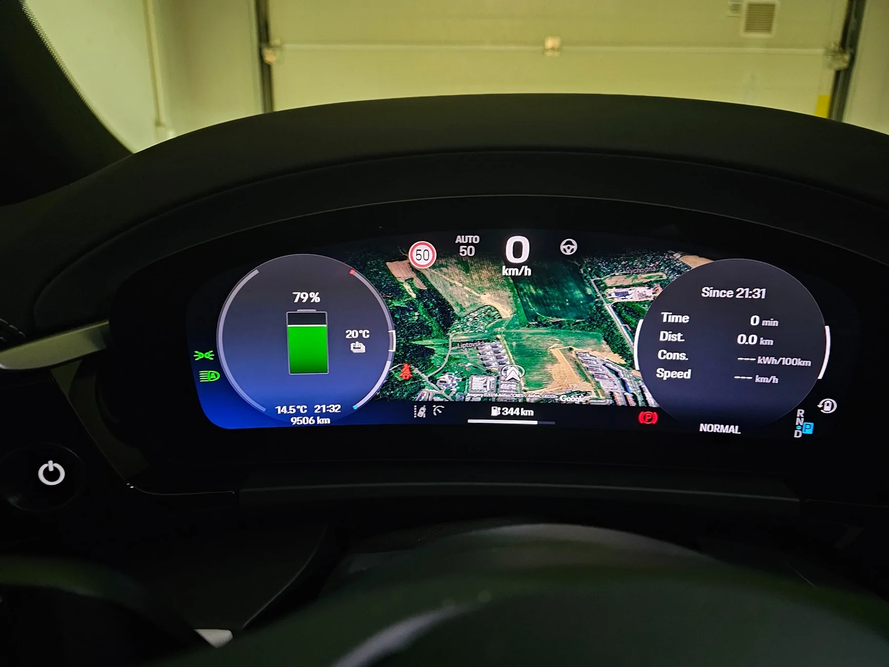

I am dealing with this for last 6 months (mine issues showed up 2 months after buying this stupid thing and no discharge is just one of many other issues that I have). But hey lets see some made up pictures:
Electric Macan EV Does your Macan EV keep SoC stable when left idle for a week or longer? 20260204_170848
Electric Macan EV Does your Macan EV keep SoC stable when left idle for a week or longer? 20260206_161936
Electric Macan EV Does your Macan EV keep SoC stable when left idle for a week or longer? 20260207_132017
Here we have 12% drop:
Electric Macan EV Does your Macan EV keep SoC stable when left idle for a week or longer? 20260216_102326
Electric Macan EV Does your Macan EV keep SoC stable when left idle for a week or longer? 20260216_203038
This is from today:
Electric Macan EV Does your Macan EV keep SoC stable when left idle for a week or longer? 20260324_083118
Electric Macan EV Does your Macan EV keep SoC stable when left idle for a week or longer? 20260324_213206
Would you like me to continue, because trust me I can. I have also many nice videos of PCM crapping out, planner stating that I will arrive with higher SoC than car has at the start, comfort acess not working, frunk not opening, blind spot monitor seeing ghosts or car not charging at full 11kW...

I just have to say that it is also disappointing when you have bought your dream car and it does not live up to expectations. That said, you are very angry and negative in your posts and that does not help your case and when you also call someone names, you lose credibility.
The photos you have posted, I can't see with good will that there are major problems, you yourself have said that the car loses 2-3% a day and sometimes more, I don't see that in those photos. What I notice is that the battery temperature and the temperature in the room (garage) in 2 of your photos are different, namely that it is higher on the battery than in the garage. Have you just driven inside or warmed up the car, are you using the app too much or what explanation do you have for that? The door to the garage is also visible in some photos, is it open or closed and it is cold outside.
