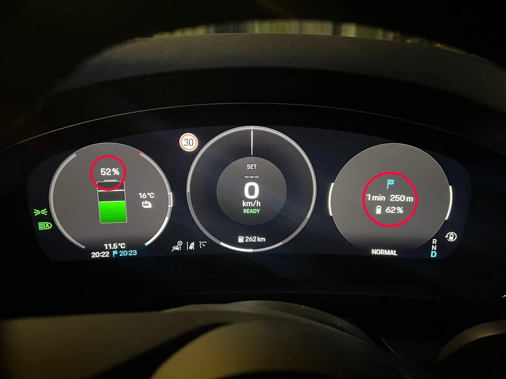

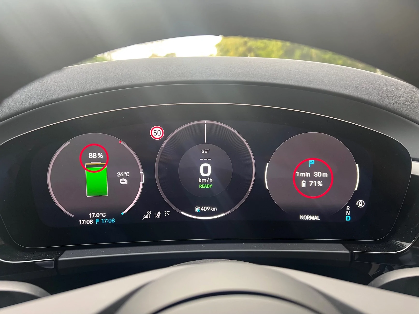

Porsche does know how to create range anxiety by delivering inacurate SoC and/or SoC at destination. Genius.
more is less...
Electric Macan EV Battery % on arrival estimate way off IMG_0618
less is more...
Electric Macan EV Battery % on arrival estimate way off IMG_0268
