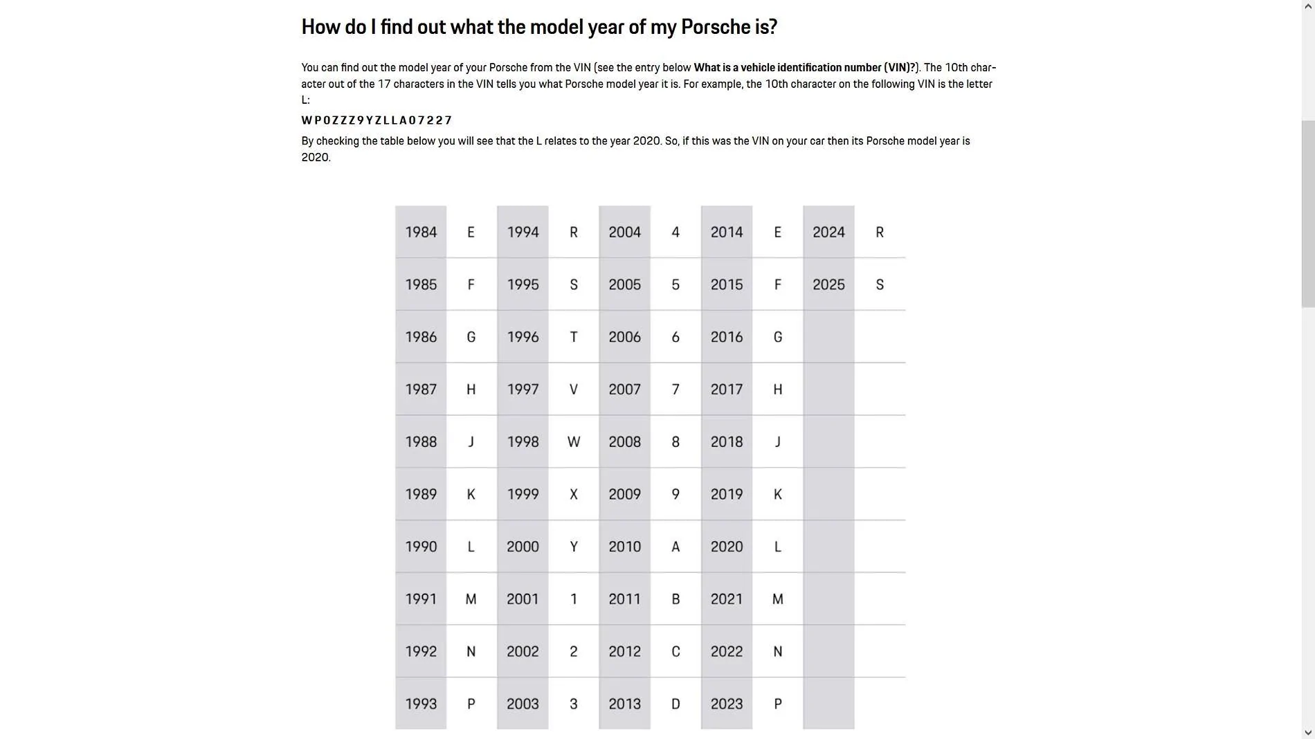

The 10th character out of the 17 characters in the VIN tells you what Porsche model year it is.
So, if the letter is S then its 2025 year.

R for my case
