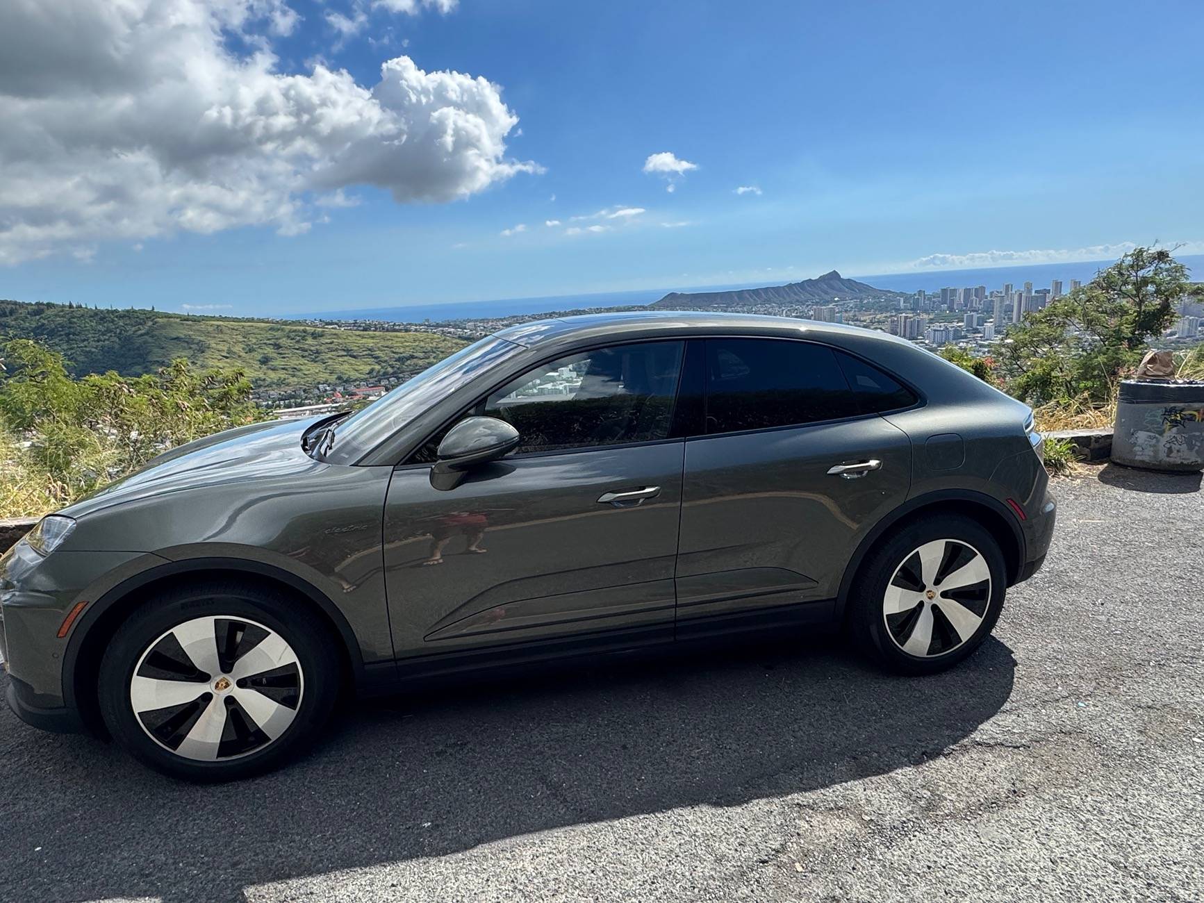

I have had my Macan 4 for a bout a month. Where we live the rode is extremely bumpy, windy and full of potholes. Because of the road conditions, up to our house I opted for the ā€œstandardā€ 20’ wheel/tire setup. What I’m trying to figure out is why the Turbo Macan and another Macan 4 with the 21ā€ wheels were dramatically smoother on the same road as my Macan 4 with the 20ā€ wheels. Tiresā€ the nasty rock hard Pirrellis on th3e 20ā€ vs the Michelins on the 21ā€? What I have noticed is in ā€Sportā€ and ā€˜Sport Plusā€ the ride seems to be smoother - which is counter intuitive. My prior Macan GTS had the air suspension was was definitely smoother. Any feedback would be great!
