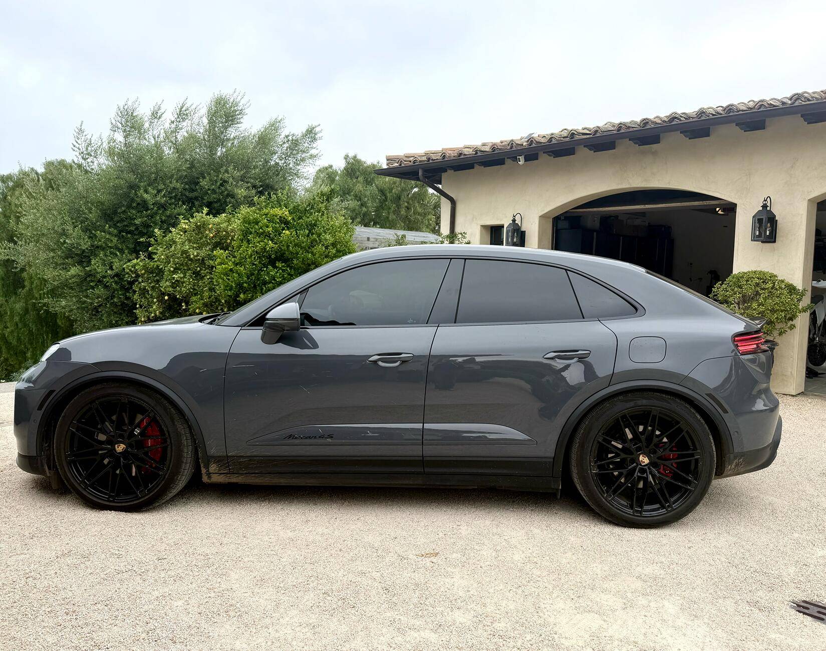

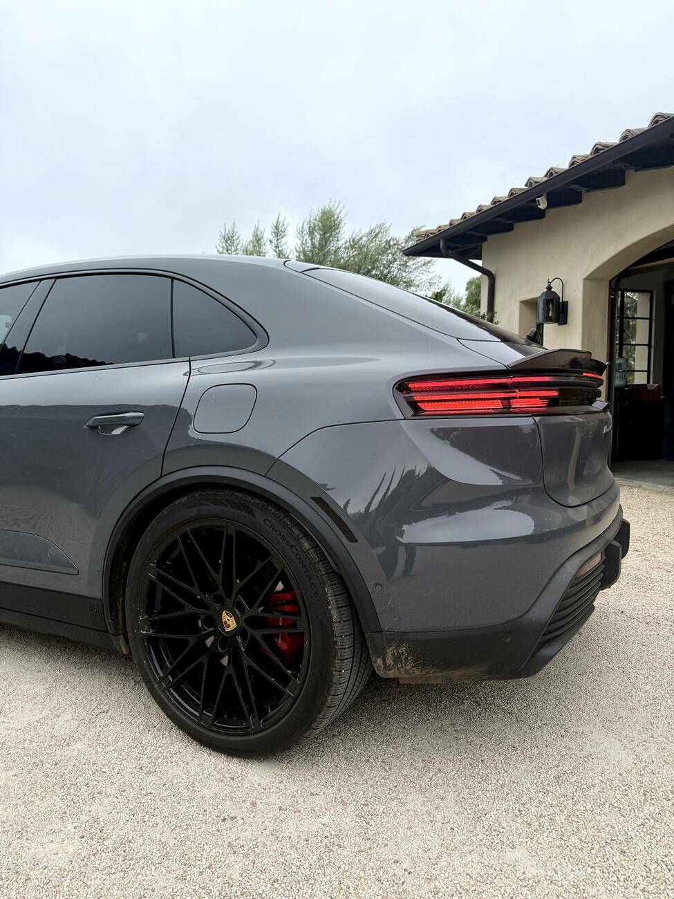

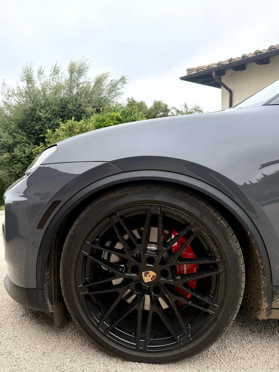

I installed the lowering links last night. Not very hard, but a pain. The rear ones you can either take the back tire off and reach them quite easily or you can put the car in "off-road mode" and slide under. I ended up doing that after taking one tire off.
The front ones are easier to reach and no need to remove the tire. I will take some measurements later, but here are some photos in sport + mode which is set to lower the suspension as low as it goes. Normal mode is a bit higher.
The instructions were useless, but shortening the lowering link lowered the front and increasing the lowering link in the rear lowered it I think? GF has the car for the day, but I'll post more when I get it back.
The shape of the rear lowering link is a bit different than stock and it is confusing which way to face it. This will make more sense when I add photos or you get both off and you are looking at them.

Unless I’m going senile which I could be, I had the rears at the short setting to start and it looked like a stink bug. So I went full opposite and it dropped and inch.
Start with the rears as short as they get and see where you’re at, but I’m pretty sure you’ll need to lengthen them, it makes no sense. Also, each clip has a little safety pins on them that you need to take out when you put it on. I tried forcing it on for a while before I realize that.
You’ll probably have to play with the length a couple times, so don’t put the safety pins back in until you’re all done with it. You can drive forward a couple miles an hour so it levels out and play around with the different suspension settings.

yeah, you were correct.
it seems the rear needs to be lengthened to lower the car.

Which way did you end up facing the curve? Kind of weird how it can go either way and neither way is how it is stock. I Had each } towards each other

Yes kinda disappointing that he wasn't able to replicate the OE bend. I too have the apex pointed inward. The other way has too much contact against the control arm.
