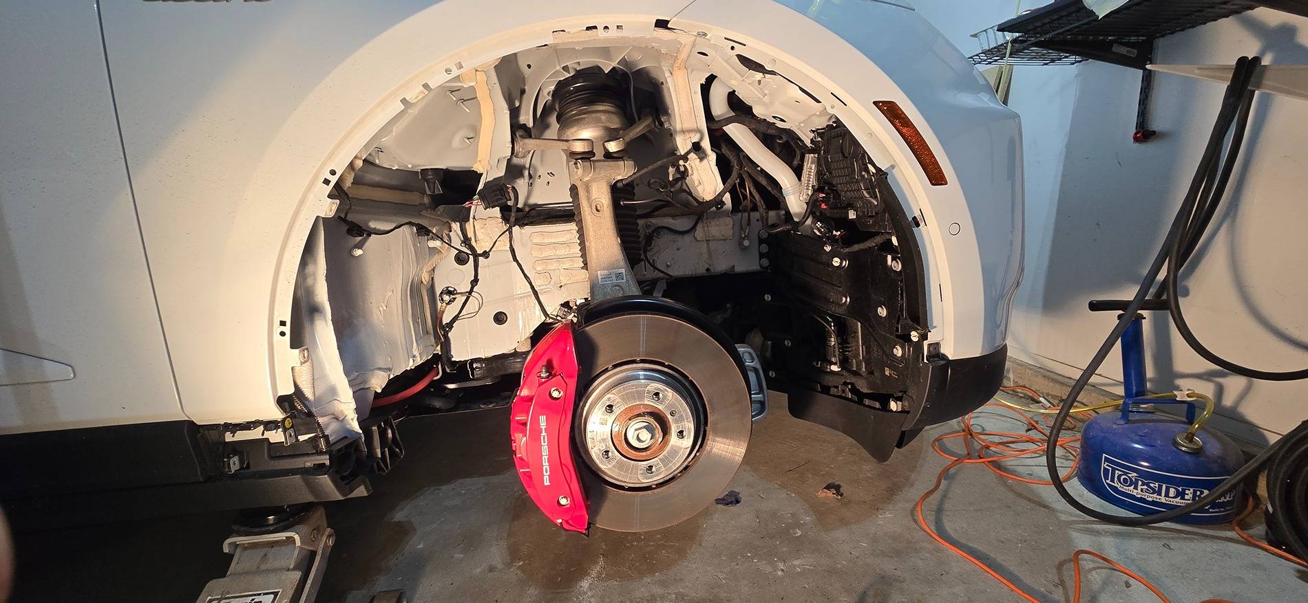

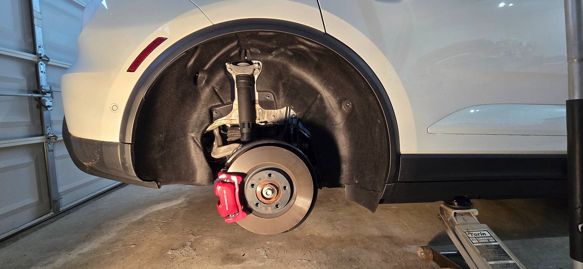

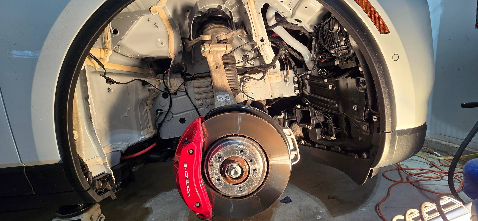

so i was able to start this today. I finished one side and i'm going to do the other side tomorrow.
it was relatively easy. Nothing but torx screws and bolts. There wasn't much to see in there...but there were a few interesting items.
The front fender liner is attached with:
20 x T25 screws
3 x 10mm plastic bolts
the fender itself is held on with:
4 x T20 screws
4 x 10 mm plastic bolts
I wasn't sure why new fender liners were supplied, it appears that difference in size is made up by the cheaper felt liner, vs the plastic. The part numbers for the liners were different as well.
I removed the entire fender liner, and then removed the fenders.

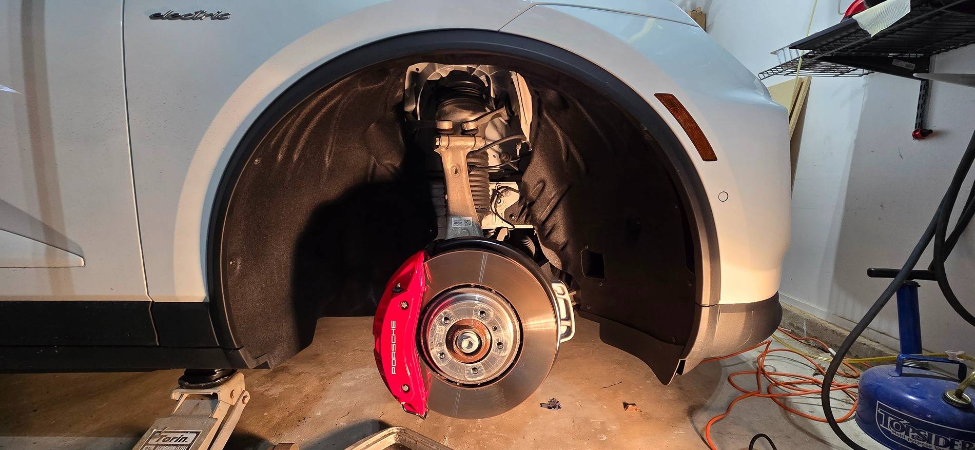

this is starting. using the Powerflex jack pad. No issues with that.
Electric Macan EV Wheel arch extensions 20250405_105907
Liner Removed
Electric Macan EV Wheel arch extensions 20250405_112049

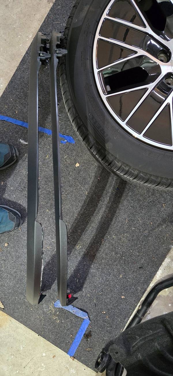

Side by side of the Front fenders
Electric Macan EV Wheel arch extensions 20250405_114052
Everything off at this point
Electric Macan EV Wheel arch extensions 20250405_114147

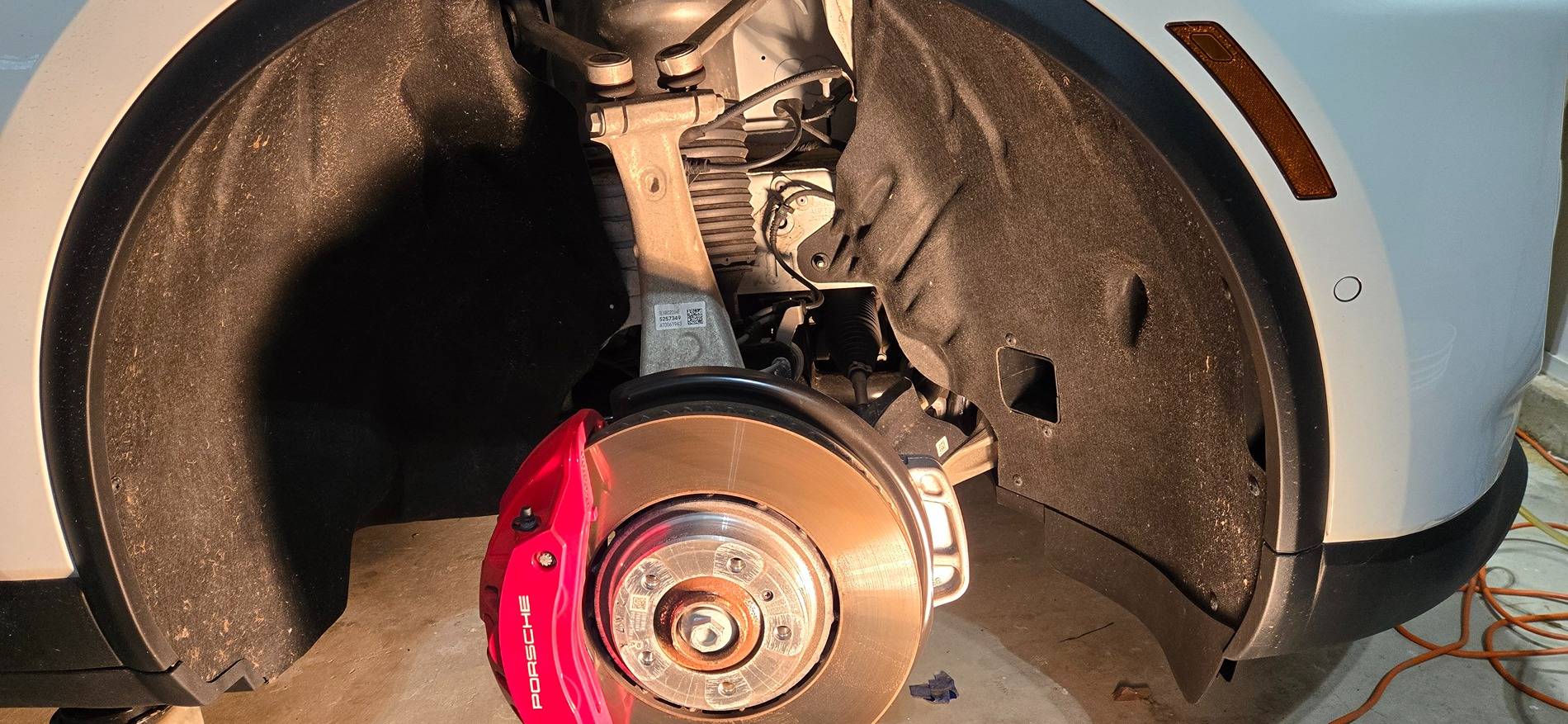

Everything back on
Electric Macan EV Wheel arch extensions 20250405_122334

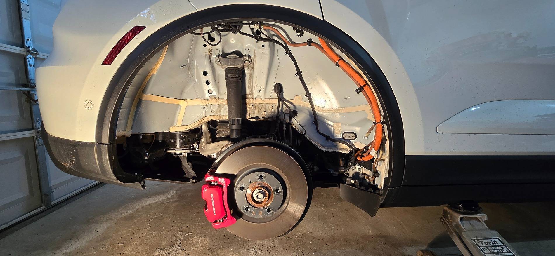

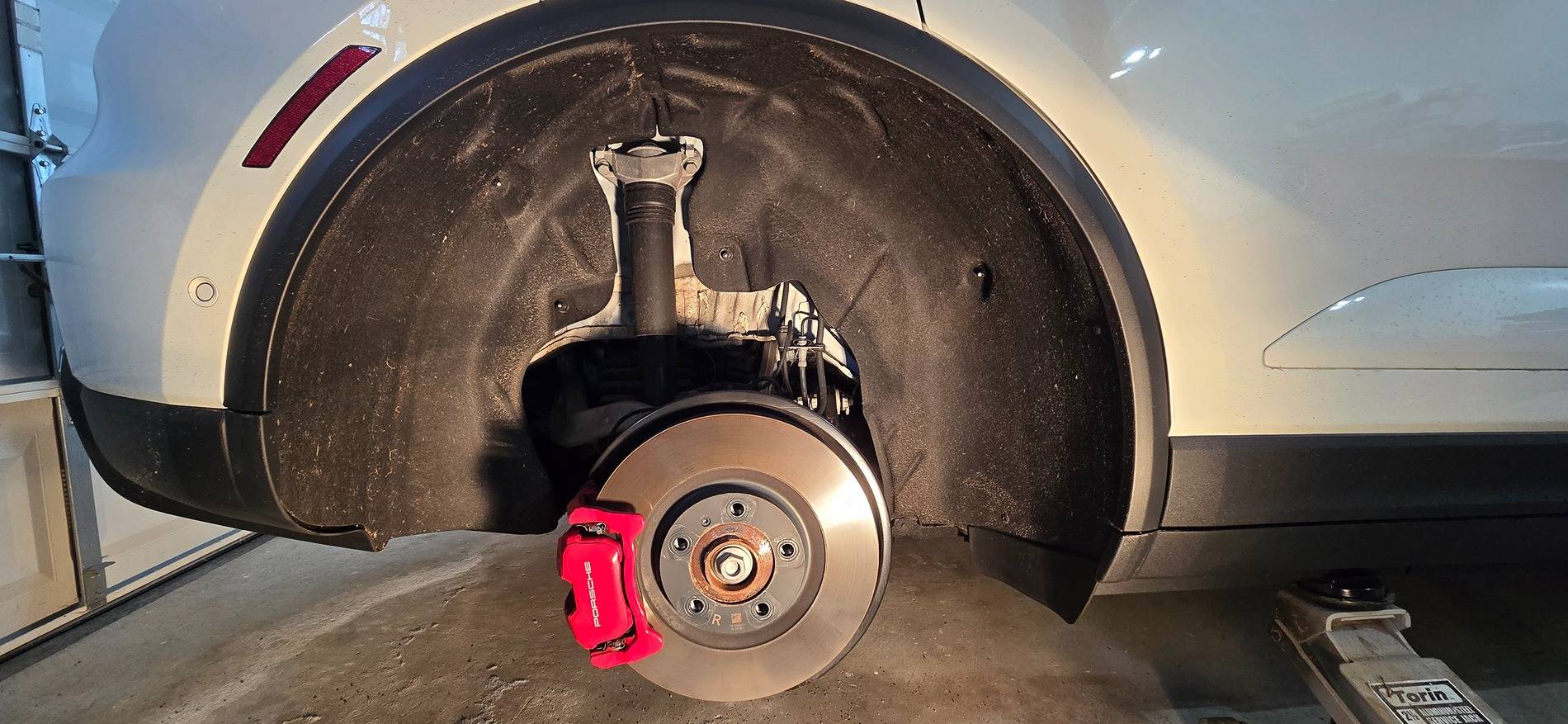

The rear was a similar procedure, but ended up being a lil more difficult because of the fender liner bolts...
the rear Liner uses
11 x T25 screws
4 x 10mm plastic bolts
rear liner uses
3 T20 screws
2 10 mm plastic bolts
NOTE: that the wider fenders have different bolting mechanism. Instead of using the plastic bolts, the new wider fenders use ONLY screws! meaning reusing the hardware, you will be short 2 screws for each fender. I just happen to have similar hardware lying around.
Start
Electric Macan EV Wheel arch extensions 20250405_144738
Liner removed
Electric Macan EV Wheel arch extensions 20250405_145916
everything off
Electric Macan EV Wheel arch extensions 20250405_152414
Fender side by side:
Electric Macan EV Wheel arch extensions 20250405_152240

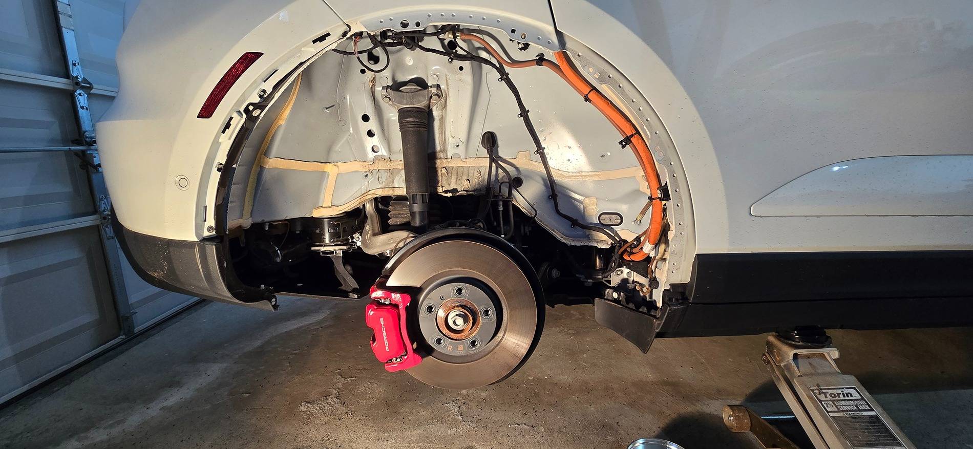

everything on:
Electric Macan EV Wheel arch extensions 20250405_160831

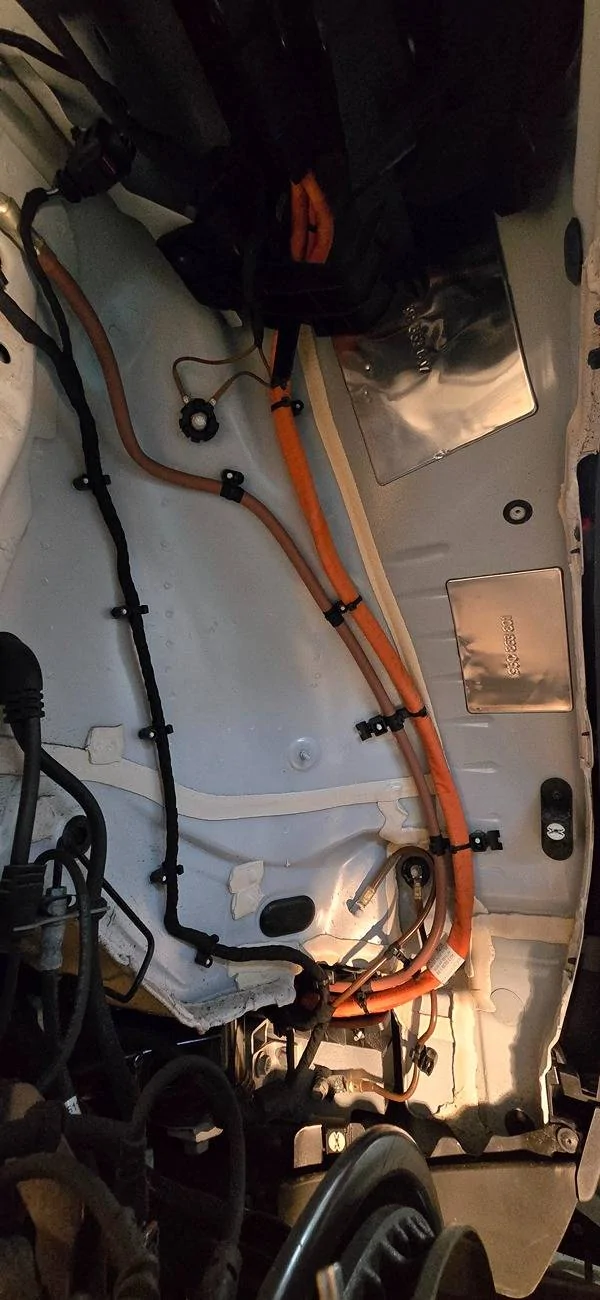

interesting things i noticed:
inside the rear wheel well..once you take off the liner, the whole charging assembly is accessible. I didn't see any adjustment mechanism...however.
also inside the rear, these silver patches caught my eye...They appear to be just stuck on to the car...whatever these are, some of the corners weren't adhered anymore... i just them back down...but i'm very curious as to what their purpose is...
Electric Macan EV Wheel arch extensions 20250405_151041
Looks like the silver material could be sound deadener (eg Dynamat)
