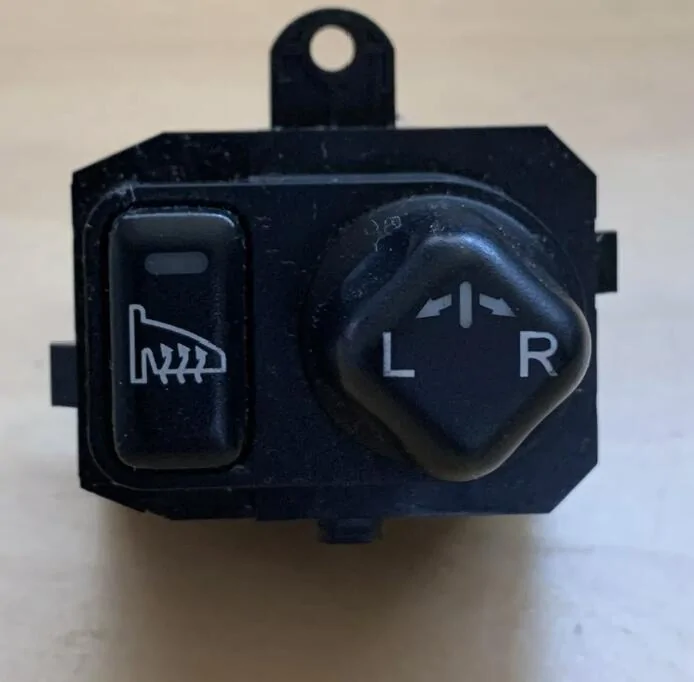

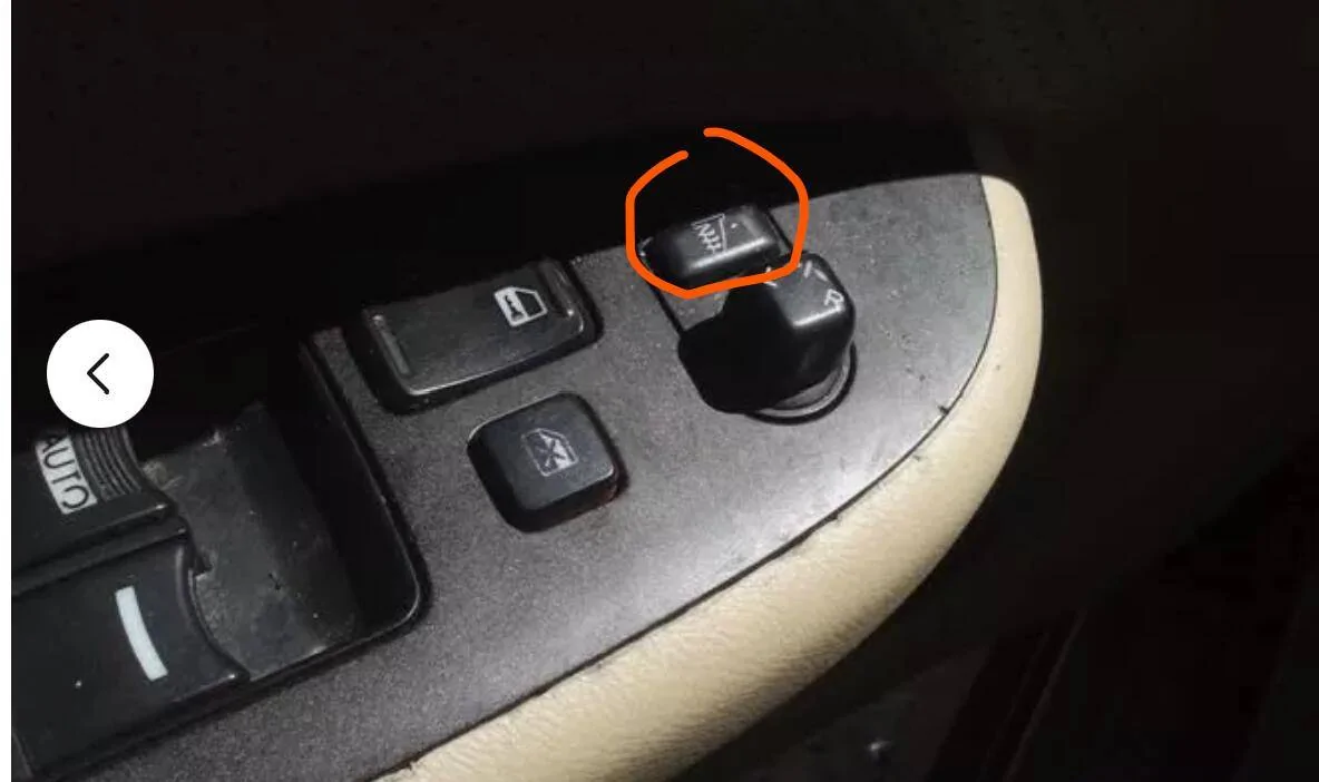

never seen a car that had a specific mirror heat button personally...
There are cars. This is a thing on Honda and Acura cars. 2008 Acura TSX came with dedicated heated mirror button. Porsche does not have a dedicated button as it is tied to the Rear Defroster button as @Go4it mentioned, and always has been that way.
Acura Heated Mirror button.
