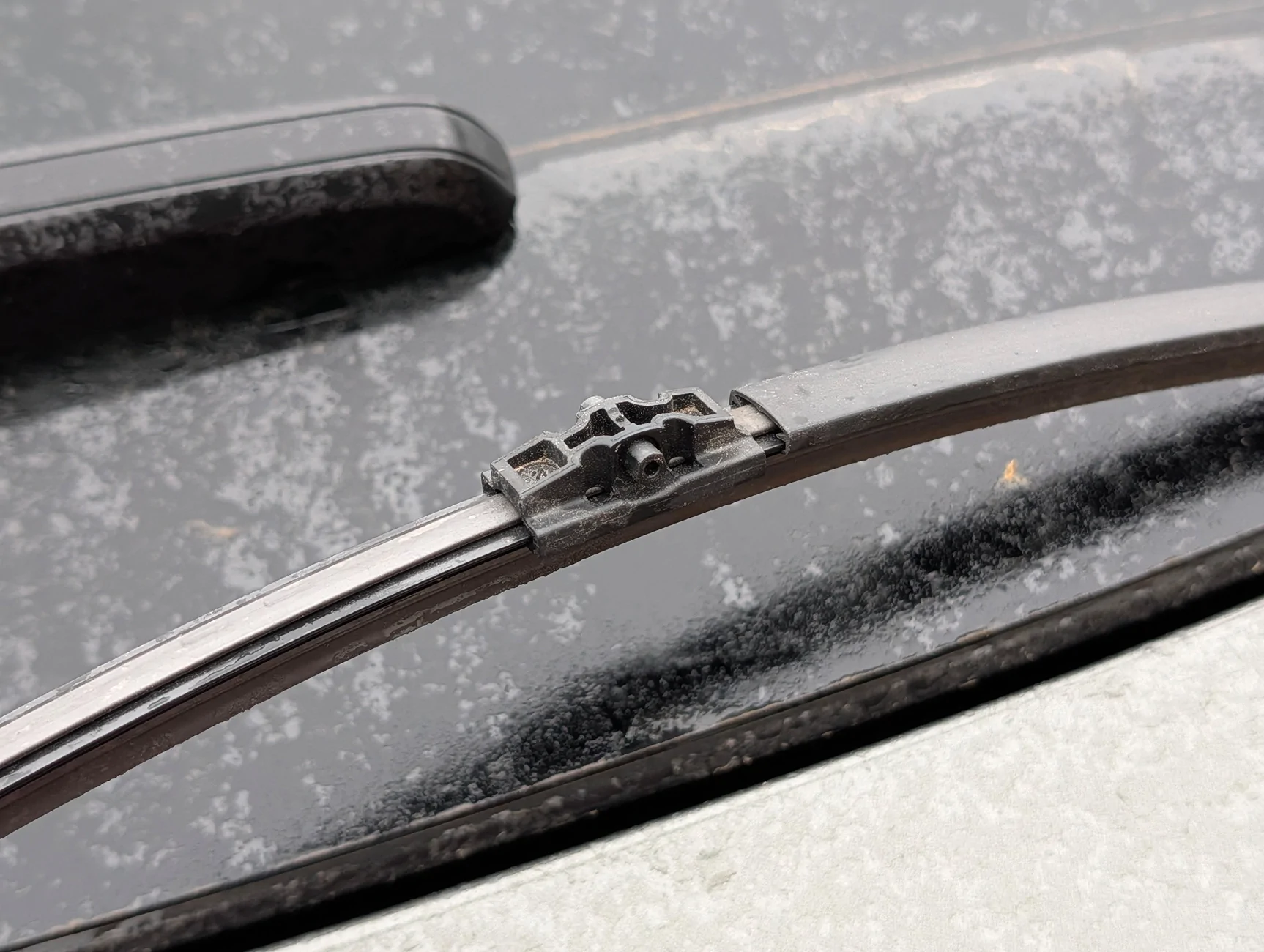

Electric Macan EV Rear Wiper Replacement PXL_20260411_084313326

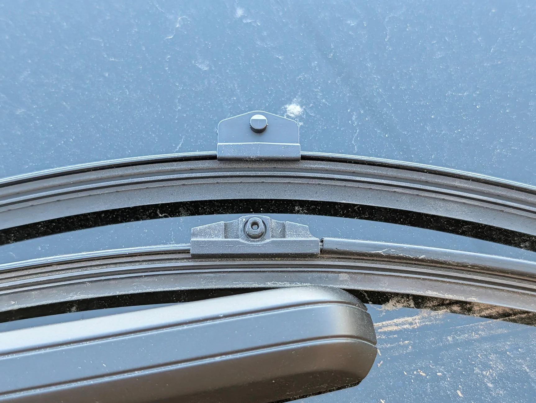

Electric Macan EV Rear Wiper Replacement PXL_20260416_173456019

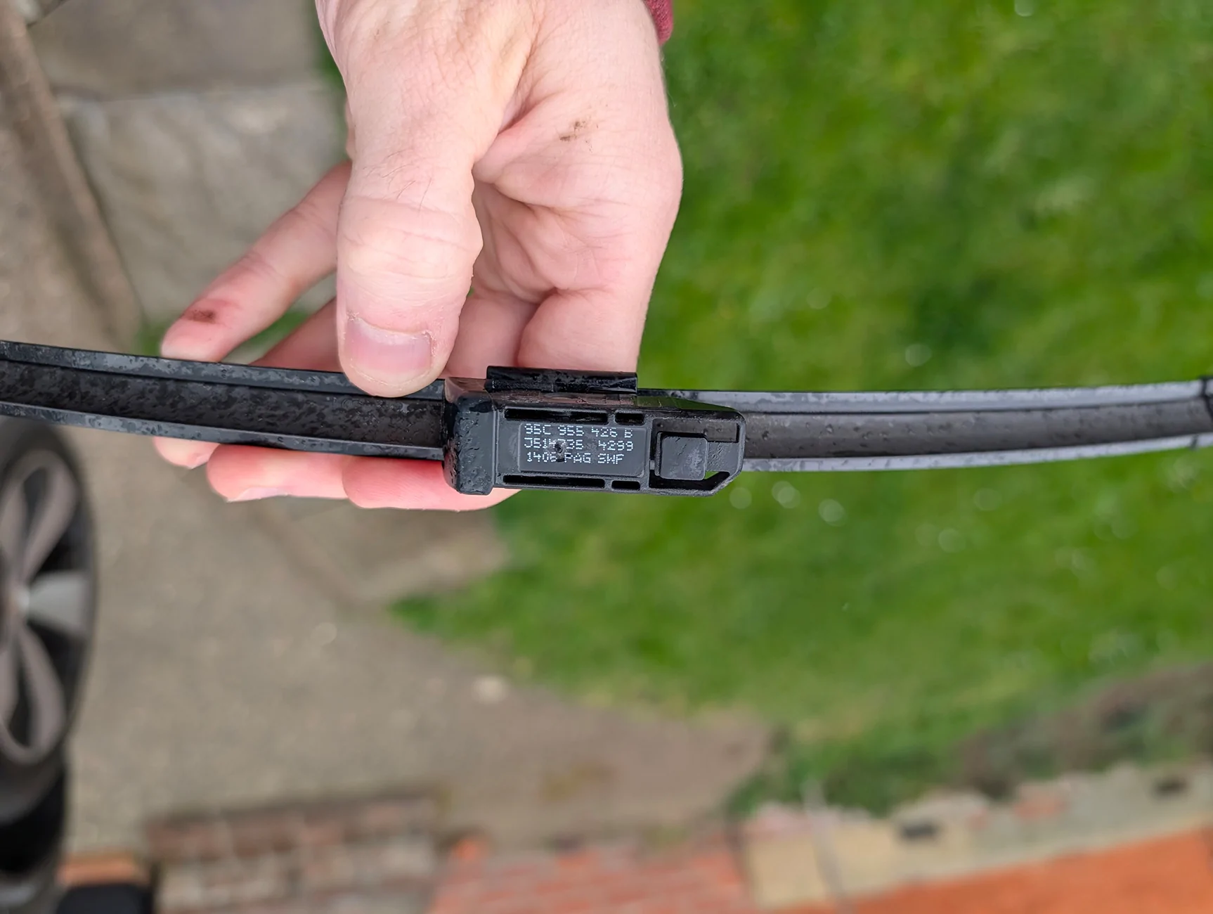

Electric Macan EV Rear Wiper Replacement PXL_20260411_085145109~2
