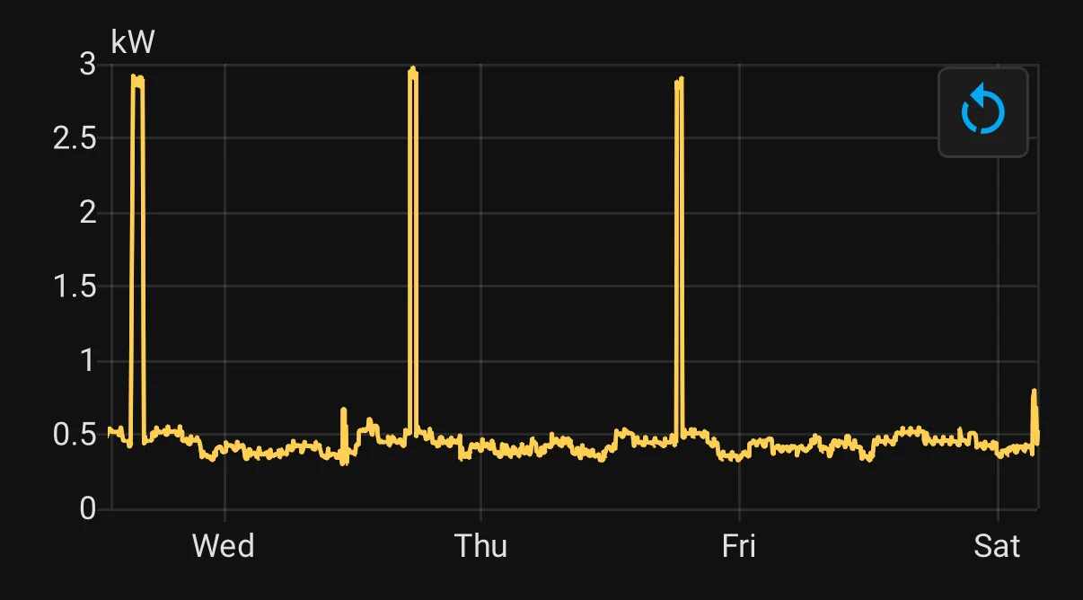

Amazing levels of certainty here. Sorry if I don’t take your word for it. I’m an experienced engineer that’s worked on plenty of similar systems. Things don’t always work the way you expect. Polling for status is a pretty common issue, it absolutely can drain a battery.
You are also misrepresenting what I said.
1. Before app update car was pulling the equivalent of a constant ~30w. Yes, I think that’s way too high for a modern EV. I have at least one theory on why it’s happening, but it’s unverifiable and thus not worth mentioning.
my expectation would be a max of 5w or to maintain dram and basic cellular under poor reception.
2. After the app update for at least 48 hours it was pulling the equivalent of ~60w continuous
My theory on (2) is the live activity tracker is constantly polling to ask charge status.
Where did I ever say the live activity is causing (1)?
I have no easy way to remotely diagnose (1)
for (2), I shut off the live activity tracker immediately after the last charging cycle. After the app update it was charging almost exactly every 24 hours. Since shutting off the tracker it’s already exceeded 24 hours and no charging as of yet. That fully supports my theory. Next I’ll wait for the next charge cycle to calculate the power/ energy usage.with the expectation it’s returned to (1). Assuming my theory is correct, I’ll re enable the tracker and see if the increased power draw returns.
Assuming all my experiments meet expectations then it’s enough data for me to at least report it to Porsche.
I’ll ask the dealer about (1) and see what they say after I get back. My expectation is they will say it’s normal. That’s pretty much what they always do.

I never wanted to discuss the 30w *equivalent* base draw. My original post was about the app update. Since the update , I’ve noticed frequent 24 hour charging, regardless of draw that’s unusual.
Note the word “equivalent “. I’m assuming any power usage is due to a parasitic loss. No way to prove that either
the point of my post is the amount of energy being used when offf and plugged in to maintain the state after the app update doubled. Guess I’m the only one who is experiencing it.
As to if it’s some sort of conditioning cycle…
The car should not be reporting it as charging if it were doing some sort of conditioning, but that could just be wonky German engineering. I have seen it specifically report a lower state of charge when charging. But even that could be just off German way of reporting it. I have no way to prove it’s actually consuming the energy for charging. and of course this is orthogonal to why energy usage doubled.
Well over 24 hours now since I shut off the live tracker and still no charge cycle or change in state of charge. The increased energy usage/frequency of charge cycles has magically disappeared.

The car has been parked since July 3rd. That seems like plenty of time to establish a baseline before the app update.
The only interesting thing that happened before the app update was it switched from 9.8kw charging to to 2.5kw charging around week 3.
