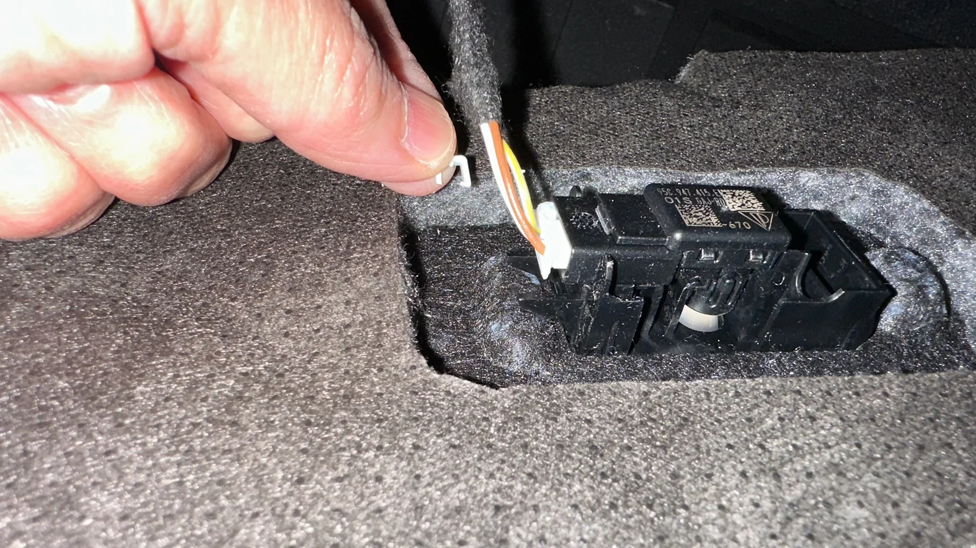

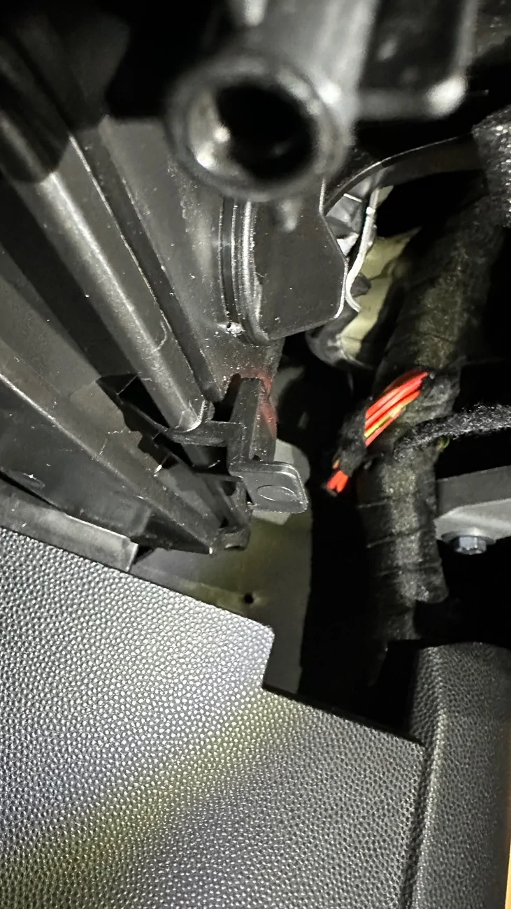

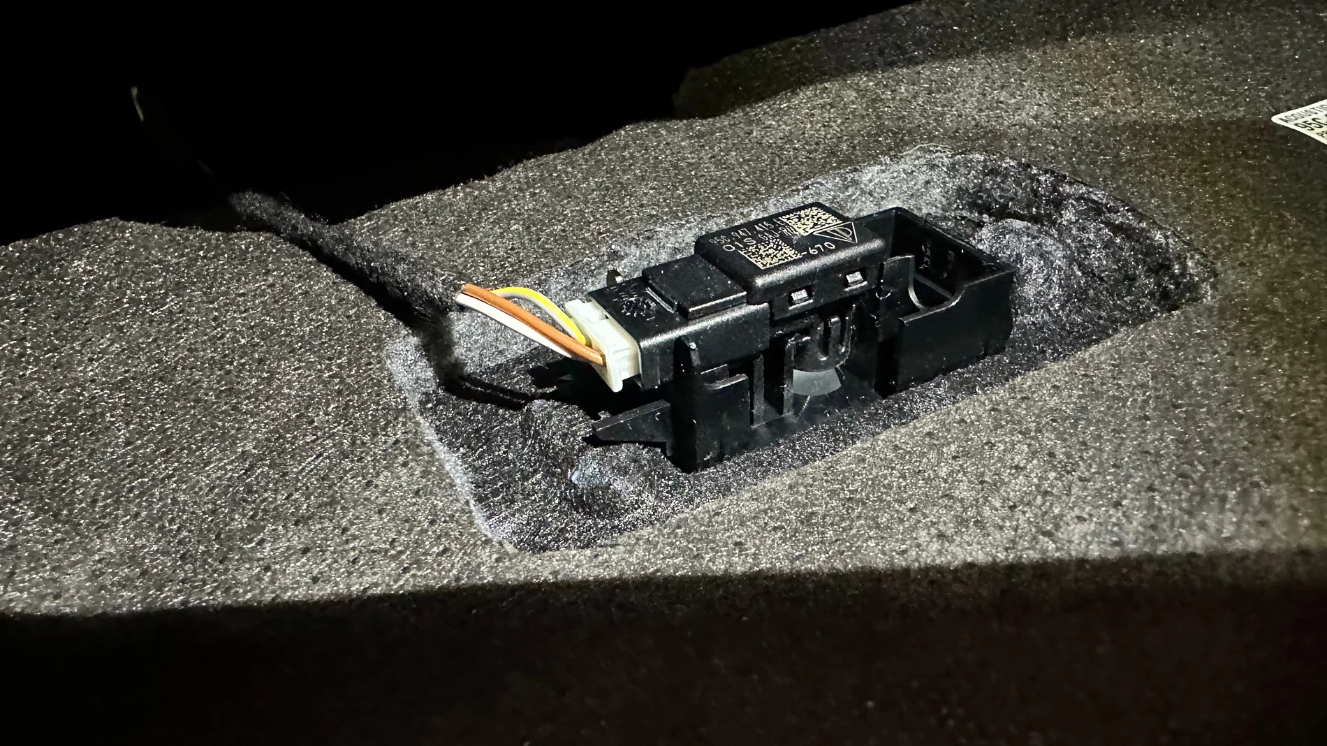

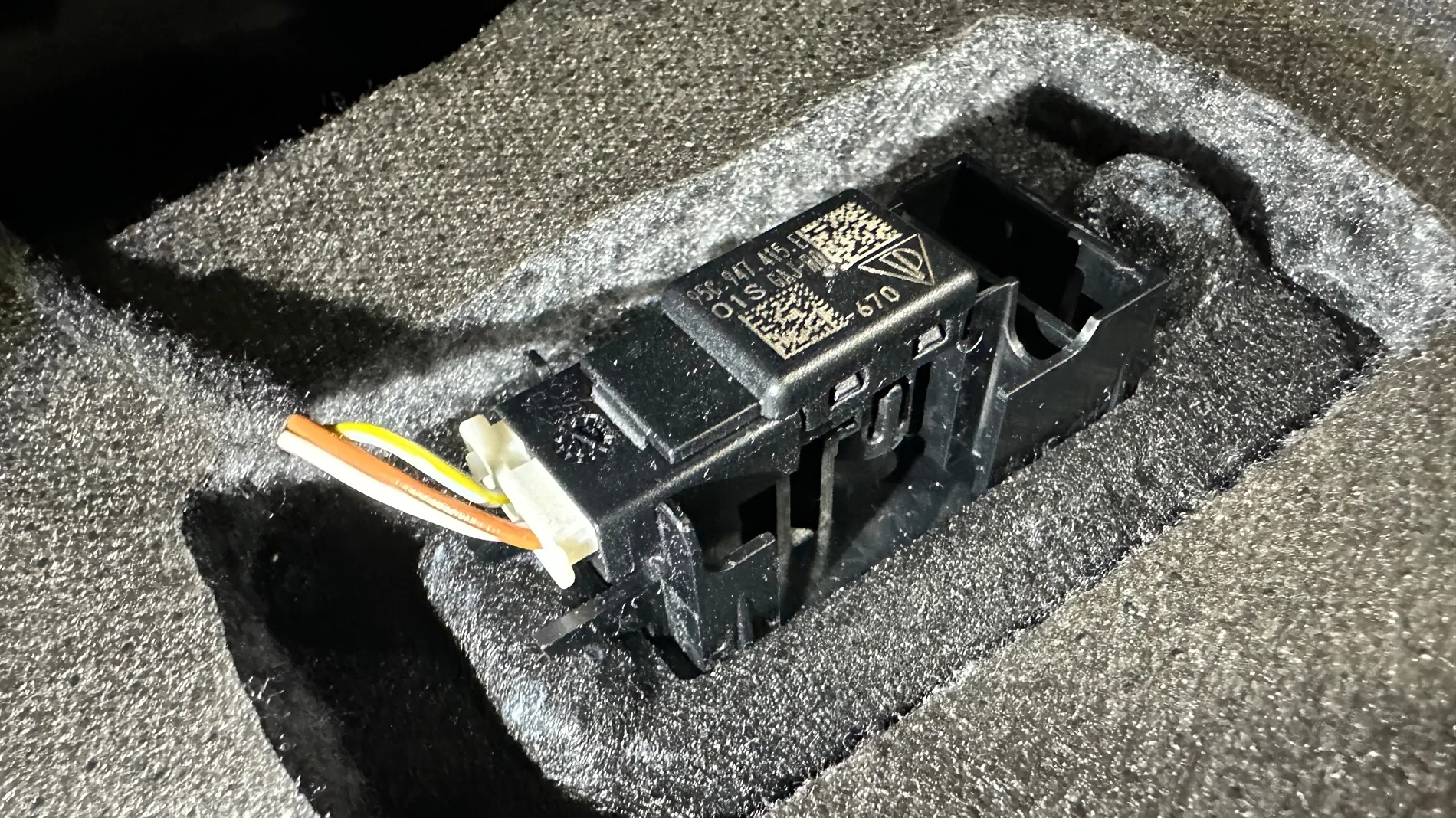

Anyone know how to disconnect this? I got as far as this but can’t pull this connector out.
Electric Macan EV DIY Cabin filter and windshield wiper blades replacement IMG_9088
Electric Macan EV DIY Cabin filter and windshield wiper blades replacement IMG_9087
okay managed to pull it out, but the side snapped 😅
Now I am not sure how to remove the cover. Do I need to unscrew something? Because watching the video for the Taycan, he didn’t seem to need unscrewing anything and I can’t see what tab he removed. Everything seems tight and doesn’t come out easily. @pm4s

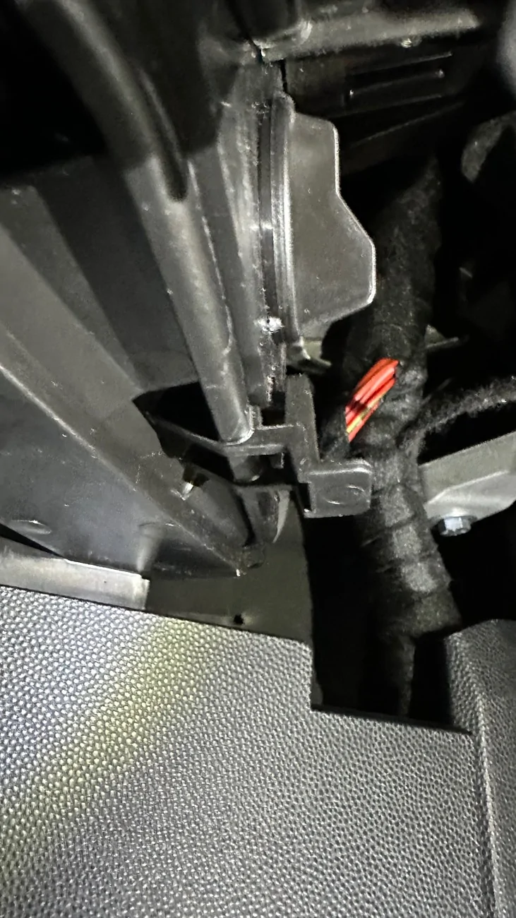

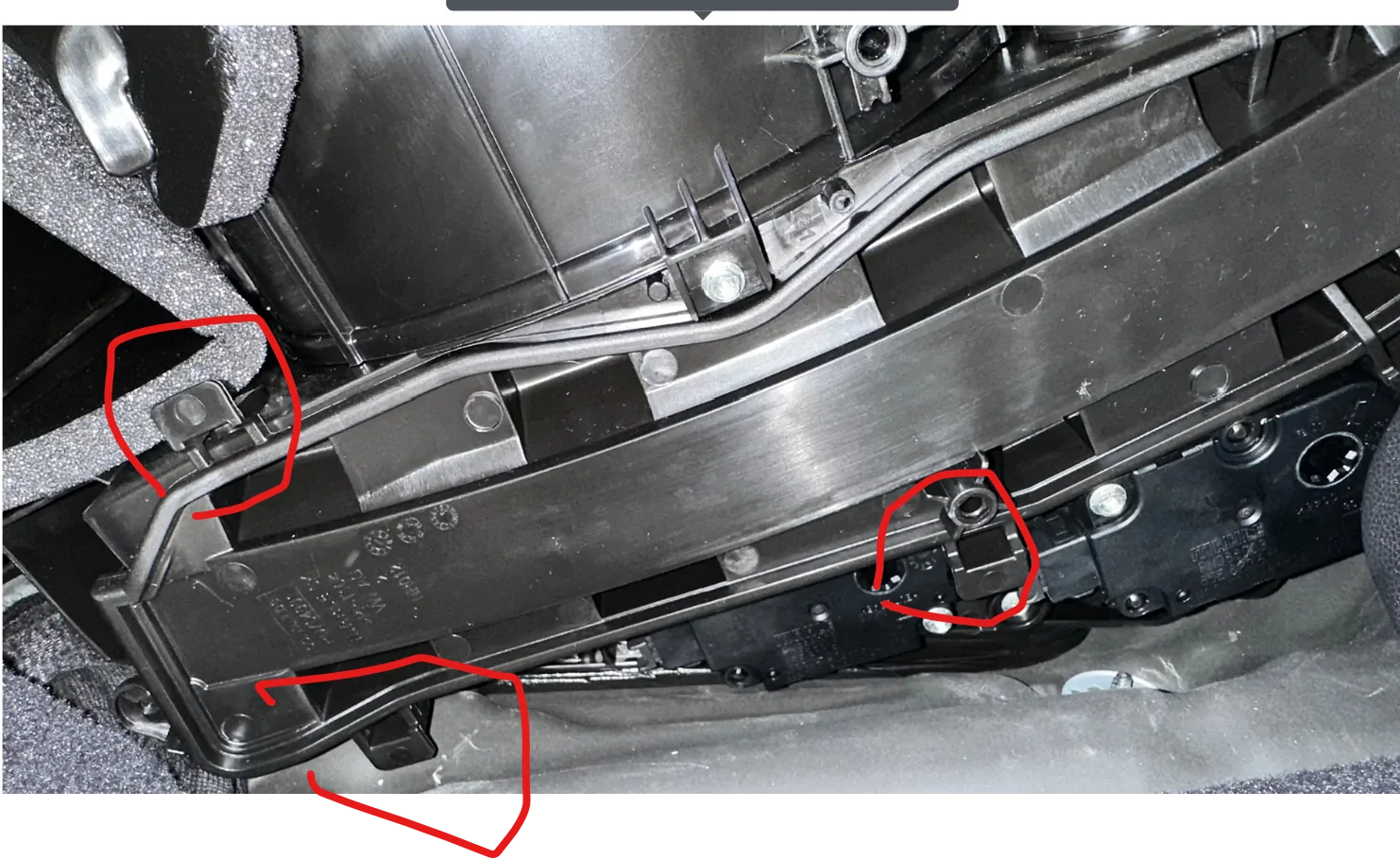

Electric Macan EV DIY Cabin filter and windshield wiper blades replacement IMG_9089
Electric Macan EV DIY Cabin filter and windshield wiper blades replacement IMG_9095
439
436
^Looks like a snap off cover like in the Taycan.
SergeyIndy in the post above circled the tabs, carefully release them (don't snap them off) and cover will come right off, there is nothing to unscrew, looks to be near similar to the Taycan.
Don't worry about snapping the connector, it's just the footwell light, and you can't see it once it's back on, it will hold fine.

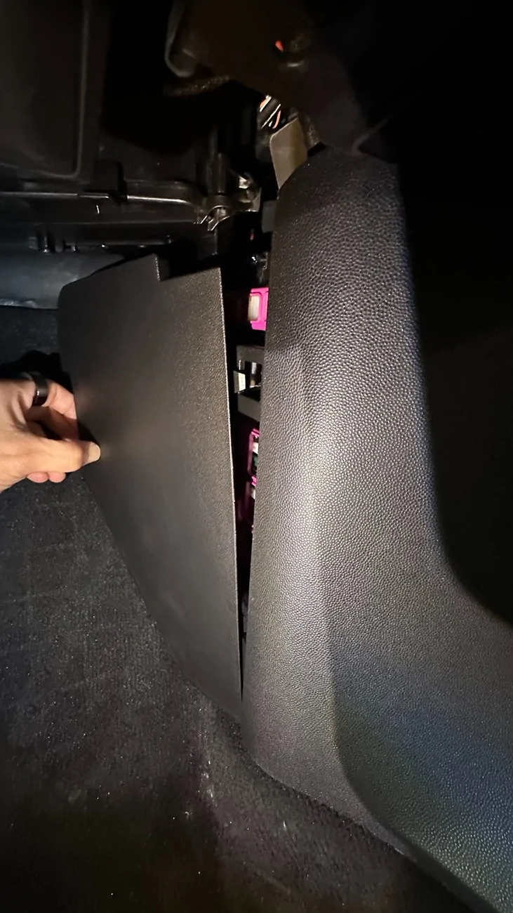

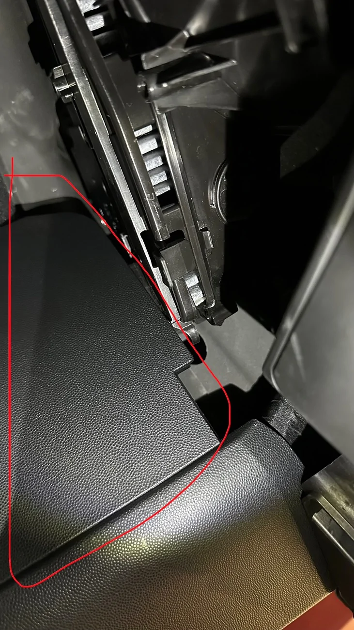

I managed to snap it off. It is pull down. But now. This side panel is in the way. I don’t remember Taycan video or ICE macan having this panel in the way. Not sure how to remove this. Don’t want to pull to hard and break it accidentally.

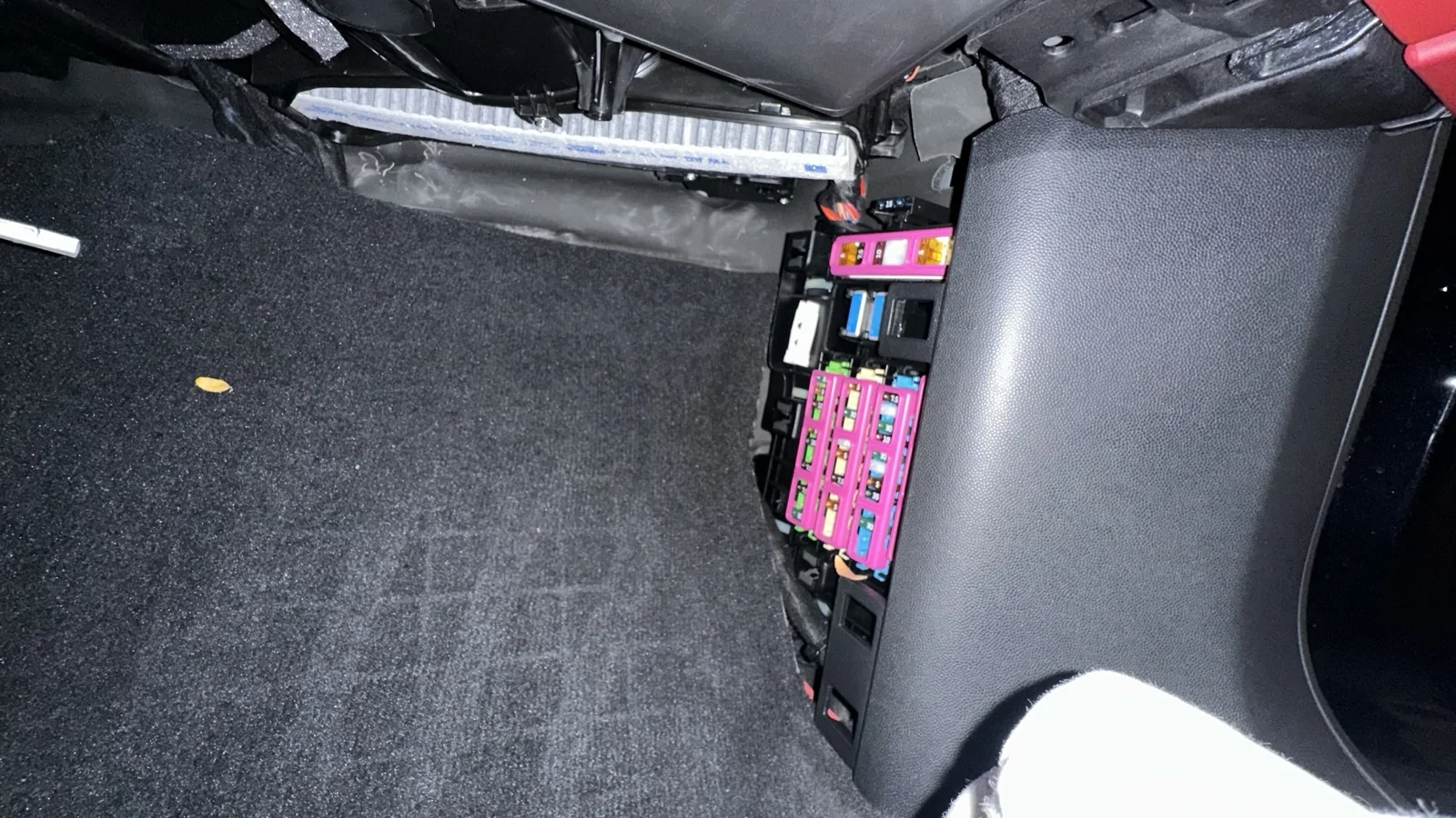

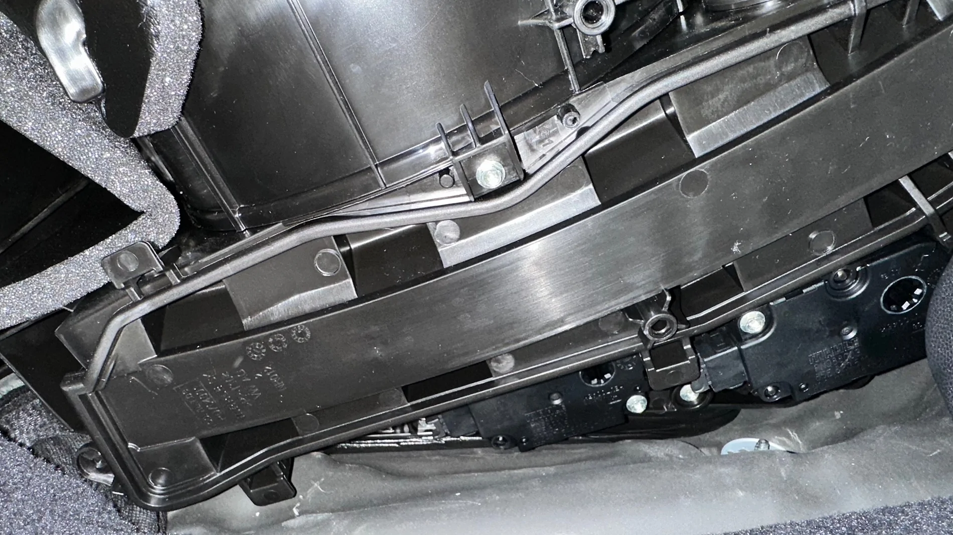

Alright I finally got it opened. Just pull the flap out from the cutout in the back.
Electric Macan EV DIY Cabin filter and windshield wiper blades replacement IMG_9136
Electric Macan EV DIY Cabin filter and windshield wiper blades replacement IMG_9132

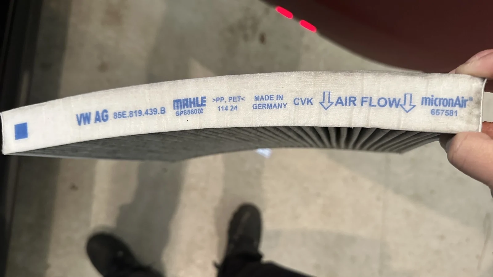

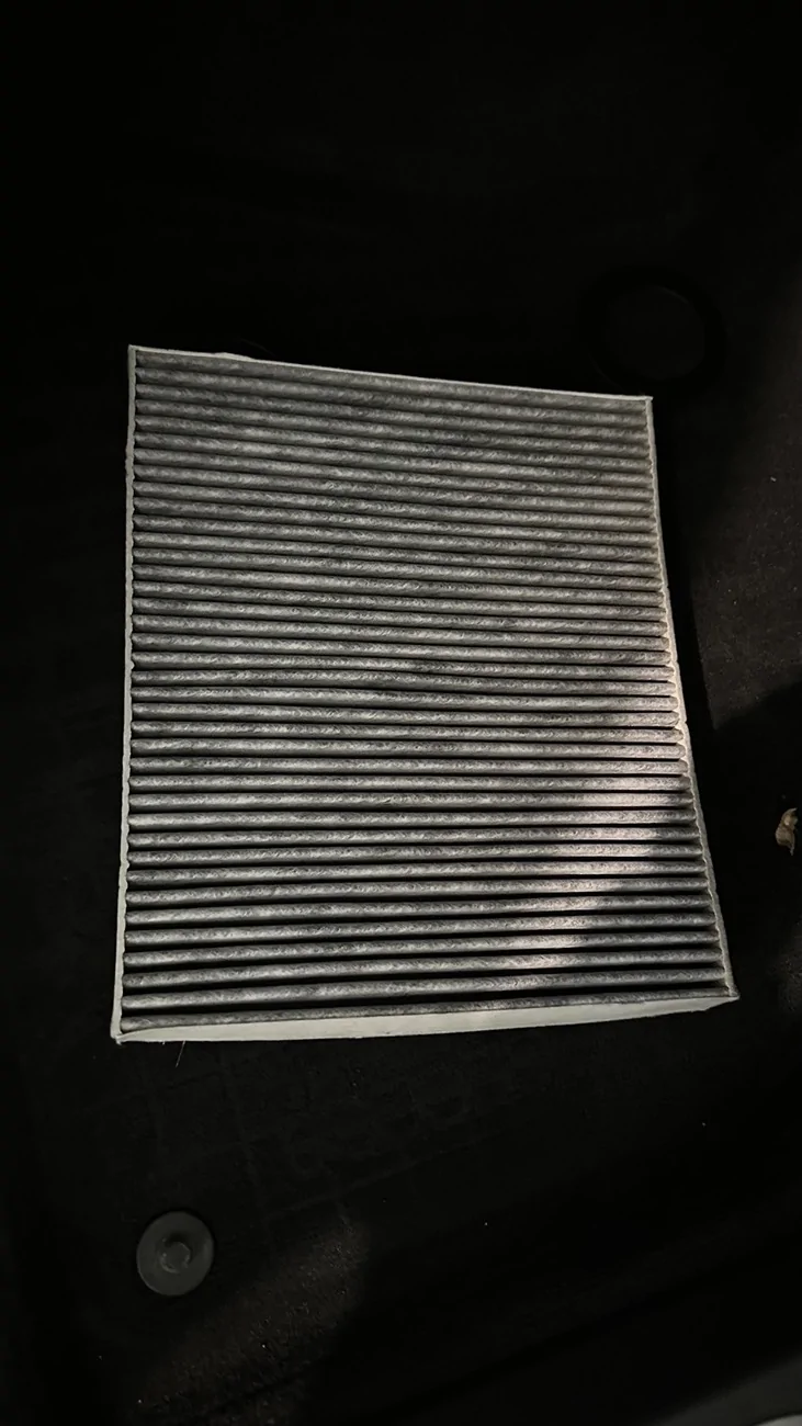

Here is what the filter looks like. So the filter PureFlow HEPA Cabin Air Filter PC6071HX would not fit it. It's shaped differently. The stock filter is MAHLE SP856002. Or maybe it's 85E.819.439.B.
Electric Macan EV DIY Cabin filter and windshield wiper blades replacement IMG_9134
Electric Macan EV DIY Cabin filter and windshield wiper blades replacement IMG_9133
Now I just gotta find an alternate 3rd party filter to replace it with.
