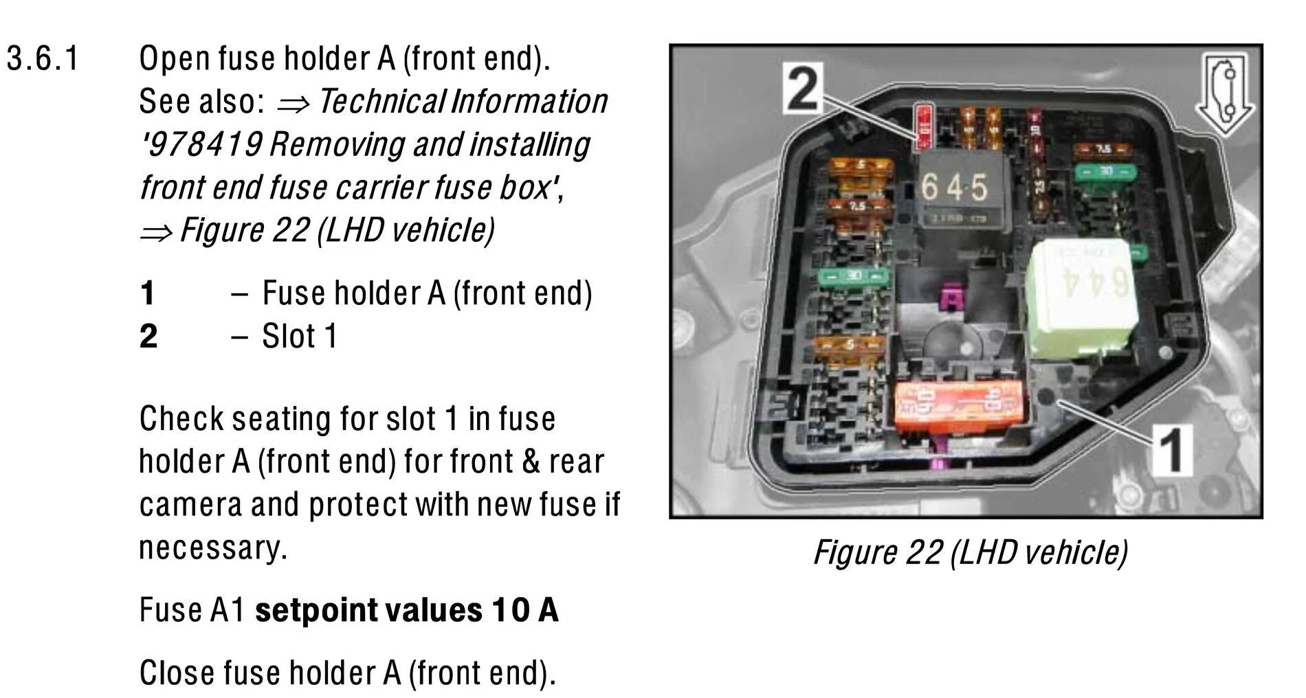

possibly in the frunk area? it does say "front end".... IDK, its in the part of the instructions where you're in the back of the vehicle though...
True but they also tell you to verify the fuses in the "fuse holder for passenger compartment A-pillar on passenger". For that fuse box they are verify specific with the location.
In the picture I do see a hydraulic hose so I can see it being located somewhere in the frunk since a lot of the hydraulic pieces live there? Either way I don't have the car yet so I can't check =\

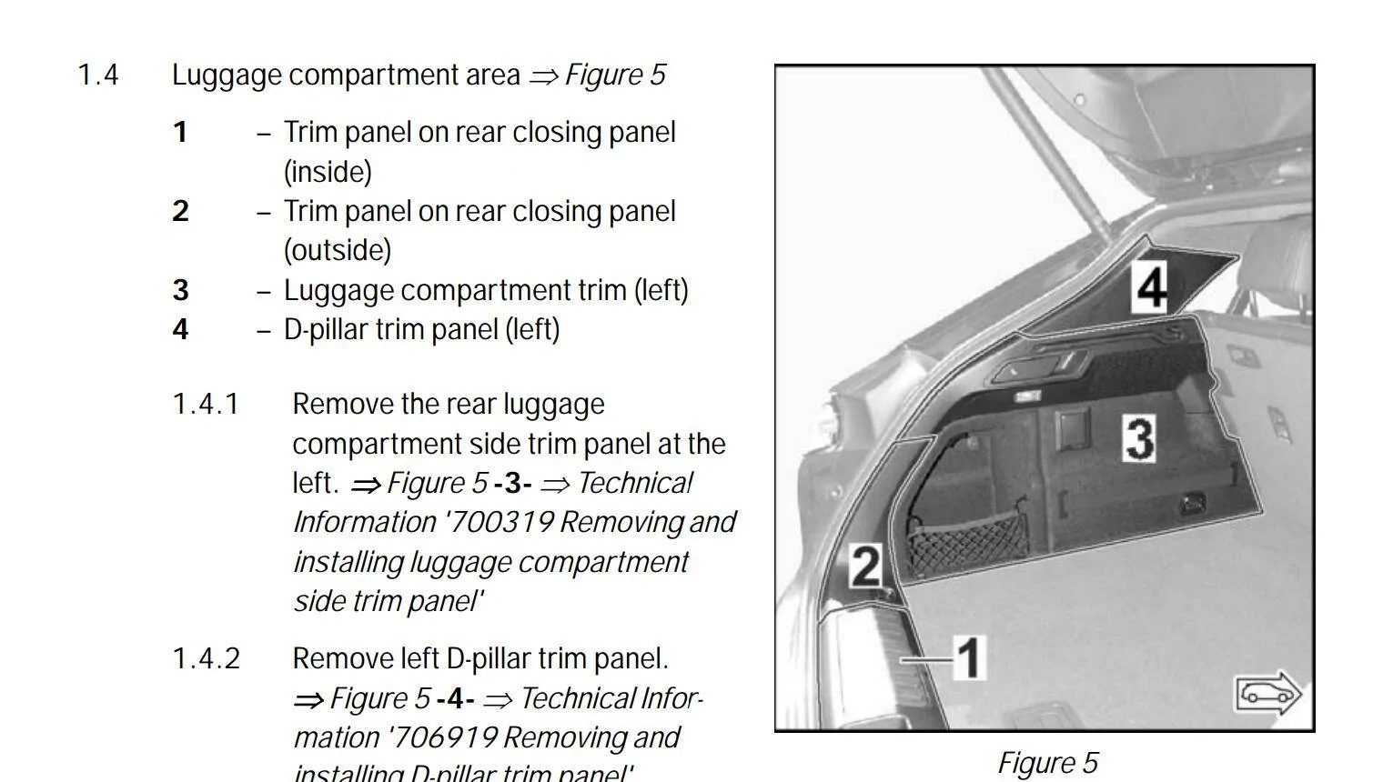

I'm going to assume it's in the back panels
If anyone is interested in pulling their back panel apart (number 3 in the picture above) and posting pictures here that would be super helpful!
