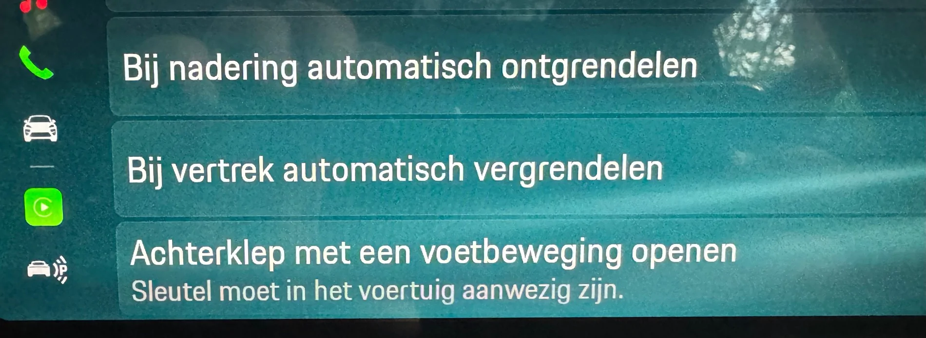

When the car is locked, you cannot open the boot. You have to unlock the car automatically first with "proximity".
This is different from my Taycan. I think the salesperson is partly right. The description in the settings is also confusing. See in Dutch: ”sleutel moet in het voertuig aanwezig zijn” = "key must be present in the vehicle".
