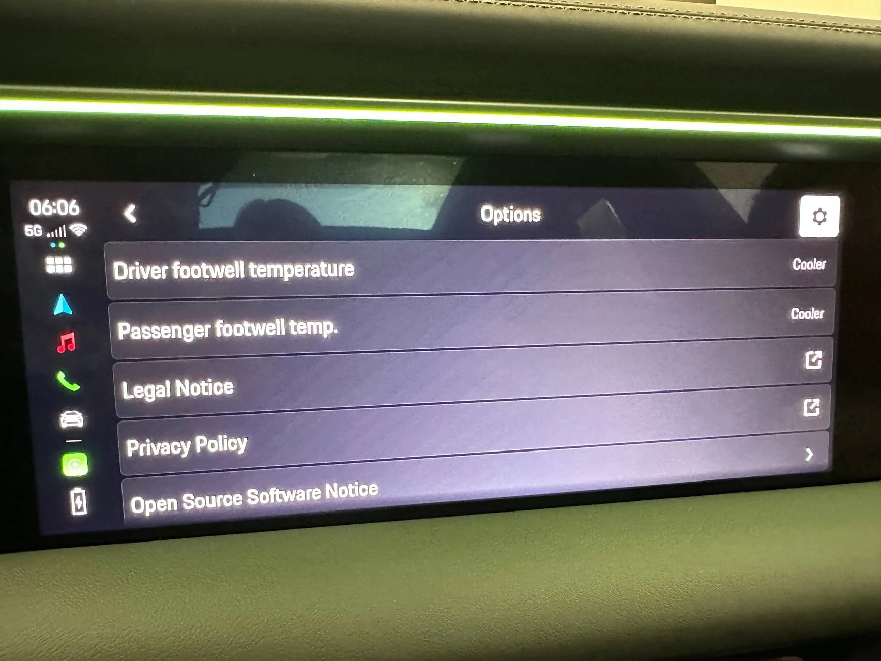

My passenger side floor vent / flapper will not close. Constantly blows air unless climate control is turned off. The up/down toggle on the center console wont turn the fan/system off on passenger side floor. I need to go through the screen menu to turn off the fan.
Climate Control button on center console does not bring up the menu on the screen intermittently when the car is powered ON. Maybe it's still loading.
Driver-side works perfectly fine but feels like there may be a lack of airflow due to the passenger-side footwell hogging all the air.
I also noticed no air is coming out from the top center of the dash next to the sports chrono/clock/compass. Regardless of setting, this vent seems to stay closed.

Have you tried adjusting through the settings (wheel cog) in the Climate Menu?

Yes, I went through that menu. Did you try it out? It doesn't change the airflow.
