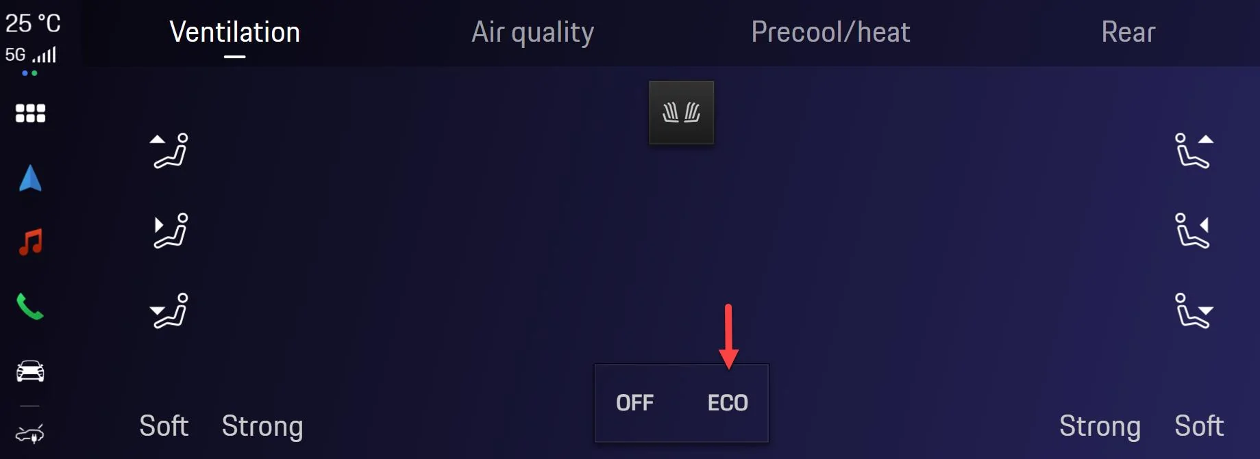

There is no info about what ECO PLUS does neither in the manual nor the app.
I asked my dealer and they don't have any info too.
Besides the behaviour is totally different from Taycan where you can set the temperature in eco mode (at least It is what they told me).
I tried several times and in my case it is not enough to keep the cabin heated (0ºC - 8ºC outside).
On the other hand, as other users said, I feel that I need more degrees in the temperature than other cars to feel more or less the same.
And yes, definitely the range impact is huge. Just try modifying step by step the temperature and you will see how the range drops. And then turn off the climate control system... you will get back huge range.

It very simple, any part of the HVAC (Heating, Ventilation & Control) will sap the battery and in particular the HV heater for the cabin climate control.
When stationary, set bring up the AC display and set to say 21C then change the AC setting from AC to ECO to OFF and each time watch what happens to the estimated range. On a full battery this can be 10+ miles (on the Taycan at least). Repeat with different temperature settings to see the effect. Over a journey therefore the HV heater consumes a lot of energy depending on settings.

Heating on, 50km less range, eco plus about 20km less range. Eco plus is just to keep windows fog free it does not really heat (sometimes it does but not reliable / minimal guess it keeps heating when I switch from heating to eco plus).
