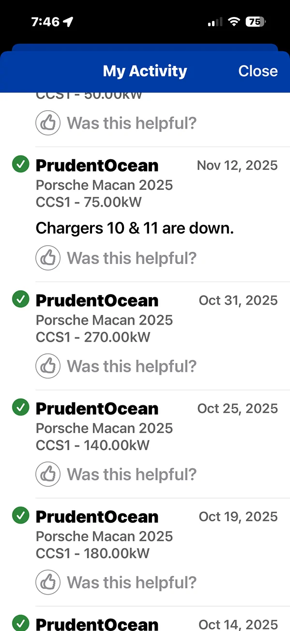

The highest speed I have seen was at my local EA — 270 kWh. It can vary significantly based on your battery’s state (SoC, temperature), ambient conditions and whether you’re on a balanced charger (one which shares circuits with an adjacent stall). It’s usually best to have no vehicles charging next to you. My local EA has twenty 350 kWh balanced chargers and typically quite busy so it's difficult to get the fastest charging speeds the Macan can achieve.
Check-ins from PlugShare:

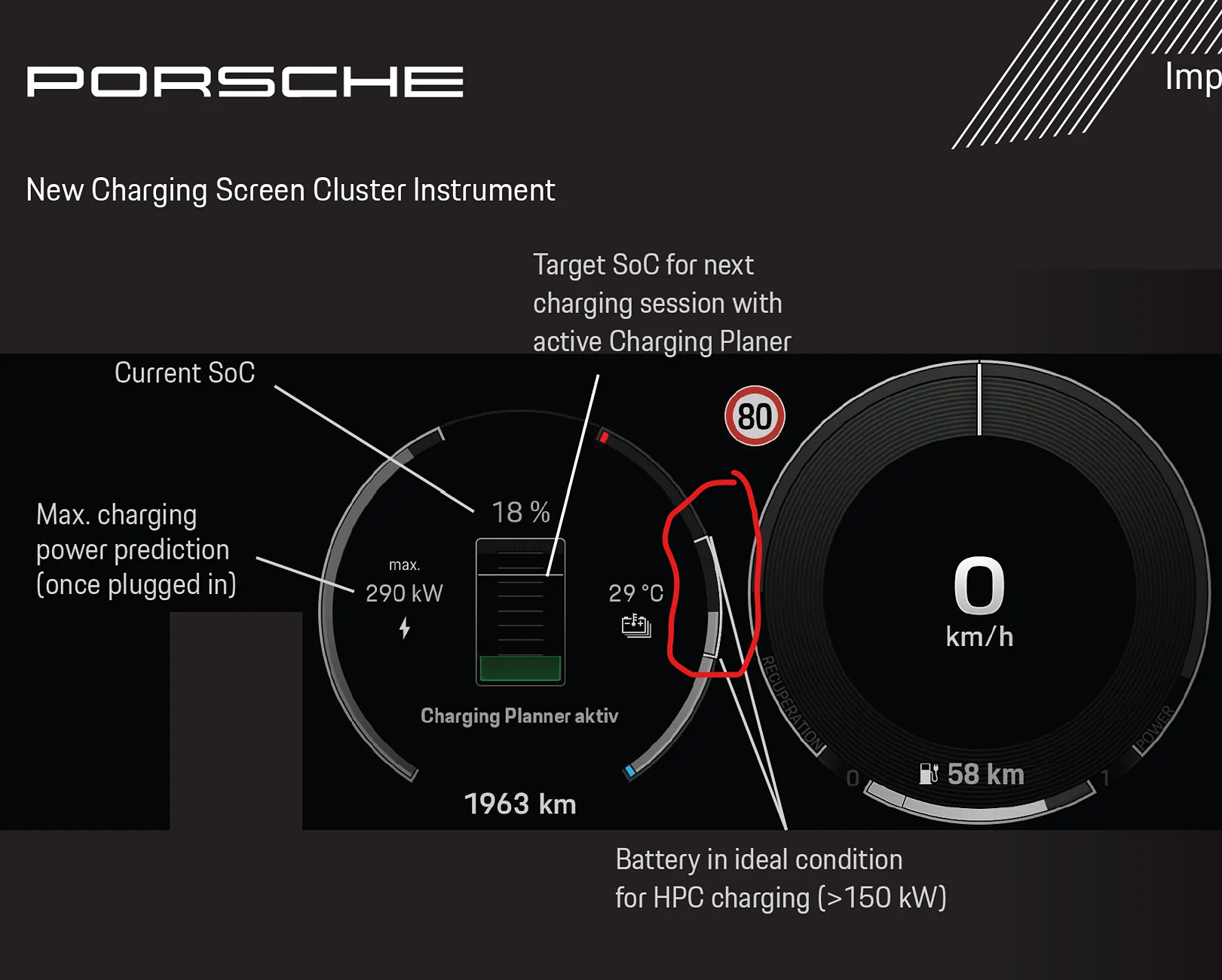

There are two possible reasons: 1) Your battery Temp and SoC are not optimal, you should see battery Temp optimal on the left tube battery screen when the right side of the ring level is within the bracket (battery is preheated when nav is pointed to the charger) and also SoC should be low. 2) Your OBC (on board charger) or PDU (power distribution unit) is bad.
This is from Taycan, but same concept of battery indicator in ideal temp to accept peak fast charge:
