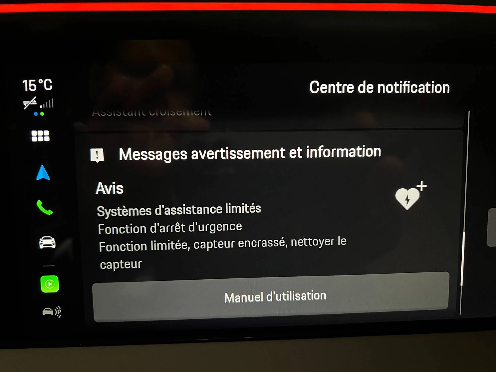

My turn: assistance system warnings, so no ACC and all that security stuff
The notification asks me to clean the sensors “capteurs encrassés, nettoyer le capteur” but everything is clean.
I’ve tried to reboot (30s volume push), close the car, wait a long time, and so on.
When I start the car, the warnings appear again within 10s. I didn’t try (yet) the factory reset.
Any advices?
Electric Macan EV Assistance Systems Error - Speed Limit Display (warning message) IMG_6471
Electric Macan EV Assistance Systems Error - Speed Limit Display (warning message) IMG_6472

I guess the better option is to refer the issue to the dealership.
I did the same, as my Plug & Charge is greyed out on the PCM, and they have referred the matter to Germany, as factory reset the dealership did, did not work. However, no issues like the one you mention (so far)
552
720
Everything is back to normal… I didn’t do anything special…
